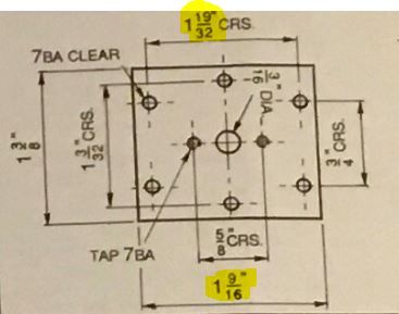

                Howard. I think Ramon's comment was based on the fact we have been saying to make the piston rod and conrod length to suit what has been built for the last 3 pages of this thread.
                The discussion of drawing is to try and see where the error may have come from in the first place so that others can avoid the same problem..
                Even with the correction sheets I have found errors that they don't seem to cover, anyone able to make this to the sizes shown?

                  #526012
                    So far it's the only error that has jumped out at me having started to draw up the parts from the more recent drawings though I have yet to assemble it on screen.
                    Biggest problem will be deciding do I make it with parts as per Stuarts, make small alterations for what I would prefer to see or do a lot more extensive reworking. Either way I think I will stick with imperial as most builders buying a kit will be loath to put all the stock and fixings into the come in handy box. If Stuarts were able to offer a "castings only" it then that would be a different matter. I must say although I'm happy to work in both trying to sort these drawings out with all there fractions would have ben a lot easier if it were metric as it's easier to do a lot of it in your head.

                      Andy_C
                        @andy_c
                        Jason, the size shown on my set of drawings is very clear and reads 1 9/32 and 1 9/16 respectively referring to your highlighted dimensions.

                          David Caunt
                            @davidcaunt67674
                            Jason,
                            The 1/32" would hardly take the 7BA clearance holes. Not looking for anything else.

                                Andy, Br, David. The valve chest cover drawing is correct on the older version being 1 9/32" rather than 1 19/32" which allows the holes to be drilled within the plate rather than outside it!

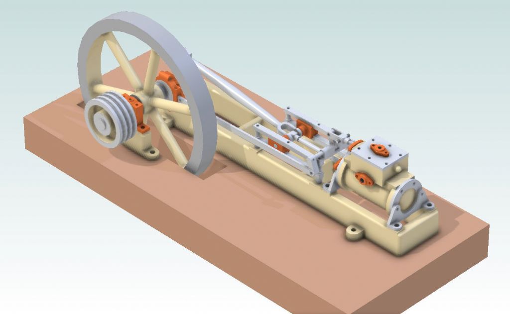

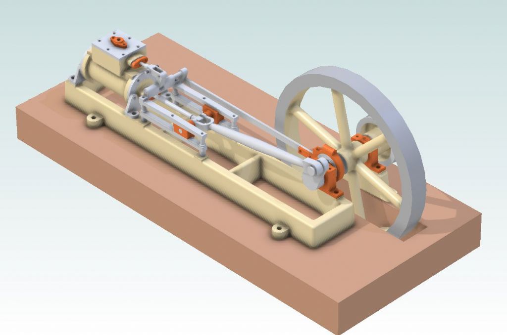

                                #528373
                                  Well thanks to a very generous forum member I have been able to get my grubby little mitts on a set of Victoria castings and model it in 3D using Alibre. I'll post a few dimensioned drawings of the base, conrod and piston rod assembly in the next few days as that is what this thread is concerned with then post some more once the new forum software is up and running. here is a little of what's to come.
                                  #535254
                                    Well I decided to prove my drawings before posting and as the Change in software is imminent will probably hold off until then.
                                    Looking at the dates on my photos I first started on the main bed casting on 26th of Feb and today had enough done to see if the engine ran. There was some work already done but I have reworked quite a bit and also had to make a few missing bits from scratch so probably a similar amount of work to starting with a virgin kit.
                                    In the video it is just running as a quick trial so no rings, gland packing or gaskets and the outrigger bearing is not held down so it starts to move about a bit at speed and knock but who wants to run them like that anyway when a slow tickover is as nice to watch as any clock or pendulum.

                                                #539189
                                                  Well I had a change of plan on the colour as the cream I had thought of using is no longer available so found a tin of something suitable in the back of a draw and sprayed that on then stuck it on a base.
                                                  The eagle eyed will see that I have added a bit of extra detail to the cylinder and valve chest as well as getting rid of the bolt together eccentric rod, apart from that it's fairly stock except for the corrected dimensions which will hopefully follow soon.
