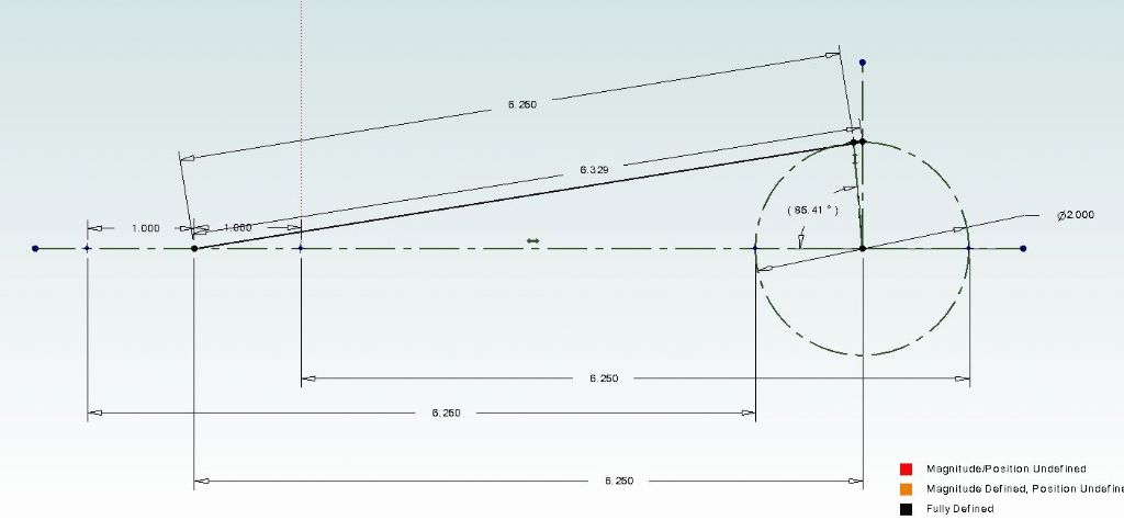

      This may help Bill
      I have used the 6.25" conrod length, you can see that if a line of that length is drawn from the middle of the guides it the circle described by the crank pin it will be at about the twenty to eleven o'clock position not noon

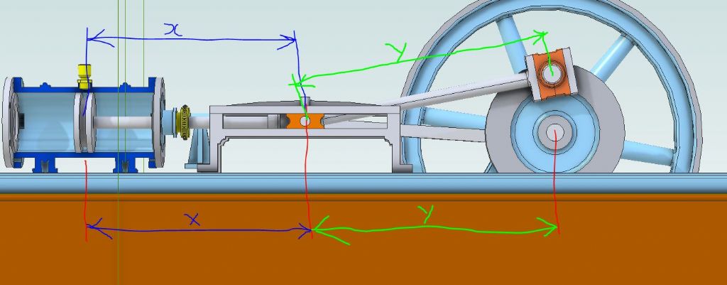

        I think we are both saying the same thing Ramon, just different thoughts on the order.
        Here is another image of a similar style engine. If Arthur mounts up the cylinder, guide bars and bearing block then the two dimensions X and Y shown at the bottom can be taken from what has been built and ignoring the drawings from now on. X being ctr of cylinder to ctr of guides and Y being ctr of guides to ctr of crankshaft
        Then it is just a case of making the distance between the conrod holes equal Y and the distance from crosshead pin to middle of the piston when both are assembled onto the piston rod equal X

          I stand corrected Jason blush I'll be honest – I had to draw it out myself but yes it is 85* not 90* as I thought it would be.
          It isn't vertical that's for sure!
            Yes that's exactly what Ive been meaning Jasonthumbs up
            The differing dimensions from varying sources are one issue – solving the problem on a built engine is potentially another.
            One thing is for sure whoever has intentions of building a Victoria from current castings needs to be certain to check all drawing dimensions before machining anything. I'm afraid to say at the cost they now are I won't be joining the queuewink

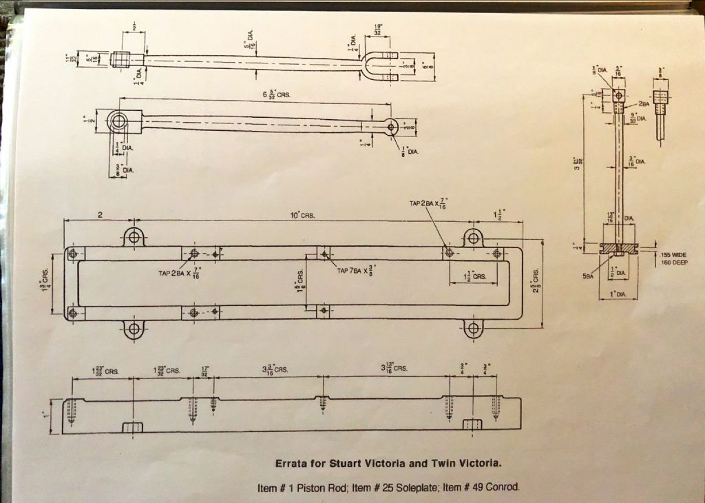

                  Bought a set of single victoria plans and castings in 2017 (at Great Dorset steam fair – happy days). The plans came with an errata sheet which shows a number of changed dimensions on sole plate, piston and con rod. Con rod for example shows 6 5/32 between centres. Not built yet unfortunately but following this thread with interest.
                  Edited By Andy_C on 07/02/2021 16:12:00

                          Victoria errata.

                                Spoke to Stuarts this morning and they confirmed I should have had the errata sheet in with my kit and the con rod crnters ate correct at 6 and 5/32.
                                Also the piston rod lenght at 3 and 1/32 from x head center to back of piston.
                                The one good thing to come out of it was he iffered to replace the con rod material and also waived the p&p.
                                Thanks to all for your input. My next post hopefully will be a working engine.

                                          Arthur, don’t miss the dimension changes on the sole plate which are consistent with those of con rod and piston rod.

                                            I think Ramon and myself feel the soleplate can stay as is but the new conrod should be made to a dimension taken from the work that has been done so far.
                                            As I said earlier measure from centre of the guide bars to centre of the crankshaft and make this the length of the conrod for THIS ENGINE. I might suggest cutting a bit of stiff card and making suitable holes in it as a test conrod to double check things are lining up OK before you cut into the replacement metal, crosshead should move 1" either side of guide bar ctr when crank is at TDC and BDC
