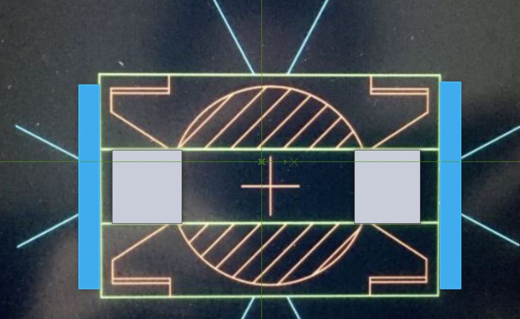

                                        Hoping to make a start on the cylinders today – at least cleaning them up ready for attaching their feet.
                                        The article says use 1/2” x 1/2” steel for them, which I’ve bought. Unfortunately, while I got more than enough for four lengths, I effectively need six, because I want to try using the three strips soldered together method for boring the arcs.
                                        Any ideas how to get around this, or just buy more steel?
                                        Thanks.
                                        #550409
                                          You don't need a full strip in the middle so short bits will do or anything that could be cut to 1/2" long.
                                          Don't forget to poke some fuse wire down the cast steam passages as they are often still full of core sand and you don't want to go spreading that over your machines
                                          #550440
                                          Dr_GMJN
                                            @dr_gmjn
                                            Thanks Jason. I’m not sure if I’ve misunderstood the concept – the image in the article is just a blur.
                                            I assume the strips are arranged like this:
                                            and you bore the assembly until it’s like this:
                                            and you’re suggesting something like this, which will have intermittent cuts?
                                            With either of these it seems like there’s only a small amount of material to withstand the clamp force from the Chuck? Is it likely to be an issue?
                                            Thanks.
                                            #550442
                                              That's it. The intermittant cut should not be an issue and if you had the "spacers" a little closer together in your sketch then the final cuts will be constant.
                                              A loose packer at either end will spread the load rather than push against the central soldered in packers, infacct arranged that way you could use superglue rather than solder as then it is only a case of stopping the bits sliding about when initially clamping.

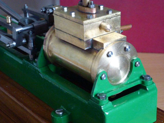

                                                      So on to the cylinders – I needed to clean them up to get an idea of the diameter to machine into the modified feet blocks.
                                                      I actually have three – one was damaged when I got it; looked like whatever was used to separate it from its runner might have cut into the valve face:
                                                      There isn’t much machining allowance on there, so I sent a photo to Stuart Models who immediately sent another (excellent service). The intention is to use the damaged one for a machining test run, so I bodged some JB Weld into the cuts:
                                                      I cleaned the other two up, initially with a wire brush:
                                                      and removed the drain cock pads with a file, in preparation for fitting the feet:
                                                      But then I noticed quite a bit of scaling on the surface, which wouldn’t come off:
                                                      The file just skated off it, so I resorted to a grinding bit in the Dremel:
                                                      Which seemed to do the trick, but there’s still a lot to remove. It’s worse on one casting than the other two. I wonder if putting them in the fire made it worse. I’m thinking of trying to remove it from the cylinder bore as well, before machining. I now understand What all the fuss is about regarding casting skins, and them ruining tools. There was none on the 10V.
                                                      Also began poking the steam ports with wire to remove any residual mould sand – again, one was much worse than the other:
                                                      So current status is two are about 50% fettled, still waiting for the JB weld to set on the other:
                                                      BTW the nominal diameter seems to be about 33.5mm, so I’ll machine the feet to 34 and hope for the best; the JB Weld should make up the rest.
                                                      This all took longer than I thought, so the feet will have to wait for a few more days…
