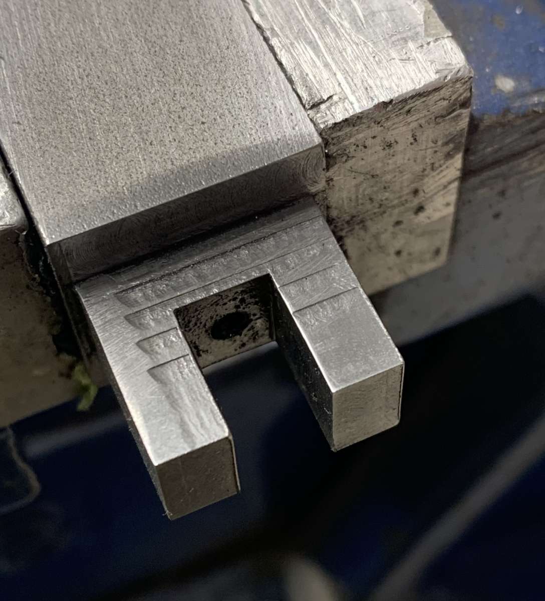

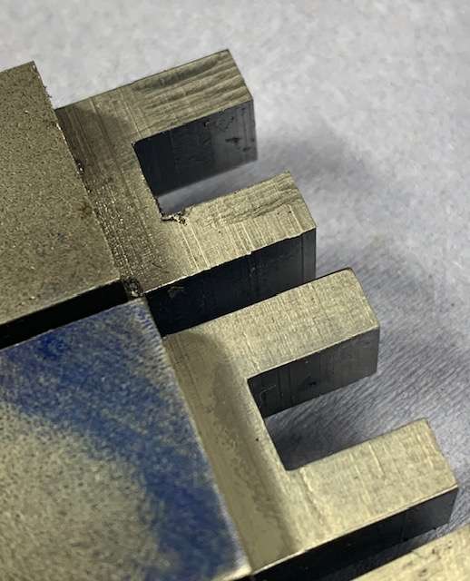

      So now the weather is much better, I’ve re-started this one. In the end I decided to re-make the forks, mainly to get into using the equipment again.
      I’ve immediately run into the the same old issue with milling – poor surface finish. I set the 20 mm square steel stock in the vice and milled the top and sides, then the slot as per last time. The probelm is I’ve ended up with chatter on the short sides, which will still be visible once the ends are rounded off.
      I’m using a new slot drill and then tried an end mill. I’m setting the x and y dimensions and incrementing down about 1 mm at a time to a total depth of 15 mm. The first one turned out pretty well. But the next two are hopeless. I thought the issue was taking final sized cuts all the way down, so I tried incrementing down, then across in 0.01 mm steps for the final full-flank cuts, to no avail. Exacty the same result. Interestingly, it’s worse on the short edges, not too bad on the wide sides. Unfortunately this is no use to me since those good faces will be turned down to form bosses in the lathe. The slot was milled last, after the chatter appeared, so it’s not like the reduction in workpiece stiffness was to blame.
      IMG_6855
      IMG_6853
      IMG_6851
      I’ve had this kind of issue since day one when machining steel, and have asked about it before several times. I’ve tried all kinds of adjustments, locking axes, feeds, speeds, tools, but it always seems to end up like this at some point (or worse). I can’t put up with it much more, it’s just causing me huge frustration and eating my limited free time.
      Thanks!

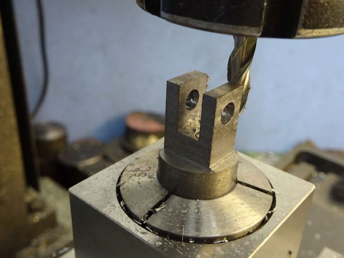

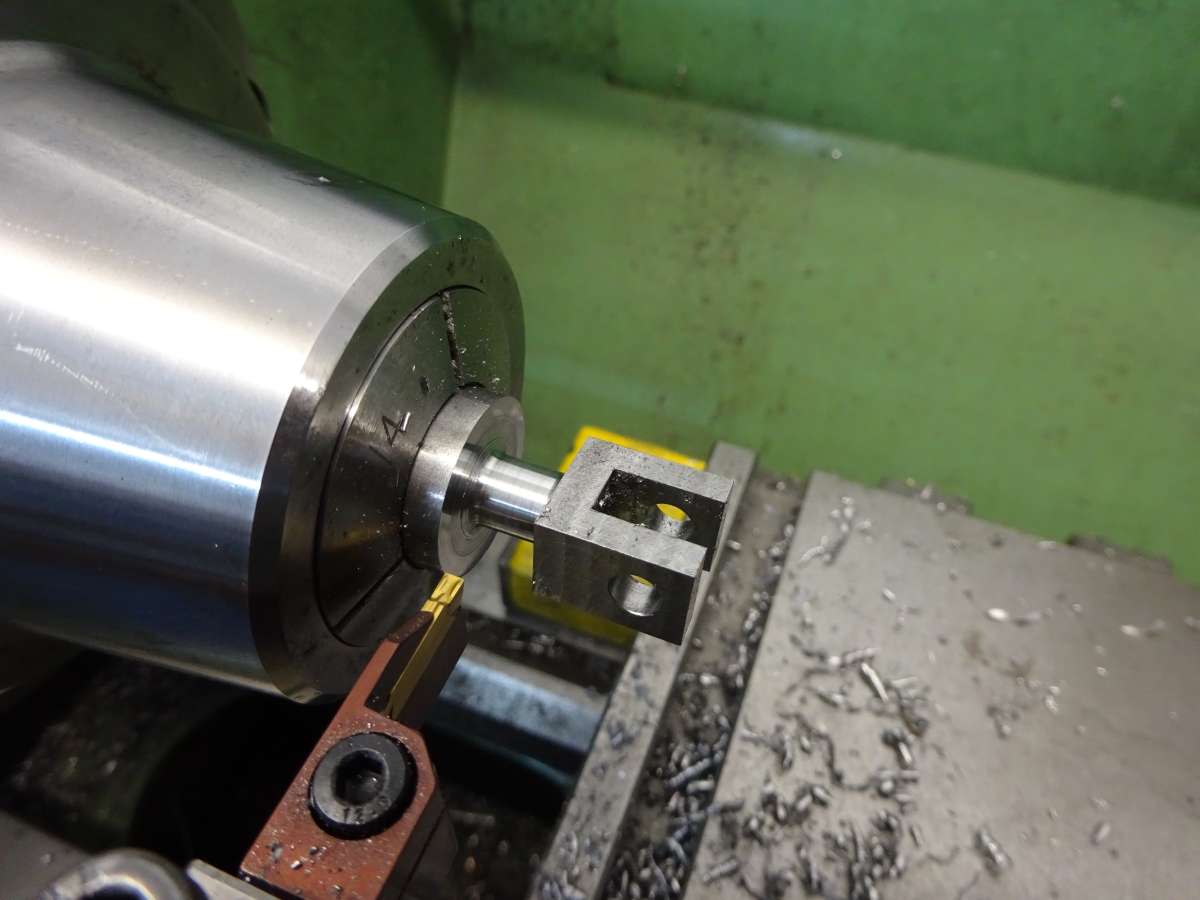

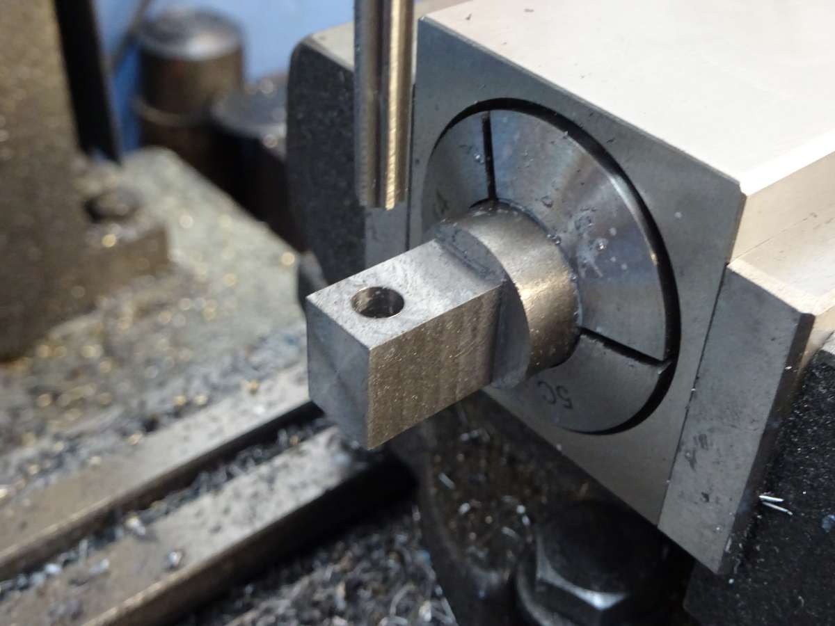

        Consider doing it with the parts laid flat as you have them in the photo. use a vice stop so you can maintain position as you change their position in the lathe.
        Would be worth trying similar cuts as you did but with the orientation 90deg and see if you get chatter on the long sides which would indicate a problem in one axis.
        Detail of feeds and speeds would help. If doing them vertically as you have then I would be coming down in steps of 5mm – 6mm rather than 1mm and stepping over say 1mm, finish full depth at 0.1 to 0.2
        Similar item done horizontally in a collet block but vice would do
        photo 36
        Photo 37
        Photo 38
        Photo 39

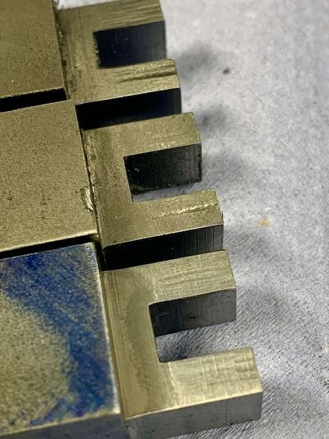

            So to be clear, this was the orientation last time. It actually grabbed and took a chunk out of my vice which really pi**ed me off:
            Short side:
            IMG_6856
            And this was the orientation this time (Long side had the error, although this is actually the one side visible that wasn’t too bad):
            IMG_6833

                      What you are calling chatter looks like dwell machining to me. This happens when a flexible set up (they are all flexible to some extent) is allowed to dwell too long in the middle of a cut so the cutter has time to do spring cuts in one location only. The result looks just like what you have there. This is problem with manually feeding and the slower you try to feed the easier it is to have these problems.

                        Thanks Martin. Could be that. I try to be as smooth as possible using the wheels. I also go back and forth after the first cut. *final cut*
                        Strange how I use the same technique and some faces are fine, others are terrible.

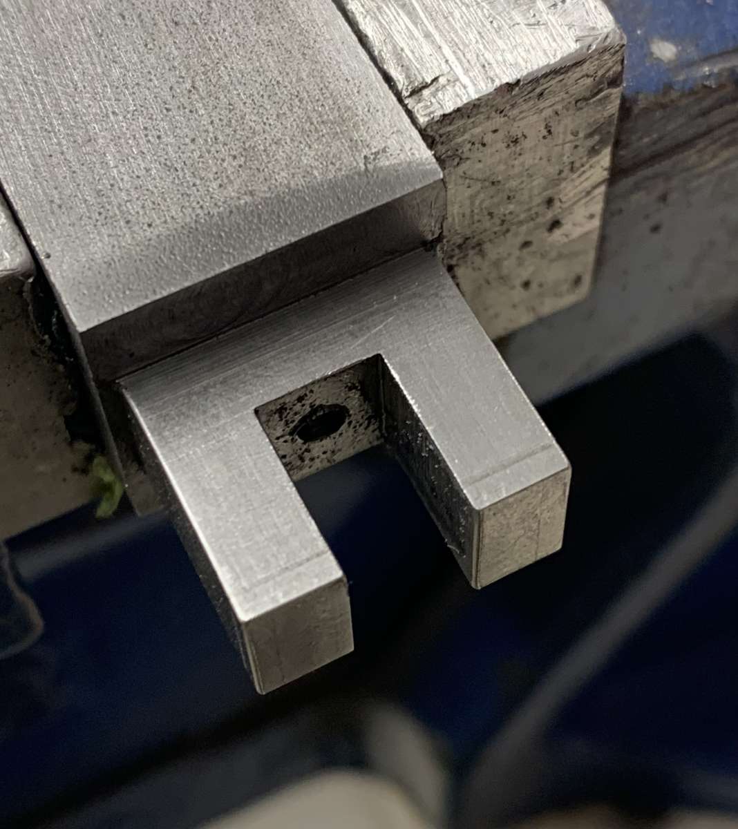

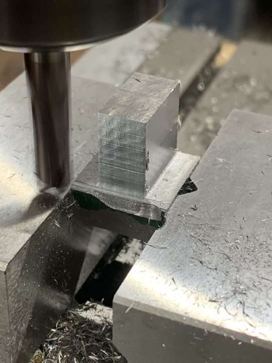

                                    I found I’d got one bit of steel left, so had another go using smaller cuts, and using two 0.01mm finishing cuts to get to size.
                                    I also turned the work so that the previously problematic y-axis faces would be the ones that would be subsequently turned down for the bosses.
                                    This time, the y-axis faces were fine, and one of the x-axis faces:
                                    IMG_6881
                                    But now the opposite face – using exactly the same cuts and conventional milling, looked like this:
                                    IMG_6880
                                    These were the faces on the x-axis which were fine last time.
                                    Much as I hate to compromise, I then face milled the gouges away, and have obviously ended up with slightly undersized parts (about 0.005”).
                                    This is the fifth sixth attempt at these, and I think if I have to do them again due to some knock-on effect of this screw up, I’ll pack the model up and call it a day. It’s just not fun any more.
                                    I need a much better quality milling machine, because this thing is driving me crazy – I seem to spend as much time fighting a losing battle either trying to adjust it, or correcting errors caused by it.

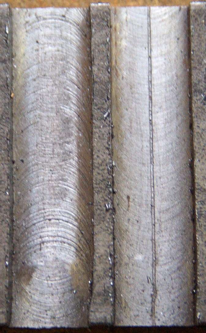

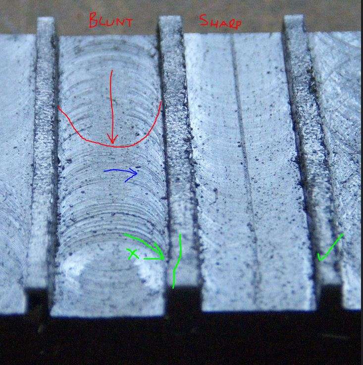

                                              regarding the marks in the last photo, this image may go some way to illustration how the cutter has been pulled into the material.
                                              On the left is a pass taken with a 4 flute cutter that was past it’s best. The green arrow indicates where it stopped being pulled sideways as the middle of the cutter exited the cut just leaving the last bit cut as it should be. Cutter moving in the direction of the red arrow and being deflected in the opposite direction to rotation shown in blue. This is the same sort of thing you get if you use a 4 flute cutter instead of a 2 flute to cut a slot.
                                              Pass on right exactly the same cutter and setup but after cutter had had it’s end sharpened.
                                              What your image shows is a series of such deflections as you have stepped down the job. Check it has not got blunt, particularly the  corners.
                                              blunt
                                              Same cut from above that shows the deflection along most of the length and also the much more pronounced rings left on the bottom of the cut where the cutter is riding on the surface compared to the right where it is actually cutting.
                                              1D

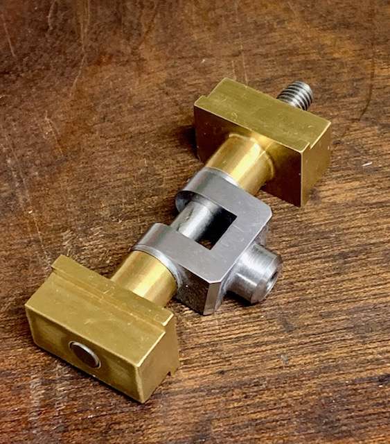

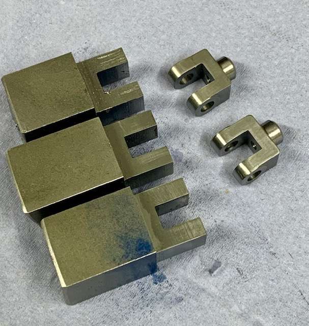

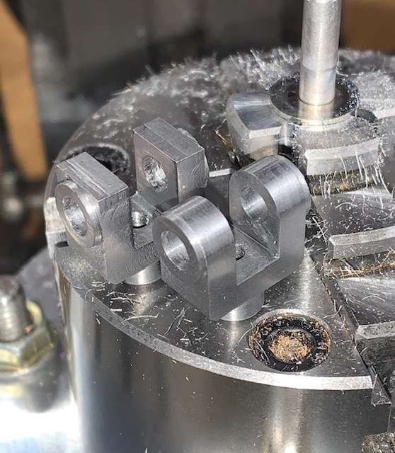

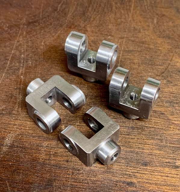

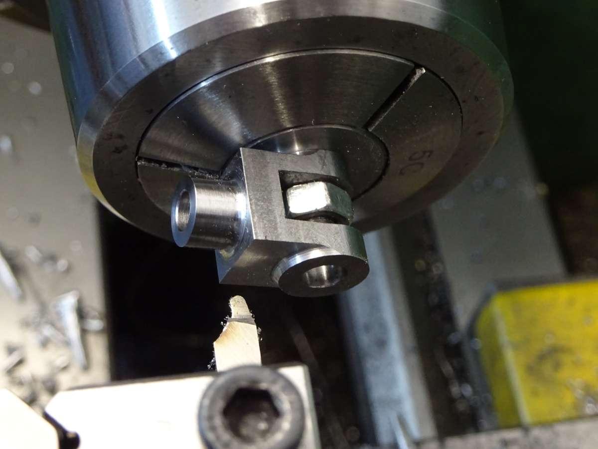

                                                    I trudged on with the forks and accepted that they will never be perfect. I turned the bosses and collar in the lathe. No point posting pictures becasue I’m just repeating what I did before.
                                                    Today I rounded the ends in the R/T (last time I used filing buttons, but wanted to get back into the swing of things, so did it a more elaborate way):
                                                    IMG_7207
                                                    Here they are compared with the too narrow versions I’d made previously:
                                                    IMG_7209
                                                    IMG_7212
                                                    So now I’m pretty much back to where I was almost a year ago – about to pin the crosshead shaft to the forks. I’d already bought the pins and taper reamer:
                                                    IMG_7211

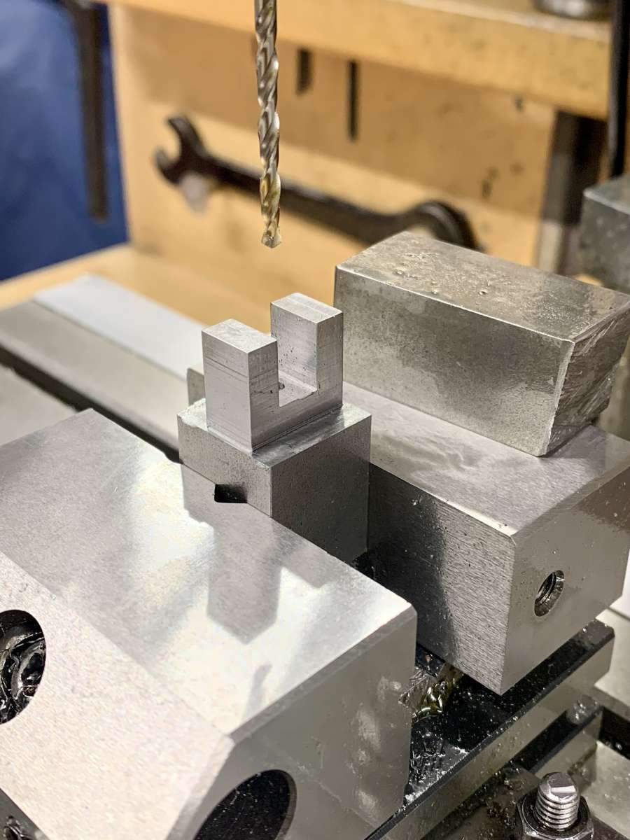

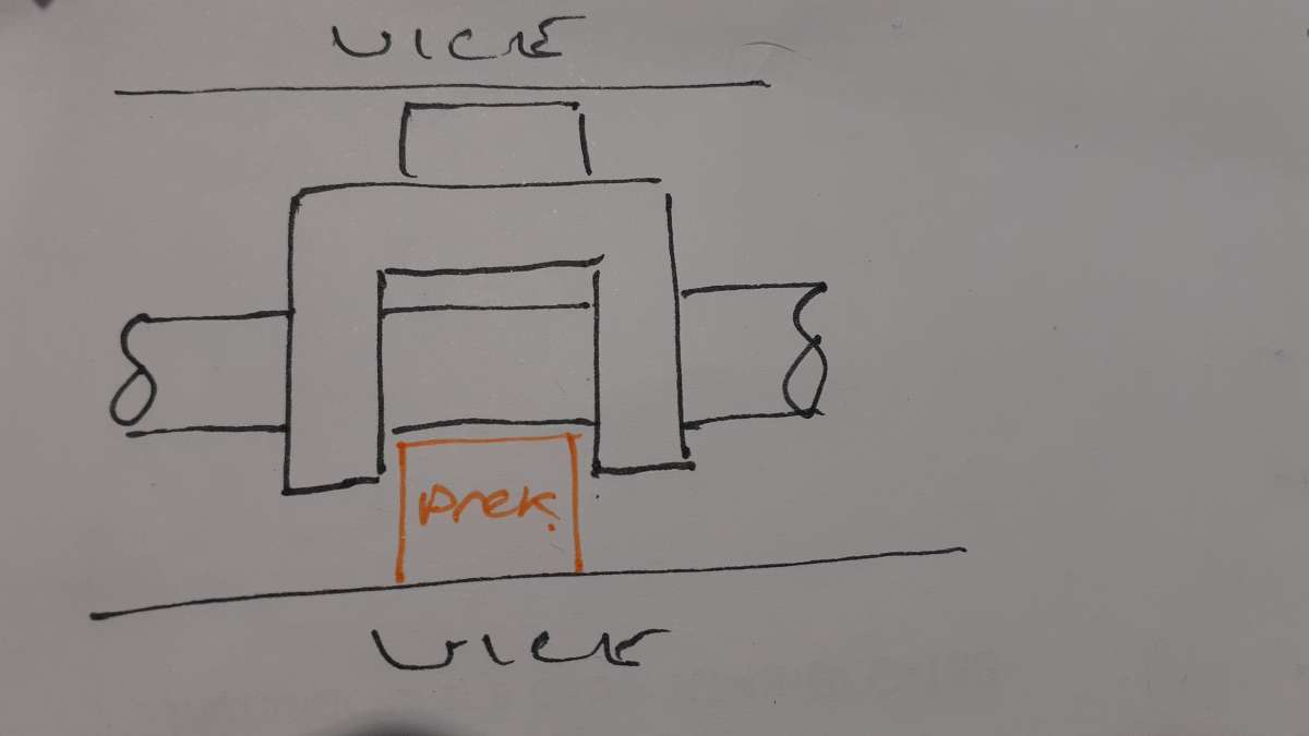

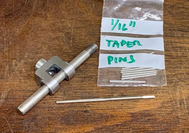

                                                    I need to figure out how to hold everything in the mill for drilling the hole for the reamer, and hope that the drill(s) don”t break when the hit the fork/shaft interface. Any advice on setup & precedure for this whole thing much appreciated! I think Jason you mentioned drilling two diameters of hole before using the reamer?
                                                    Thanks!
                                                    #735152
                                                      For the small pins like that I do tend to drill stepped holes. Measure a little way up from the small end of the pin and again about half the fork thickness from that and size your drilled holes to suit. Take it very easy with the reamer as they are slender but there will be a lot of flute engagement. Remove often to clear the swarf always making sure to turn clockwise, use cutting fluid
                                                      A small piece of aluminium packing against the pin will allow it to be held in the vice without the pin moving
