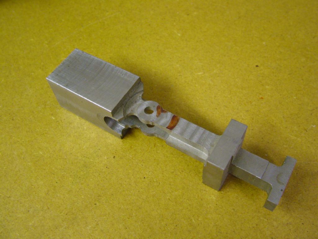

            Doc if you follow the links I posted at the bottom of the previous page to the Real in particular and James Coombes you will see that I don't use a carrier, I mark with a Sharpie.
            The three facets that I show is more than adequate for these small rods and the angles involved See the other thread linked to
            To save upsetting the tailstock I sometimes use my boring head to offset for the tapers but as they are not that long and you will end up hand finishing then the topslide is fine and it's what I used on the Real which is exactly the same as the Victoria part
            You will also see that I have excess material at each end that can be used to clamp a drive dog to or simply hold in a chuck so no risk of marking a finished surface or having ctr holes where you don't want them

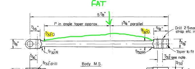

                  Oh I just looked at the PR drawings and it is not a fish belly that is fatter in the middle as the diameters at each end are different, and it'd not forked at the end like the Victoria.
                  Bending the stock by rigidly holding the big end and offsetting the small end and then using the carriage power feed will give the classic taper or "entasis" but again by just turning a taper just over half way along and then blending with the file will give a very close representation. See the short leg of the "tee" shaped one on the James Coombes
                  #652072
                  Dr_GMJN
                    @dr_gmjn
                    Thanks Jason. The PR drawings call for a 5/32" radius at each end (about 3.97mm).
                    Yes, the drawings show a straight-taper rod, but I would like to change this to a fish bellied type, as per Ramon's model.

                                #652313
                                  Its a case of playing with the hand wheels to avoid cutting into the rectangle as you feed in. In practice you start a little away from the shoulder feed in then move to the shoulder and then along the taper.
                                  Different diameters on the Princess royal drawing due to him using a chunkier big end. To get the look of entasis just blend the parallel section with the 1deg taper which is the preferable "look". To do a fish belly if that is what you want make the fat part where I have indicated otherwise the rod may look a bit spindly where it joins the big end
                                  #652387
                                  Dr_GMJN
                                    @dr_gmjn
                                    OK this is the best compromise I can make for a symmetrical fish-bellied rod. No blend filing shown. It's a 3 degree overall taper at each end (topslide set to 1.5 degrees).
                                    It doesn't look terrible, but overall think I'll abandon that and stick with what's in the plan. It's just that the plan version seemed such a subtle shape that it didn't suggest any real strength benefit over a straight rod.

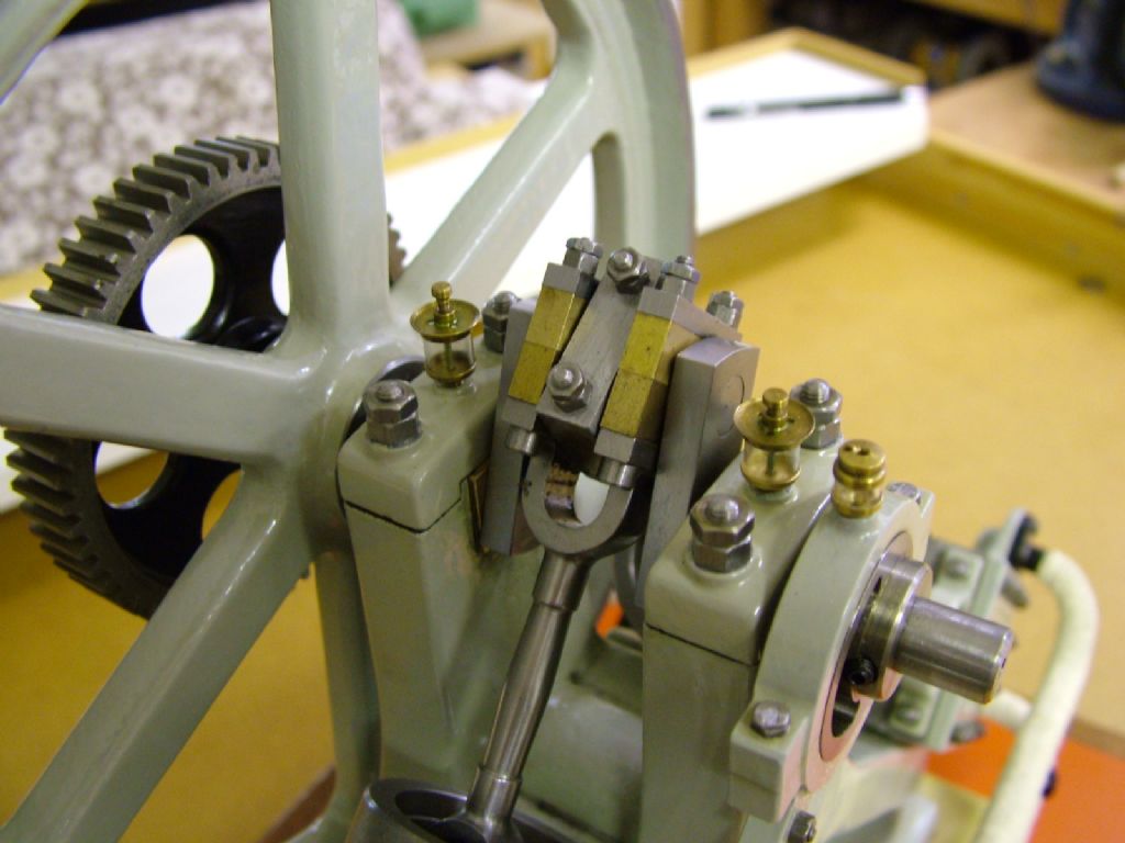

                                      Got the taper pins and reamer. Then, while figuring out how to hold the forks and shaft for drilling, found an issue: For some reason years ago I changed the four hole offsets for the slide bars to be further out. I think I might have done this becasue as drawn, the round mounting pillars overhang the inner base walls a bit, and moving the holes makes them look much better.
                                      The result of this is that the overall width of the fork and brass block assemblies needed adjusting by the same amount (about 0.9mm per side). This, I didn't do:
                                      I don't want to offest the sliders, becasue the mounting nuts wouldn't be central.
                                      I could make spacers to pack out the brass sliders, 0.9 mm wide. Since I can't find any images of a real engine having shims or spacers, I'm not really happy to do that.
                                      Seems the only remaining options are:
                                      1) Add (solder or screw) 1mm thick face plates to the outer faces of the brass blocks and re-machine them to match the existing block thicknesses (difficult to set up to make everything square again I guess). Would also require significantly wider slide bars.
                                      2) Solder bosses to the forks (probably look rubbish due to the imperfect concentricity of the turned bosses to the end radii).
                                      3) Make 4 new brass blocks.
                                      4) Make 2 new forks.
                                      I'm erring towards re-making the forks, since as I mentioned before, more substantial bosses would look much better, and I could mill them at the same time as the end radii using the R/T.
                                      All this is a direct result of the fragmented timeline of building this model; I'd forgotten to note it on the slider drawings when I modified the base drawings.
                                      I've got a day off on Monday, so hopefully I can get the new parts made.

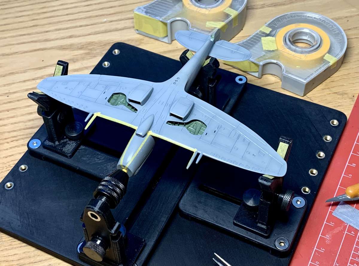

                                                Ramon, no Peterborough is a bit too far from Sheffield. Next IPMS show for me is Leeds at the Royal Armouries in February.
                                                I am on with a 1:72 Spitfire at the moment (started as a Christmas project on 2022!). I also decided to make a model building stand – own design, 3D printed. I was a bit skeptical about them, but since finishing it on Sunday, I’ve used it a lot:

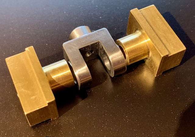

                                                  Despite it being pretty cold in the garage, I’m getting itchy fingers again to progress with this one. Too much plastic modelling recently, and it’s bad to get demoralised by daft setbacks like this was.

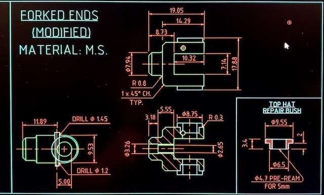

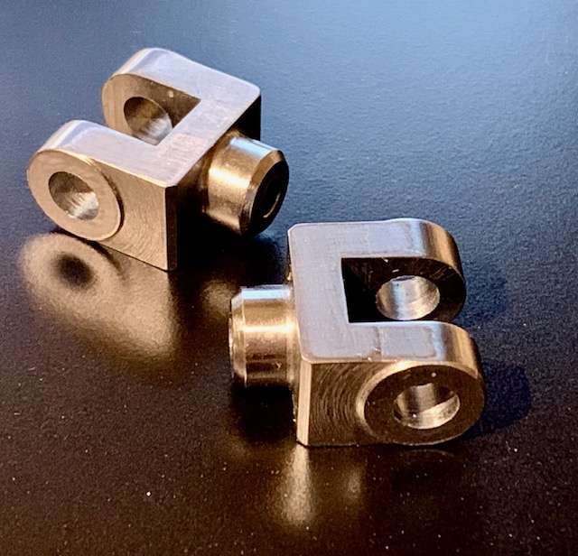

                                                  Briefly, I’d previously slightly modified the spacing between the crosshead slides, but forgot to widen the forks to suit. Result is a gap between the brasssliders and the forks, approx 1 mm per side:
                                                  IMG_5180

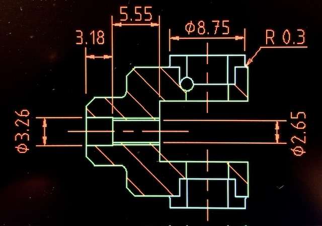

                                                  Further to Ramon’s suggestion of rescuing the too narrow forked ends with top-hat bushes, I drew up this today.
                                                  The idea is to make 4 bushes. The stub diameter is 6.5mm since I have a 6.5mm slot drill.
                                                  I would set up each fork on an expanding mandrel/bolt in a collet so that one side of the fork is held concentric, then use a slot drill in the tailstock to bore a locating hole in the outer fork. I’d eventually repeat this on all four prongs – obviously I’d need two diameters of mandrel.
                                                  I’d then make 4 top-hat bushes, with their flanges oversized. I’d make these a tight press-fit into the forks, and solder them in place.
                                                  Then I’d use a lathe tool with a 0.3mm tip radius to machine the flanges to match the adjoining brass slider boss diameters.
                                                  I’d re-ream them to 5mm sequentially, so that once one fork prong was bushed, the opposite existing, unmodified, 5mm hole would guide the reamer into the opposite repair bush which had been drilled to pre-ream size. Then repeat when the opposite bush was fitted.
                                                  Then I’d face the new bushes to the correct width.
                                                  Hopefully the joint would not be too visible.
                                                  Any thoughts? Should I just start again, re-make the forks and be done with it? Re-make the brass sliders with extended bosses? I’m not fussed either way at this stage, so long as it’s right in the end.

                                                  #707174
                                                  Ramon Wilson
                                                    @ramonwilson3
                                                    Hello doc, Happy New Year to you.
                                                    I missed your last post – looks like were are in the same situation – Leeds is to far for me too – one day somewhere else perhaps?
                                                    Re the forks – it will be much quicker to make and fit the bushes which will save the forks. I would use Loctite personally but soldering would do too – a solder witness will go black after a time though. If they don’t end up satisfactory then time lost before making new ones is minimal
                                                    As you are going to bore each side out independently I would make the bushes so that they can be re-drilled and reamed in line after they are firmly in place to ensure all is in line.
                                                    My workshop renovation is near complete so I am back on the plastic this week currently a Revell 1/32 He 219 night fighter.
                                                    I like your build stand 👍 – mine are much more basic using contiboard and balsa wood 🙄
                                                    Best – R
                                                    #707286
                                                    Dr_GMJN
                                                      @dr_gmjn
                                                      Thanks Ramon. I will use Loctite and see how it goes.
