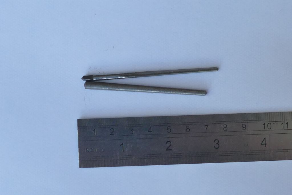

                      Do some practice ones first, at that size the reamers are very delicate and there is a lot of engagement.
                      Hold the pin against the job and measure the diameter where it will exit and drill right through that size say it's 1.4mm, then go half way with a 1.5 so there is a minimum of material for the reamer to remove.
                      #651141
                      Martin Connelly
                        @martinconnelly55370
                        This is a taper reamer, size is 1/8" so it is 1:48 taper with the 1/8" being the larger end. The cutting length is about 2" so you can work out that the other end goes down to about 3/32". The pin is a 3/16" pin and goes from 3/16" to 1/8" so they do not match, I would need a smaller pin or a larger reamer depending on what I was going to be doing. The larger pin suits the existing taper pin holes on my lathe which is why I have it, the reamer was just the first one I picked up but thought the differences in sizes was important to point out. Not all taper reamers fit all pins, they have to be sized to each other. I hope this answers your question regarding where they can be used.
                        Taper reamer
                        Martin C

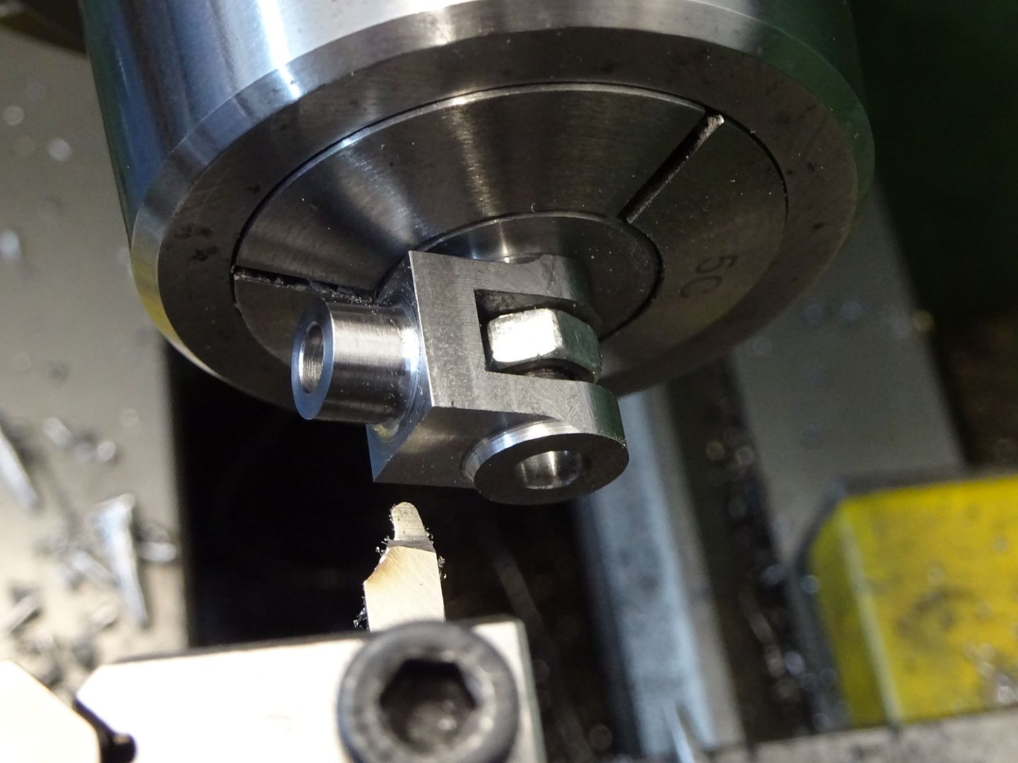

                              Drilled the counterbores on the fork bosses:
                              Also chamfered the bosses.
                              Then drilled the pin holes:
                              Turns out the pre-ream drill I used was too big, so the reamer didn’t cut anything. I measured the drill at 4.7 (same as I used for the brass sliders), but…anyway.
                              Made some filing buttons:
                              And filed the rounded ends:
                              Then chamfered the sides:
                              Progress so far:
                              I suppose I could hand ream the holes and brass blocks at 5mm, (which is about 0.009” more than 3/16&rdquo. I’ve already got a reamer and some 5mm stainless rod. Seems par for the course for me these days to end up correcting something, so no big deal.

                                        If you use a 5mm hand reamer that has a long tapered lead so should be OK to do it by hand and probably easier than trying to set up again under the mill spindle. Or you could put the parts into a vice that is free to move on the mill table which should allow it to self ctr.
                                        Doing the forks on the lathe would be easiest, stop just short of the rounded end and it won't show if you take too much. I'd probably just turn the end of a bar to 5mm, cut a short thread and fix part with a nut.

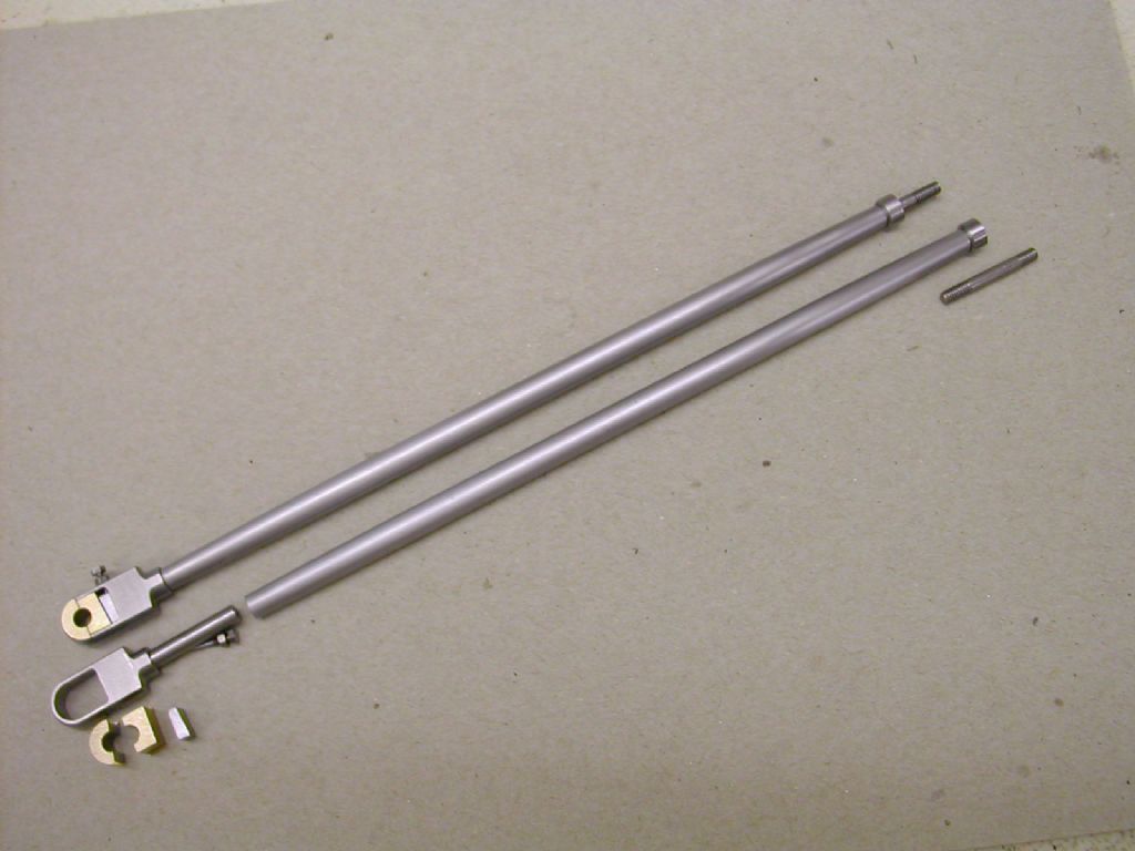

                                                  Hi Doc, I'm sure Jason will provide you with a good method to follow but for what it's worth I described making fish bellied rods on HMEM when making them for the Waller engine.
                                                  As you can see they are composite which makes for much easier machining – you can find the details here post #16 onwards (The description of making them is further on at the start of the second page of the thread)
                                                  Here's an image of the pair I made for my twin Vic using the same method. These ran at many shows over many years without showing any signs of their composite make up. The big end 'blade' was an integral part of the shaft.
