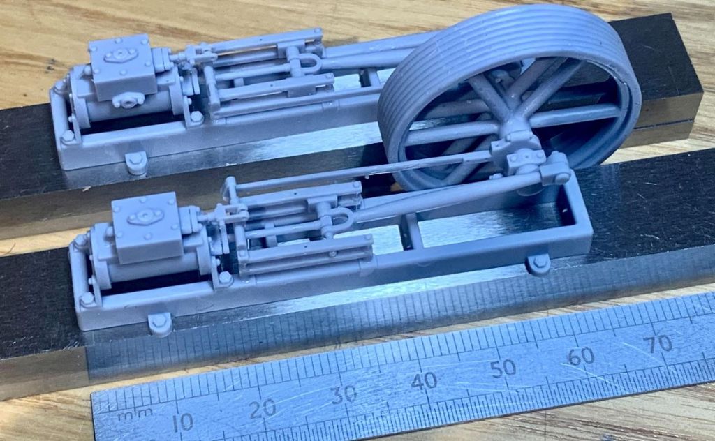

                      #641851
                      Dr_GMJN
                        @dr_gmjn
                        It’s finished!
                        Well, this 3D printed version is – it's approximately OO scale:
                        Jason B kindly gave me the CAD model he's done for his single-cylinder version, and I mirrored it and moved the crankshaft and linkages slightly to form a twin. Then printed a base and wrapped some brick paper around it for a bit of scale.
                        It's now in place inside a mill building on a work colleague's OO railway (with the flywheel powered by a geared motor and rubber belt).
                        Edited By Dr_GMJN on 18/04/2023 22:17:19
                        #641879
                          That looks good Doc, what made you change to the smooth faced flywheel?
                          #641887
                          Dr_GMJN
                            @dr_gmjn
                            Posted by JasonB on 19/04/2023 10:30:41:
                            Thanks Jason,
                            We ended up making it smooth because the grooves were tiny, and no reasonably sized band would fit. So I turned the grooves off on a mandrel, and formed a recess which both trued the wheel a bit, and made it more suitable for the drive belts that we had..

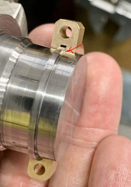

                            #648244
                            Dr_GMJN
                              @dr_gmjn
                              I wasn’t 100% happy with one of the eccentric strap profiles back in March, and I lost a bit of motivation to make another – they had taken a great deal of time and effort (even to get one slightly wrong!). Anyway, three months later I’ve finally made another, which is spot-on. Also added chamfers to the edges to neaten the bosses up. Just need spot-facing and drilling for the oilers, and they will both be done.
                              Strange how this one took less than a day, the previous ones took a week or more of messing about. Even considering not having to re-make the r/t fixture, I guess that shows the time it takes me to try and figures things out, plus chasing mistakes.
                              BTW – what oilers you folks put on these? I’m m thinking the plain brass oilers I put on the 10V main bearings might be OK, although presumably on a real engine e they’d be capped? Thanks.
                              #648462
                              Dr_GMJN
                                @dr_gmjn
                                Started on the eccentric sheaves. Turned down some mild steel to the locating ring diameter:
                                Marked out:
                                Then once machined to a perfect fit on the straps, cut it off and put in the chuck for facing and marking out for the eccentric offset. Padded the chuck jaws with paper to protect the bearing surfaces, and it immediately moved in the chuck, snapping the tool and trashing the part. Strange thing is I almost knew it was going to do that, but did it anyway. Very odd:
                                Second attempt:
                                Test fit:
                                The strap halves just lock onto the eccentric when tight, they need a slight gap between the joint faces:
                                I think this is right, so they can be adjusted for wear, and that’s why the strap caps have lock-nuts.
                                I’ll leave the sawing and chucking until tomorrow I think. I need to figure out a method of securely holding in the chuck without damaging them. Maybe an aluminium ring.
                                #648468
                                  Good to see some progress.
                                  Do make sure you have allowed for the slight radius on the tip, it may be a bit tight where the arrow is pointing as that is where I usually need to ease the two corners of the strap's groove
                                  #648477
                                  Dr_GMJN
                                    @dr_gmjn
                                    Posted by JasonB on 14/06/2023 06:56:22:
                                    Thanks Jason. What I did there was, once everything was to the correct diameter and width, I put the point of the tool in the corner, and fed in and along very slightly to form a tiny undercut, to get rid of any radius.
                                    by the way – I re-read your method, using a parting tool to form the diameters. I tried this, but couldn’t get the edge of the tool to cut along its length simultaneously. Moving side-to-side would help, but right next to the raised ring would have been slightly tapered. In the end I used r/h & l/h turning tools, which seemed to work ok.
                                    Edited By Dr_GMJN on 14/06/2023 08:45:24
                                    #648485
                                      My small parting tool probably has a "sharper" edge than your insert and also no corner radius on mine which makes it better for sideways use and sneaking up on final diameters.
