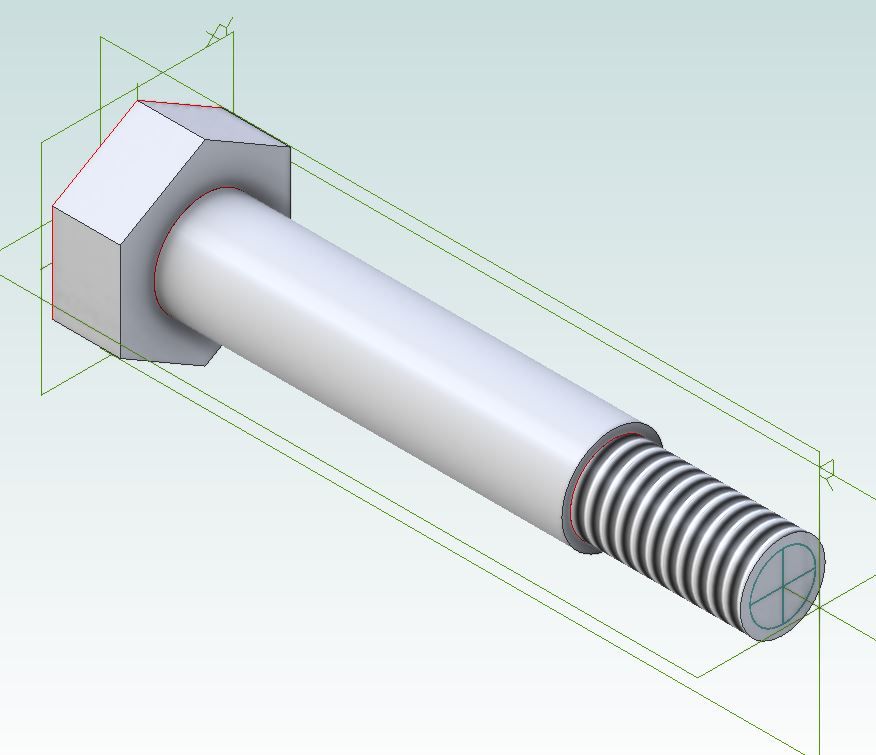

                  #638394
                    Don't be in such a rush to get a new casting. As you are going for fitted bolts you can make then to fit what is needed to get over the problem.
                    If you set up each half and plunge cut with a 3mm or 1/8" endmill in the correct position that will pull the hole back to where it should be. You then just make your fitted bolts with a 3mm or 1/8" shank and still put the 7BA thread on the end and size the head to your original hex A/F

                      Posted by JasonB on 20/03/2023 10:10:37:
                      Thanks Jason.
                      That was my Option 1) above, but I assumed that the potential issue with re-boring the holes after splitting would be a mis-match of the faces and/or sides (since the point of a fitted bolt is to maintain precise alignment)? Obviously the centre hole isn't a problem because it will be bored.
                      I was going to make the bolts similar to what you 've shown, but with a square head which will be a good fit against the milled flat.
                      I do have a new 3mm end mill. Since it is short, I'd have to bore each hole in turn, from the mating face.
                      The only way I could do this accurately I think is by using an x-axis stop for the vice, where the parts are pushed against it, clamped, and the hole bored with everything locked apart from the z-axis. I'd have to turn the lower halves 180 degrees to make sure any side-to-side mis-match was compensated for (I think that would work) Obviously the supporting parallel would be removed just before the cutter broke through. Does that sound feasible?

                            So I had a bit of time tonight, and tried the end mill and hard-stop method:
                            It seemed to work fine, with the holes moved in by 0.25mm. I'm thinking a 6BA thread and nuts might look better than 7BA – 6BA nuts fit pretty much perfectly on the footprint now:

                                Thanks Hopper. I think I'd like to try the fitted bolts – if nothing else it's another bit of machining to try.
                                I do already have a 1/8" reamer, so I wouldn't mind trying that. I've got a 3mm hole currently so it should be OK.
                                Is the best way of going about it to align the faces and one end face on a surface plate, temporarily bolt one side and then ream?

                                  That sounds like it would work. That is assuming you will bore the hole in the middle to fit the eccentric afterwards and not before.
                                  Yes might as well do the fitted bolts now you have solved the problem of the nut hanging over the edge etc.

                                      Got the main flat surfaces completed on both straps, and machined the holes. Everything lines up fine, and all but one of the holes look to be good quality (at least when assembled using a twist drill as a spigot). The remaining hole has a slight bulge, but it’s cylindrical over about 270 degrees so it should be ok at least in function. I don’t think the holes are worth reaming after all:
                                      I did notice a flaw in one of the halves, which I hadn’t picked up on before:
                                      I don’t think it will machine out at the diameter specified. Is there any way of filling it before machining that wouldn’t be too obvious when finished (I won’t be painting the straps?
                                      Anyway, next job is to make the four bolts from mild steel.
