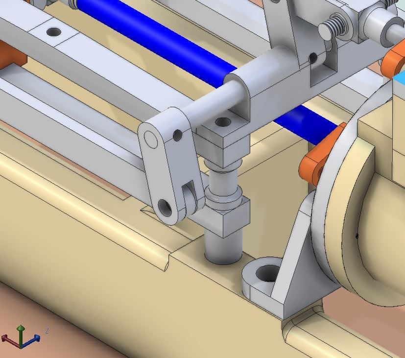

                                            Probably easiest to make the straps and rods the same and then sort out the slightly different offsets when you come to make the rocker arms and pin, a slightly longer pin on one engine would be the neatest way to do it.
                                            Not sure what your silver soldering is like but you may want to consider deviating from the brazed on fork to the ends of the rods and do them just as flat strips with a hole in the end and rounded over. You can then make the rocker arm 1/4" thick and put a slot in the end for the eccentric rod to go into. I've done that on the Victoria, Real and James Coombes as I really don't like the Stuart bolted together forked end to the eccentric rods
                                            rocker vic.jpg.

                                              OK thanks Jason. Yes, extending the shaft I think is the best option – that's what I meant by an offset on the operating lever. I think the original plans call for the crank in the bar to be screwed together? (I've not got the plans to hand right now). BTW I don't have any silver soldering kit yet.

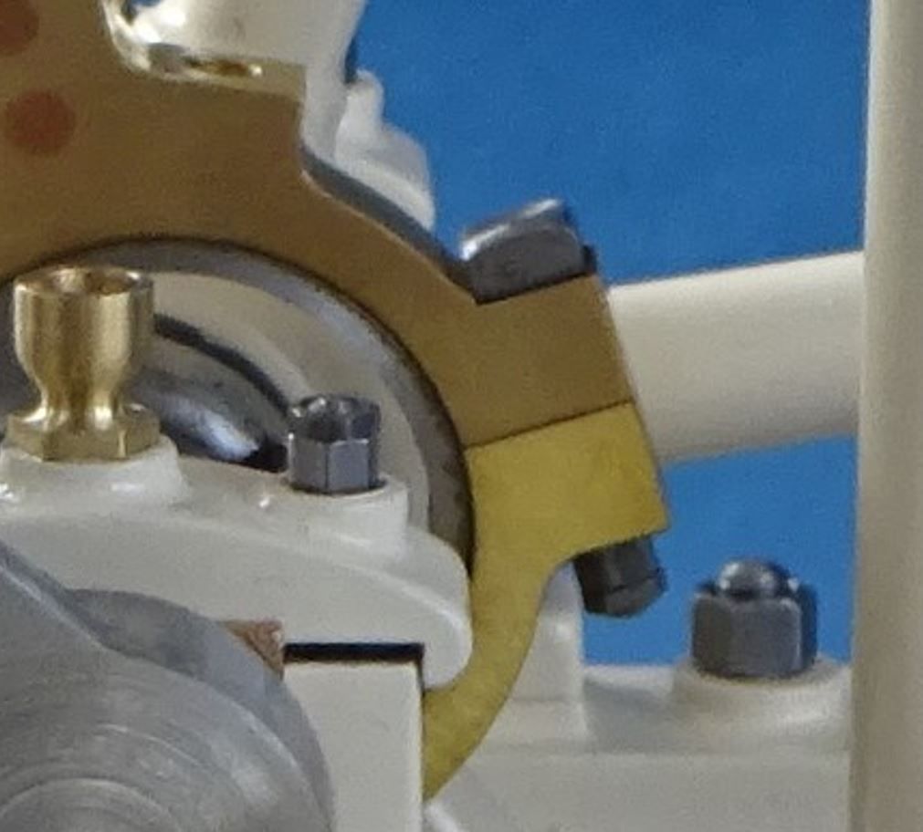

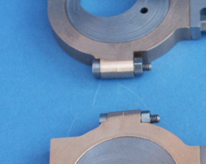

                                                Doc, I built the Victoria quite closely to the Stuart Dawings and with most of their castings and they show the strap tapped for bolts.
                                                Full size practice and on quite a few models is to have a good sized hole so we would ream if possible if not a good drilled hole will do. You should then make "fitted bolts" which have their shanks turned to a close fit in the holes. The head of the bolt is usually stopped from rotating be bearing up against a flat on the strap and then the two halves held together with nuts and lock nuts I have done this on several engines including the recent James Coombes II, sorry for the grainy photo is did not have a clear closeup of final assembly with the right bolts, also my Fowler's straps (locknuts still to go on).
                                                TC does show botls right through so you can use temporary ones while machining.

                                                  Right – so get some square or hex. Steel and turn the bolts to the drilled/reamed hole, then thread just the end?
                                                  Could I then get away without temporarily soldering the straps?
                                                  Thanks.
