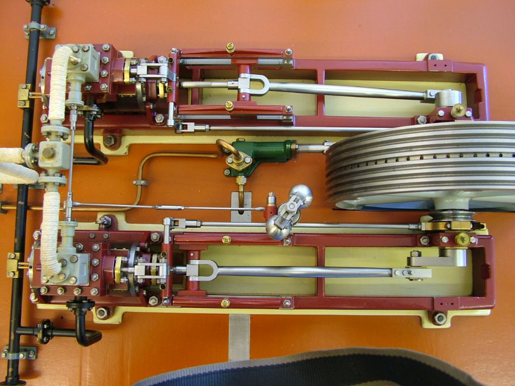

      That's a cracking image Jason, don't suppose you have one of the valve side too.
      I wasn't referring to the engine but the room floor area which though long appears quite narrow – some of the rooms that housed twin engines appear quite massive in area by comparison. Whilst there may be the odd one or so I can't recall any examples of wood floors in the larger rooms in any of the Watkin books I have but it's been quite a while since I was gleaning images for detail from those.
      As you are aware, I thought for a while that Doc was wanting to replicate a full size engine. As the intention is to build a nice model based on full size then it comes down to 'beauty is in the eye of the beholder' and I'm sure we will see just that at journeys end.
      Regards – R
      #617745
        Not one but two of the other sidesmiley click on them a couple of times and then the zoom tab comes up and you can see a lot of detail
        Edited By JasonB on 18/10/2022 18:09:15

            Ramon – the idea was/is to build the Proncess Royal version of the Twin Victoria, pretty much to the plans from the magazine. For a second model and with my limited experience I think it's about the right amount of scale detail; it was never going to be some kind of perfect replica.
            I'm all for trying to make a few minor embellishments like glass oilers etc, but I'm also fine with it being 'semi-scale', such as with the main bearings we discussed previously. I suppose that attitude might seem strange, but I think I'll be happy with it once it's complete.
            The parquet thing was just a whim, and since I've not seen it before on an engine model I thought I'd have a go. If it looks a bit naff I'll bin it and try something else – probably plain wood.
            BTW the very first thing I noticed at the Midlands show last Saturday was the Twin Victoria on the Stuart Moldels stand opposite the main entrance. I was surprised to see it fitted to two separate free-standing base blocks (at least I couldn't see that they were connected by anything other than the crankshaft).
