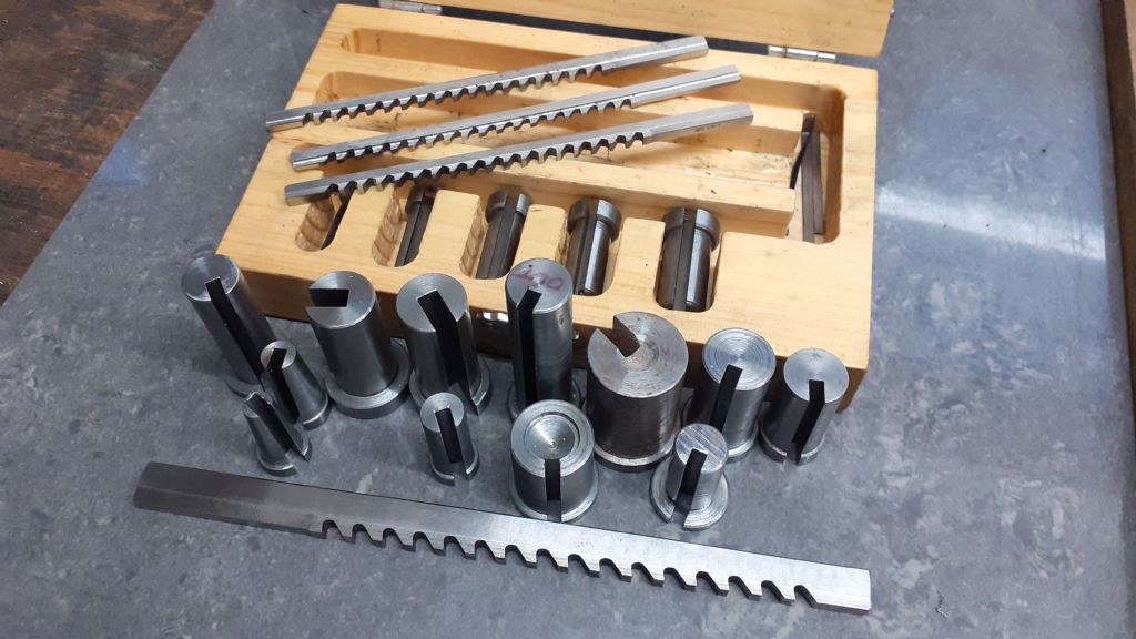

                                    I make no apologies for posting this image again – done on the lathe in a few minutes using a slotting head. Unfortunately it will not fit on an ML7 otherwise I would loan it to you.
                                    Good luck – R

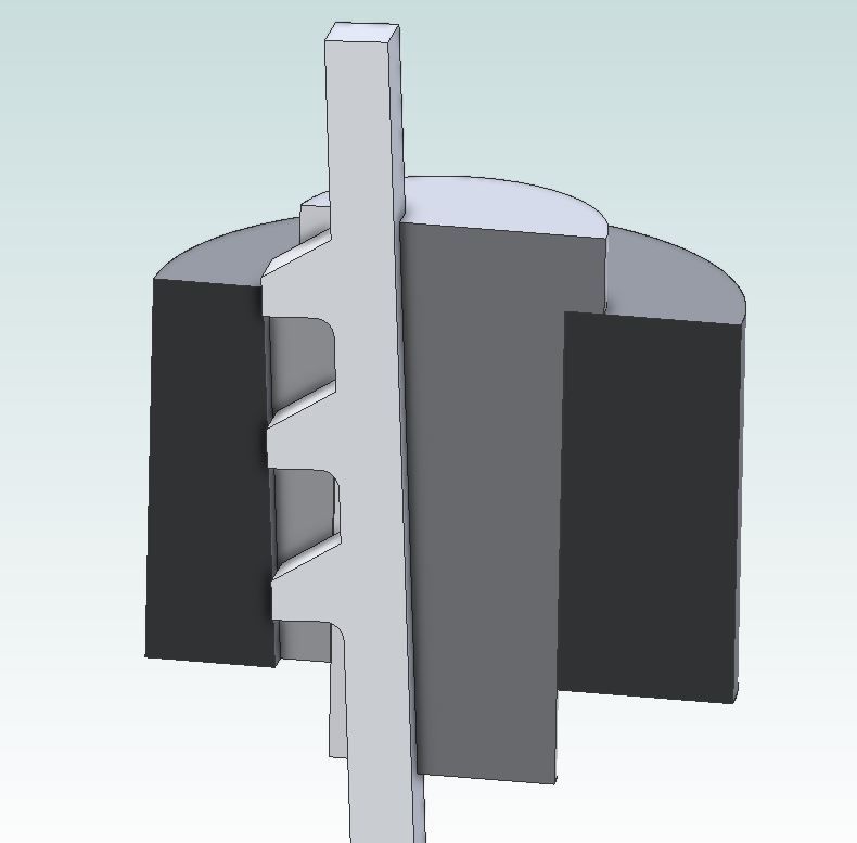

                                                In the mean time for Paul and the Doc I have drawn it up with exaggerated taper so it's easy to see. Broach just has a few equal height teeth but enough to give the idea as it's only the last tooth that really matters.
                                                Section with broach in place,

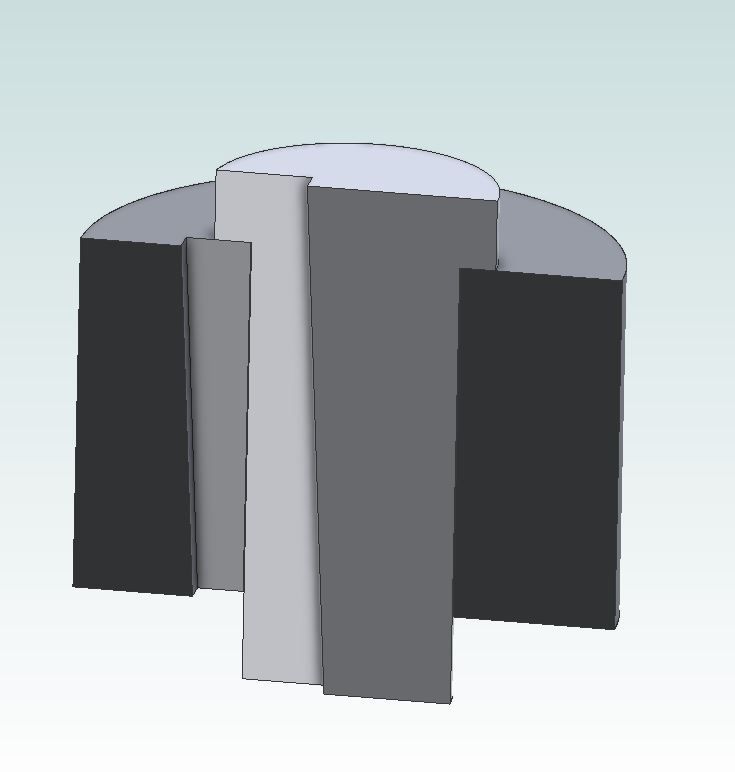

                                                Section with broach removed you can clearly see the tapered slot in the bush and the broach will cut parallel to that and therefore give a taper to the keyway in the hub

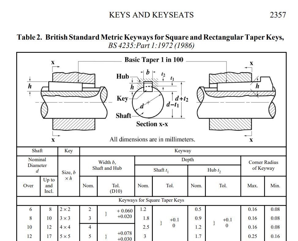

                                                This will give what is shown in Machenery's Handbook of matching tapered surfaces to key and hub keyway
                                                If you have a slotting attachment for a lathe then that can be mounted at an angle to do the same, if a slotting attachment for mill or doing it on a shaper then the work needs to be tilted so the cut is at an angle to the works central axis.

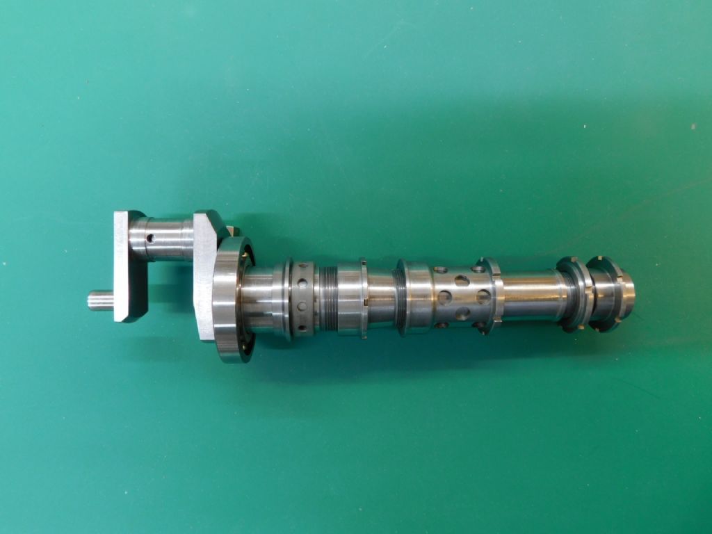

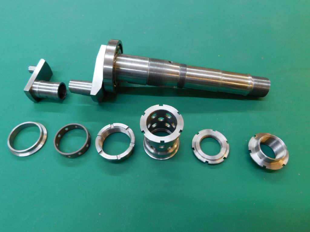

                                                  This extension to the Bentley crankshaft required a key to be absolutely accurate to ensure concentricity. The picture is rather dark but you can make out the slot inside the mating taper
                                                  This shows it in place, the hole is where the tool bit ran out to clear the swarf. The tapered area between the two parts roughly in the centre is also tapered with a key though it cant be seen. The key slot is at the same taper
                                                  The mating part is slotted at the same matching angle but the drive is off the side of the key not the taper itself
                                                  So on that note "you broach how you want to" laugh – I'll stick to what I know.
