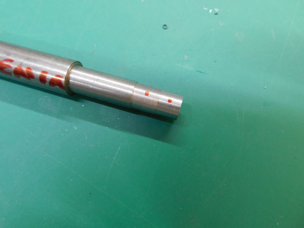

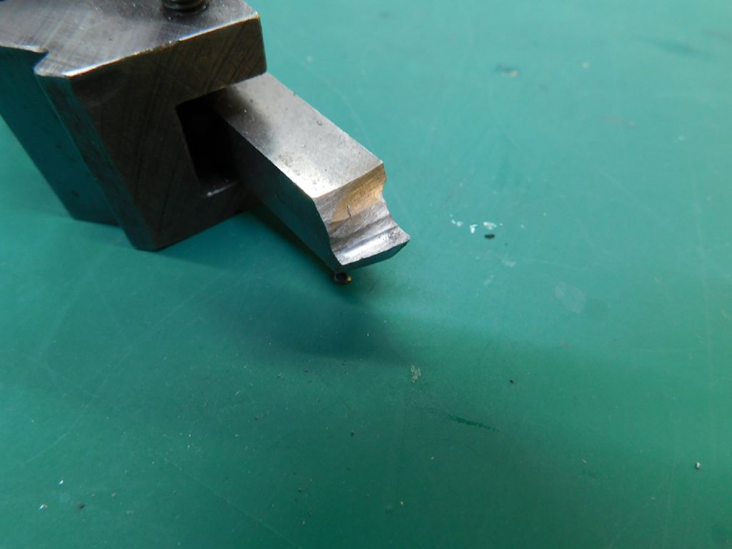

                    Thanks very much all for the comments and info.
                    So this morning I spent half an hour on the EN1A, and it immediately gave a much better result. Started wth the (un-modified) HSS tool:
                    Which gave a far better finish on this material. However, the second pass was nowhere near as good, with some ridges apparent.
                    So, gave up with that (again), and went to the GT insert, which gave fairly similar results, and more consistent in subsequent passes too:
                    After wrapping some abrasive paper and Autosol around it for a minute or so, I ended up with this:
                    Not perfect, but far closer to what I wanted. So GT insert, lubricated with oil aerosol and finished with fine abrasive and polish is what I'll do.

                    Quick question on procedure:
                    It was mentioned before to swap the rod after machining one end, so always machine at the tailstock. I suppose to get the diameters of each step precisely the same, I could rotate the shaft after every roughing cut, and final cut, such that the diameter setting would be identical for both ends? The only issue would be the length stop would rely on the centre drillings to be of identical depth, otherwise the lengths would be slightly off.
                    So is it best to complete one end, then swap and start again on the other, or do them 'simultaneously'?

                        Looks like you are on the way in the right direction Doc.yes
                        First off you have the perfect set up for determining the length of turned surfaces. Slip gauges are the perfect means for that – their non calibration is of no importance – what they are is far better than any other means as previously described. As your image shows is exactly how I would have suggested – just wasn't aware you had any slips to use.
                        Personally speaking if you are going to size the holes by reaming through your flywheel, eccentrics and webs etc then it would be a good idea to make them first so you can fine turn/polish the relevant diameters to suit rather than the other way and getting the holes to suit the shaft.
                        As said, I would do it all from the tailstock end turning the shaft as necessary. Rough the shaft out first to within .5mm on diameters and leaving .5mm or so to come off on the varying lengths. Then fine turn each section to close limits making a note of each setting on final cuts.

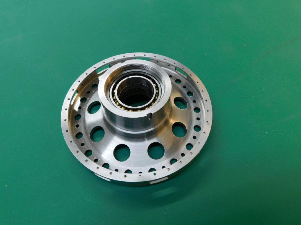

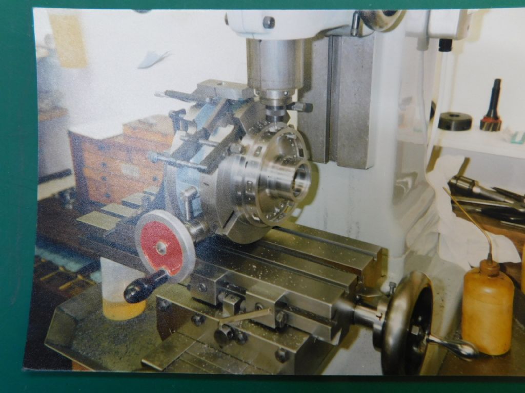

                        The part, 'far from space age', was the front bearing and gear housing from the Bentley engine I was building. All of the steel case parts were made from En1a and turned using HSS. The nine cylinder heads were also En1a the machining of which using mainly home made cutters was described on here several years ago.
                        Here's the rear housing, all of it now residing in New Zealand

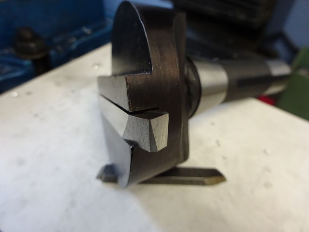

                        I think I may have said on here before but when it comes to grinding lathe tools I have to be one of the laziest around. Only occasionally and really 'when needs must' do I rough out a new tool. Consequently the shapes of tooling are about as far removed from text book idealism as you could imagine. That said however they all work for the most part because the only area I pay attention to is that which actually does the cutting.
                        I took a very old and well abused tool out today tweaked the end on the grinder and cut some En1a to a fine finish without any issues I did take pics but all were hopelessly blurred

                          The Bentley casing looks awesome – I'd have assumed something like that was CNC'd unless you'd told me.

                            Well that's your choice of course but it's much, much easier to measure a shaft to the tolerances required than it is the bores to fit the shaft – just my thought.
                            I oversaw, programmed and ran a 20 tool Haas machining centre for about my last three years of work but those Bentley parts pre date that considerably. I found this photograph (ha remember those?) of an op on the rear bearing housing only the other day dscn0175.jpg

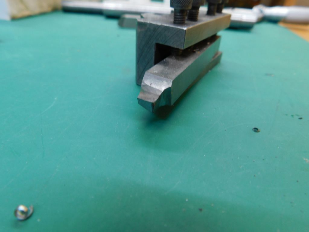

                            This goes way back further than I first thought – not only is the old original table in use but there's no DRO either. It was this op that lead me to fitting dead stops to the rotary table and some to the Y axis when I replaced the table. (Note the jury rigged dead stops on the R/T) Crumbs, now that is history!
                            I also took a couple of pics again – as you can see this HSS tool is very close to it's 'sell by' date
                            It does have a fair back rake on
                            I literally just tweaked that small radius on the front corner on the bench grinder and cut this scrap piece of 1/2 dia En1a with no coolant at about 600 rpm The dots are the fresh turned areas the shiny part about a 1- 2 thou cut. As machined, no emery or wet or dry paper.
                            Good luck with the shaft – R

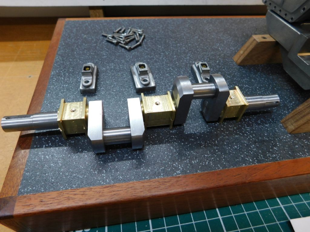

                                Thanks Ramon. Re. The shaft vs. hole first debate:
                                You mention relative ease of measuring, shaft vs. bore, which I get, but I’m not machining to a size and tolerance, I’m doing it pretty much by incrementing cuts until one thing fits to another such that it feels about right. So to me it seems irrelevant which I do first.
                                If I make the shaft first:
                                and screw up the crank webs, I’m making a new shaft to suit (no spare web castings).
                                and screw up a bearing, I’m making a new shaft to suit (quicker/easier than making new bearings).
                                and screw up an eccentric bore, I’m making a new shaft (quicker than making a new eccentric).
                                and screw up the flywheel…ditto.
                                If I do all the bores for the above first, and screw the shaft up…I’m making a new shaft.
                                So whichever bit I make first, and whichever bit I screw up (and believe me, I will)…I’ll probably be making a new shaft.

                                    That is kind of the way I look at it DOC what can I afford to muck up and what part has the most work in it. Different if they were small holes that I was going to ream as I can't get a boring bar easily down 5 or 6mm hole so would do those holes first then make the male part to fit. It's not a universal thing and each job needs looking at to decide what is going to work best.
                                    Also with your new stepped design how will you form the various hols to a measured size with the equipment that you have which is going to be a digital calliper. Using the shaft as a plug gauge will allow you to feel the fit rather than measure a shaft that is a few microns down on a hole you can't accurately measure anyway.
                                    Many an engine is also made with built up crankshafts where you start with material of a set size* so have no choice than to make the various parts to fit the shaft, again if you only have a digital calliper there is not much chance of hitting an H7 tollerence or whatever is needed and hoping it will fit. Better to use a stub of shaft material as a plug gauge and bore to suit that making the bearings a different fit to the flywheel and eccentric and the cranks an even tighter fit.
                                    * This includes all the 2×1 Stuart models where you are supplied material for the crankshafts so the flywheel, bearings and eccentric need to be made to fit.

                                                Using a such a long item, the shaft, as a plug gauge with it's potential, of wringing a much smaller part held in a chuck runs a good risk of moving the part in the chuck but I offer my thoughts based on my own experience. As I commented right from the outset – make the hole in the bearing first and machine the outside to suit then use the bearing to size the shaft to a running fit.
                                                No ones mentioned it as yet but once the bearing is split and the solder faces cleaned the diameter is reduced slightly anyway.
                                                One way the bearing is finished and the shaft is reduced until it slips on with a good running fit usually by 'polishing' with a fine file, emery or wet and dry paper. Much easier I would suggest than doing the reverse in a hole with its potential of tapering/bell mouthing over such a short length.
                                                In an ideal world both would have probably been made by two different people to tolerances that would ensure the perfect fit. I can't speak for anyone else but It makes perfect sense to me to be able to measure the shaft diameter easily and potentially more accurately than it does a hole, especially around 12mm or less
                                                We will have to agree to differ I'm afraid

                                                  Unless Doc is going to buy a bunch of incremental reamers in 0.01mm sizes then he will have to make do with what kit he has. His drawings do not show common nominal sizes except for the 3/8" end so would need separate reamer for each to the sizes on his drawing. You keep mentioning the kit he has so I'll mention it too. Yes a commercial shop may well ream but a non standard size would put costs up, ammature in the home workshop has to make do.
                                                  Even then a 12mm H7 reamer could be anything from 12.000mm to 12.018mm and then there are other variables that can affect cut such as material, pilot size, condition and quality of reamer, dry or lubricated, machine or taper. etc
                                                  Even if it did cut to size you would not want the same tolerence for all parts, cranks would be light press/tight push fit, flywheel push fit and bearings a running fit.
                                                  You are also now saying you will polish the shaft down to a fit, earlier you and hopper ware saying measure the shaft,
                                                  Is what I say really any different to a plug gauge mentioned in another recent thread except it's a bit longer and by using the actual part there is no risk of inaccuracy between the part and a separate plug gauge.
                                                  Like you I would say it is easier to measure a shaft so why not machine that first to your design size and then fit the hole to suit which only needs measuring until you are close to size then sneak up by trial fit so no accurate measurement of the hole is even needed.

                                                    It is easier to "sneak up" on an exact diameter on a shaft than inside a hole. Boring bars are inherently springy and bored holes notoriously tapered in smaller sizes where thin boring bars spring a lot. Sizing a hole precisely with a boring bar is difficult. Sizing a shaft OD with a turning tool and emery cloth is machining 101.
                                                    The usual way I do such jobs is drill, bore and ream the hole so it is round, straight and parallel, and located. Then turn the shaft to fit it, making final size with emery cloth and oil and "try and fit" it to the hole to get final size. Looser fits in bearings and tighter fits in crank webs can be achieved by how much final polishing is done on the shaft in what location. These are one-off jobs so such minor adjustments are no big deal to achieve the desired fit.
                                                    But, that is just the way I do it for general machining, and my experience on model engines is limited to a small handful over the years.

                                                      I am beginning to think you are being a bit pedantic Jason, surely not?
                                                      No way does Doc have to buy a series of reamers in 0.1mm increments – whatever for.
                                                      I would assume though he might have the odd couple near what is required but if not then make the holes to a pre-machined plug gauge to any size you desire and then make the shaft to suit.

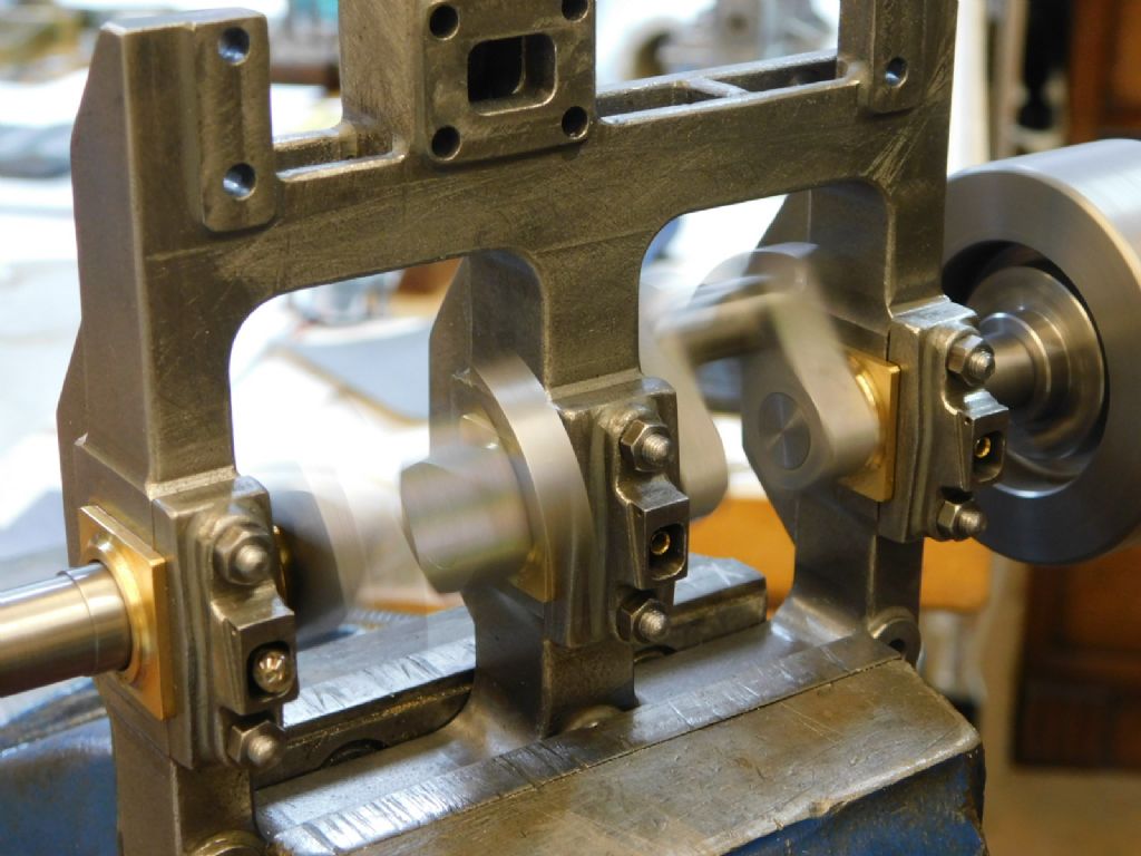

                                                      When I refer to 'polishing' down to size it's taking that last couple of tenths not thou's off to get that fit – of the respective part – just right. Obviously it would be measured down to size, but that last final bit is probably, more likely than not, too much to ask for an old lathe to cope with – it's called 'fitting' don't you know wink
                                                      There was a fair amount of it on this shaft – finished between centres until the bearings, the centre bearing already split, were just able to fit just right. Obviously it would be some machinist indeed to make the centre bearing fit the shaft using the shaft as a gauge.
                                                      I should point out that even then, once fitting the bearings to the bedplate and clamping up the keeps, the bearings/shaft required further 'polishing' until a good running fit was reached (This is being spun between fingers and thumb BTW no external drive)
                                                      No doubt, now its been painted and awaiting assembly that will require doing again – which is why I have advised before – build it up, including painting as you go along, to eliminate any tight spots before moving on to the next stage and ensuring all remains in good running order throughout the build.
