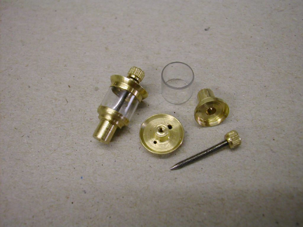

              I've not seen the two cock oilers or fat pots available from the ME suppliers, usually a case of making your own. Yes the idea is you can fill with the lower cock closed while the engine is running then close the top one and open the bottom to allow the oil in, Early ones that would have used animal fat you had a larger top opening so the thick fat could be put in and then the heat of the engine would make it less viscous so it would flow in.
              As our needs are different to a working engine and your scale quite small it may be easier to have the cocks as dummies and just use it as a fancy oil hole plug.
              One I prepared earlier but as it is on a 2/3rd scale engine a bit less fiddly.

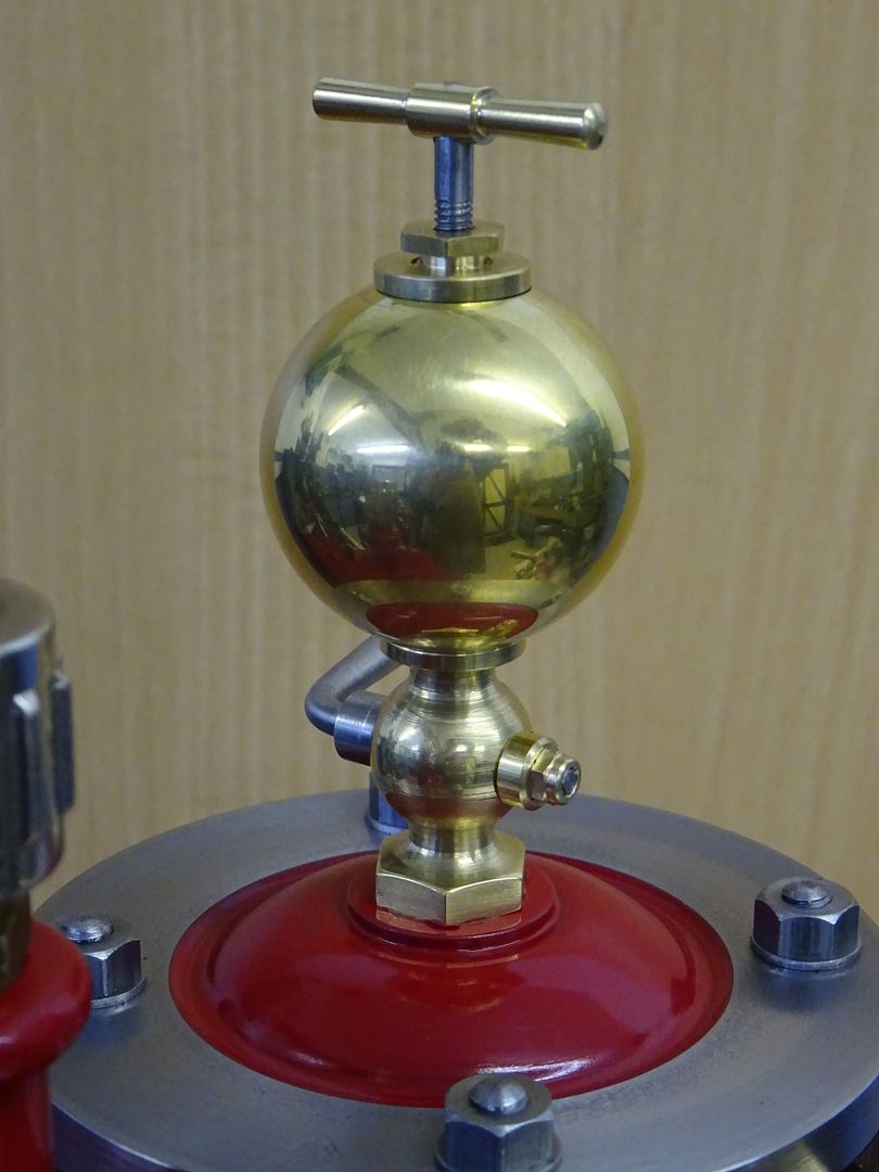

                        Re your comment on the Corliss – detail on the oiling system starts here

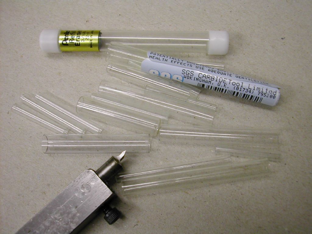

                        BTW a good material for making the glass of cylindrical oilers is the crystal clear tubes that protect artists paint brushes.
                        Ramon

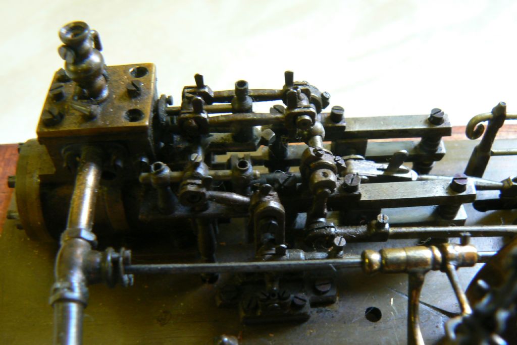

                        Just found these pics from the Waller build that may be of use
                        Edited By Ramon Wilson on 19/09/2021 18:50:52

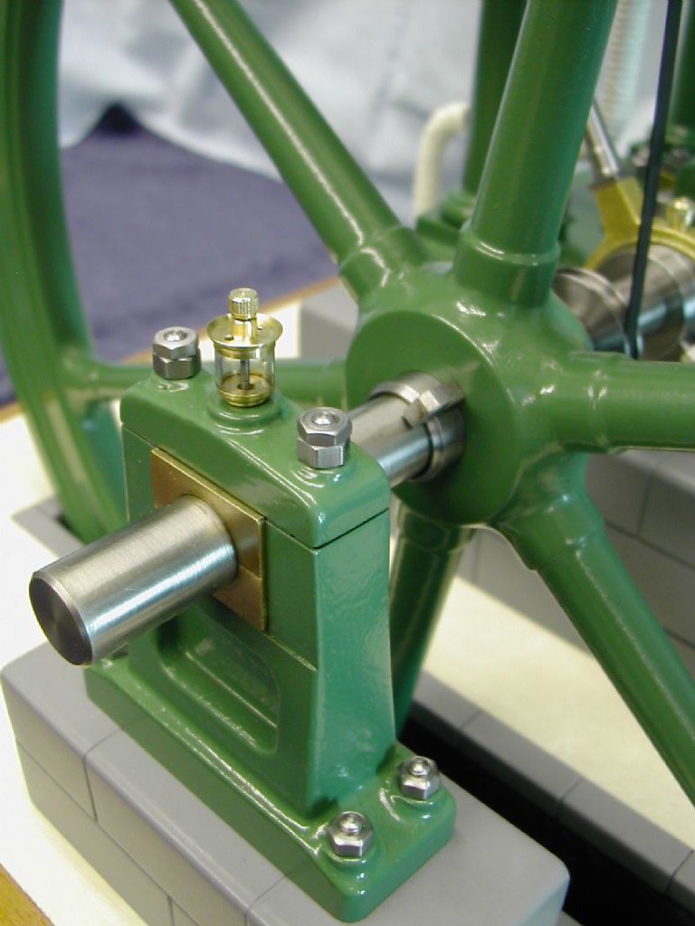

                                Hi Doc, yes all the oilers on my engines are bespoke – some just simple open top cups others to represent full size with glasses etc. Easy enough to make in a variety of forms. As Jason says your engine represents a much larger engine than that in your photo so the oilers should be in keeping.
                                Oiling of your engine cylinders would more likely be by forced lubrication in full size of a similar engine. I found over the years – running on air – that putting a good slug of steam oil into the airline entry will get carried around and coat all internal surfaces more than adequately enough so cylinder oilers can at times be simple 'dummies'
