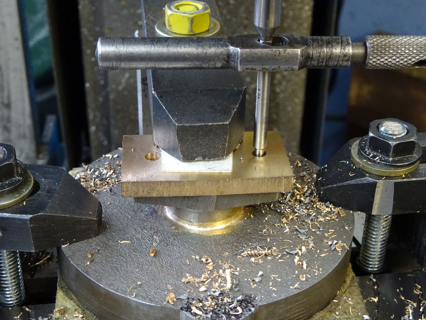

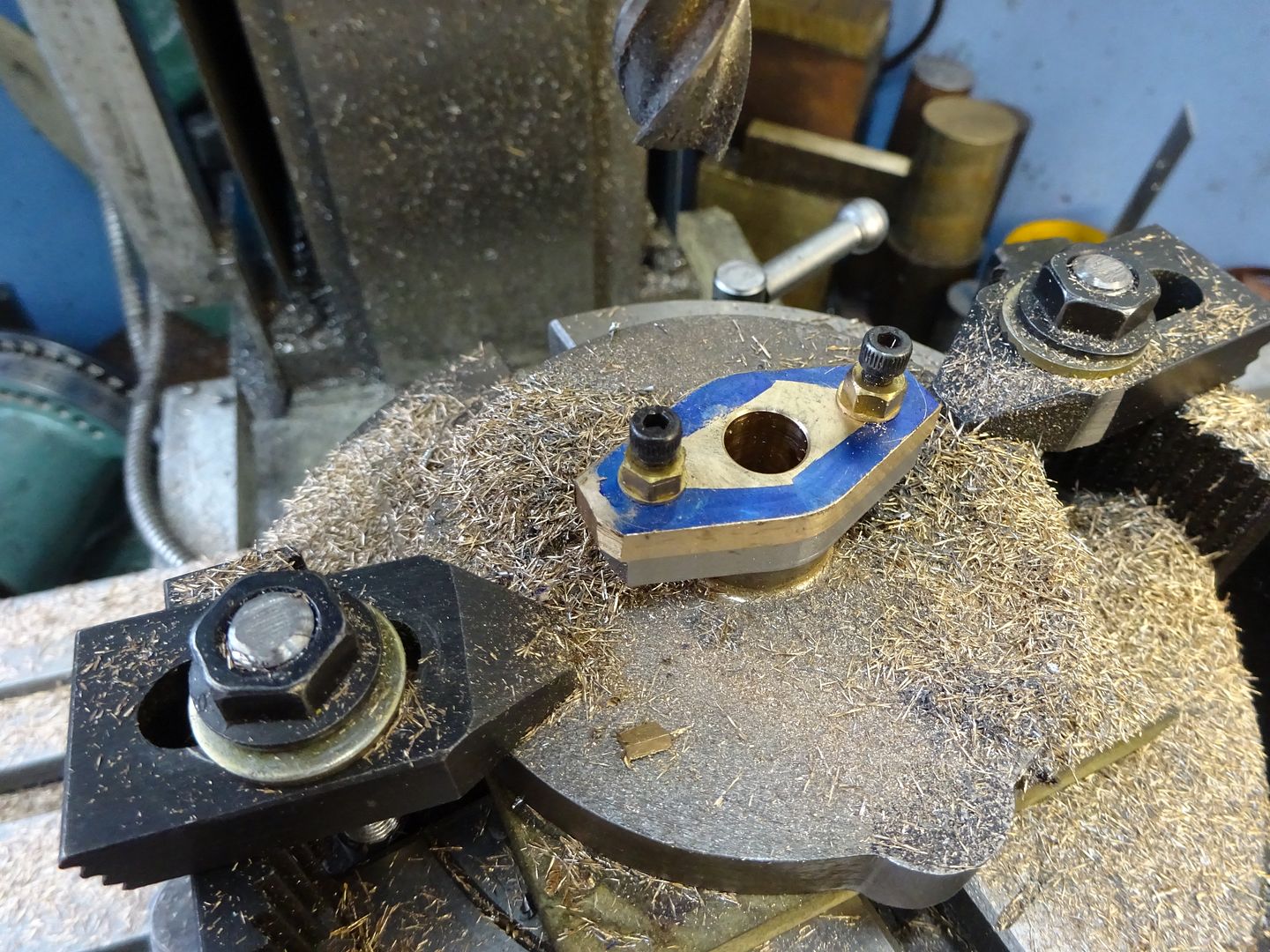

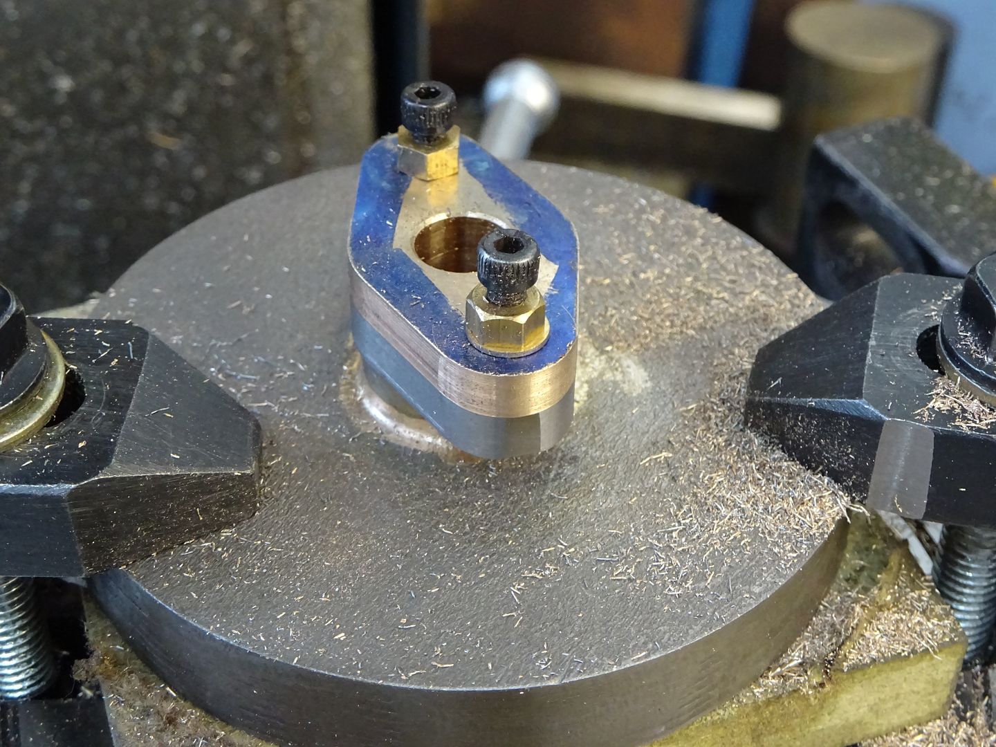

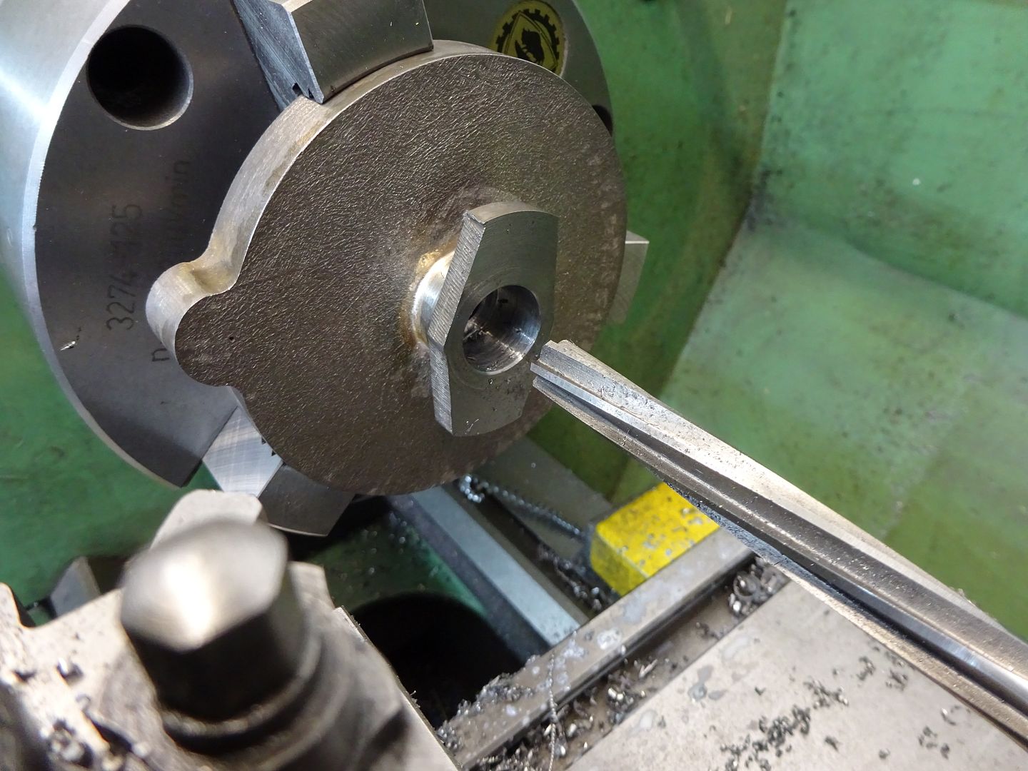

            Here is another one being done, in this case a piston rod gland which was larger so just clamped straight to the R/T. I also did the stud holes using the DRO to get their position either side of the central hole which was located centrally on the R/T & mill axis.
            Basic fabrication with rough shape of gland saw cut
            Located in 4-jaw, counterbored for gland and reamed for piston rod.
            The embryo gland was just a rectangular block with the spigot turned on it, placed in the main part once it had been clocked on the R/T and clamped together. Then offset either side to drill tapping size, drill clearance through gland only then tap for fixings.
            Replace gland clamp with a couple of screws and then mill one side followed by the other. The method is to rotate table to the required angle say 10deg and mill one flat until DRO is at the right reading that equates to cutter radius plus large arc radius then rotate table while cutting until you get to 10deg the other way, lock table and mill the next flat edge. Repeat for the other side
            Now remove one of the screws, loosen work on table and holed the clearance drill the wrong way round in the chuck so it can be used to locate one of the end holes while spindle is at 0,0 then clamp part, remove pin and replace screw. You can then mill one end round. repeat for the other
            take it apart and you have a boss that matches the gland
            There are other shapes of gland such as pure ellipse and one construction or the two long edges formed from arcs and the ends just rounded both need a different method.

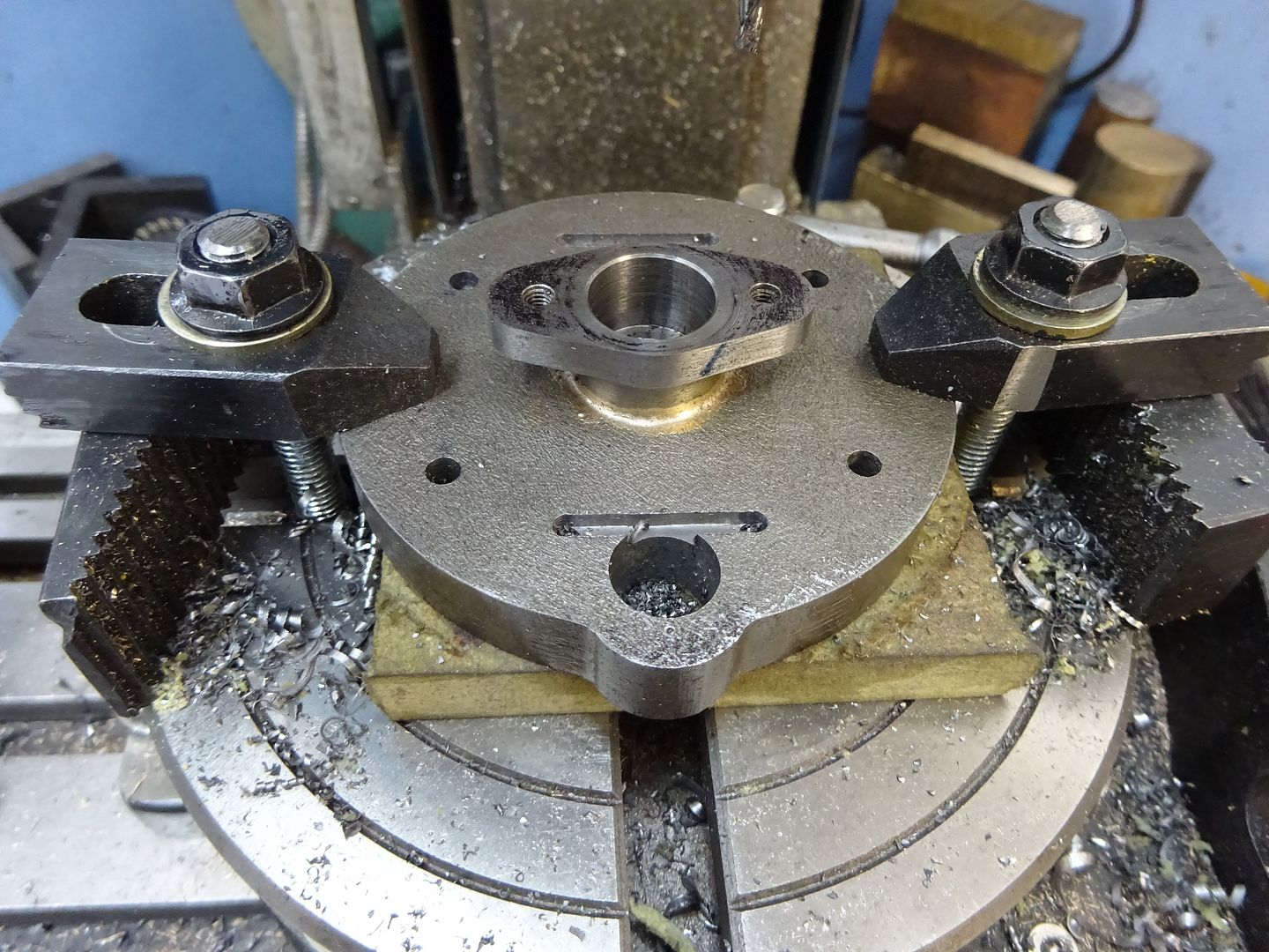

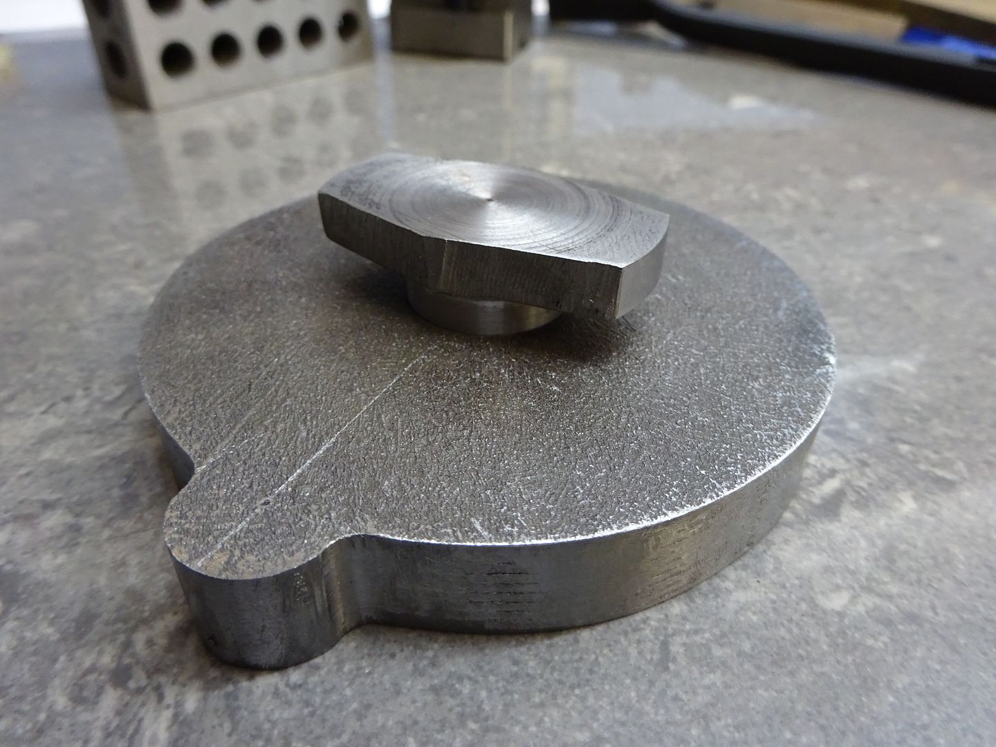

                                                    Temporarily clamped the bosses to the castings, and drilled the 7BA clearance holes using the DROs:
                                                    Then tapped the stud holes:
                                                    Then fixed them using 7BA csk screws ready for machining, and centered the vice on the R/T:
                                                    Then, after much adjustment, centering and angle calculation, made a start on milling the profile while periodically moving in x, then rotation in z, at gradually increasing depts of cut. I tried to always move the table clockwise for this to reduce backlash errors:
                                                    Then re-centered on each end, using the vice stops, and rotated the table to give the radii:
                                                    Turned out OK for a first attempt:
                                                    Before and after:
                                                    Needs some flatting of the machining marks, despite using a constant z-setting for all the final cuts. Not a big deal in this case because they will be painted eventually, and so could be filled if they won’t flat out:
                                                    Now for the other one…
