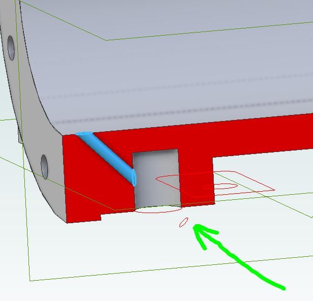

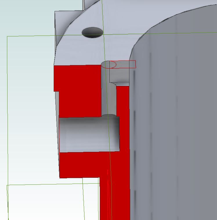

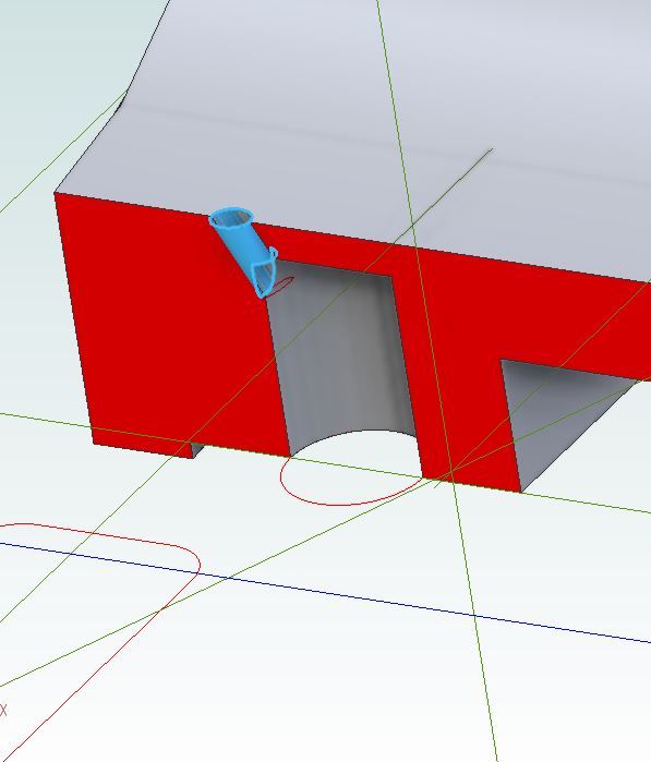

                                        I did some minor tidying up around the feet, and drilled and tapped the cylinder drain cock holes as per the instructions:
                                        The instructions call for an angled hole to be drilled from about 2mm from the end of the cylinder bore, to meet with the upper part of the drilled and tapped hole. It seems quite a shallow angle to drill (about 12 degrees to the bore by my calculation), so I'd have to start the hole in the bore probably using my long series centre drill.
                                        Question is, I think it would be much easier to just drill in from the end of the cylinder flange into the top of the drain cock hole, then drill down from the cylinder (obvioulsy at a very slight angle) to meet it:
                                        The hole in the flange would be sealed by the cylinder end cover and gasket.
                                        Is there any disadvantage to this method, or is there an easier way of drilling the single, slanted hole and ensuring it ends up breaking through towards the top of the drain cock hole? Obviously if it ends up lower, it could be blocked by the drain cock thread. Cheers.
                                        #561051
                                          It's not critical that the holes go right to the very end of the cylinder, any condensate will tend to be blown out between the gap around the piston either side of the rings/packing.
                                          Simple way to do it is to drill in from the tapped hole either straight or at whatever angle you can get, even starting where bottom meets side of hole will work and help the drill start.

                                          If you really want to get it right upto the spigots on the covers than rather than try and drill an angled hole like you show just use a 1.5mm milling cutter to make a small "D" shaped notch say 2.5mm deep so it extends beyond the cover's spigot
                                          A ctr drill will only be slightly more useful than a standard drill at starting on an angle, less so the steeper the angle or longer the ctr drill. Better to gently plunge with a flat or ball nosed milling cutter to give the drill somewhere to start

                                            Thanks Jason. I'll go with the 1.5mm end mill method (similar to the 10V geometry IIRC). I've just got that sized milling cutter for the car differential output spigot job.

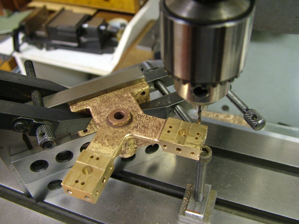

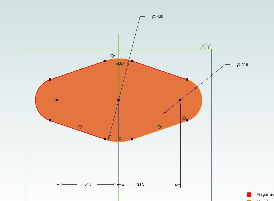

                                                I’ve got this profiled brass/gunmetal for the packing glands and the exhaust ports. They all need drilling centrally, and then two holes for studs each side:
                                                First question is how do you set the bar up to drill right in the centre, and get it square in order to offset the two securing stud holes, making sure they’re dead central to the section? For example on the valve boxes, I want to machine each side offset from the central hole to get the whole thing centred above the cylinder axis. So I need to drill that valve rod hole centre first as a datum for marking out, and for setting up in the 4 jaw chuck.
                                                Also, I’d like the gland/flange profiles to match their cast iron counterparts. As you can see they are all different. Is it a case of temporarily bolting them together, then filing one part and/or the other until the profiles match?
                                                Thanks.
                                                #561206
                                                  You can set the extrusion up in the 4 jaw checking opposite sides are central and then face and turn the raised central boss. Once turned blue the end with a sharpie and use your new height gauge set to lathe ctr height to scribe a couple of lines either side of the boss when the extrusion looks horizontal in the chuck, Square against a chuck jaw can help. Then increase height gauge setting to include half the stud hole spacing, rotate chuck 90deg and scribe one line, rotate 180deg and do the other. part off and repeat for the others. Carefully punch and then drill the stud holes.
                                                  Valve chest. File off the casting sprue, blue and mark out position of hole again height gauge make sit easy to do the offset height then measure overall width, half that and set gauge to that so you can mark it's position width wise and punch where the lines meet. Set up in 4-jaw so the punch mark runs true, face, drill, ream, countebore and drill the far end then mark out as for the glands or back into mill vice, locate ctr of hole and just use DRO to get the position of the two stud holes.
                                                  Yes screw them on and file to suit
                                                  Back to the Cylinders, have you gone deep enough with those notches? they need to be deeper than the 1/16" spigots on the cylinder covers unless you are going to machine clearance on the spigots.

                                                      As you are going to end up filing most of the extrusion's edges to match the CI bosses lining up with the jaws by eye should be fine unless you don't have a good eye for that sort of thing.
                                                      the problem is that they used to supply castings rather than the extrusion and they were more like the shape of the iron bosses which are really 3 circles and 4 tangental edges. If you get your rotary table then that type of shape is quite easy to mill so you could bolt on the flanges and locate the two parts under the mill spindle and machine to a nice shape.
                                                      This is what I machined the flanges too and the iron bosses only needed a very small amount of file work to match
