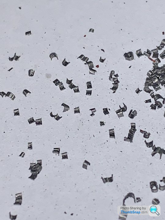

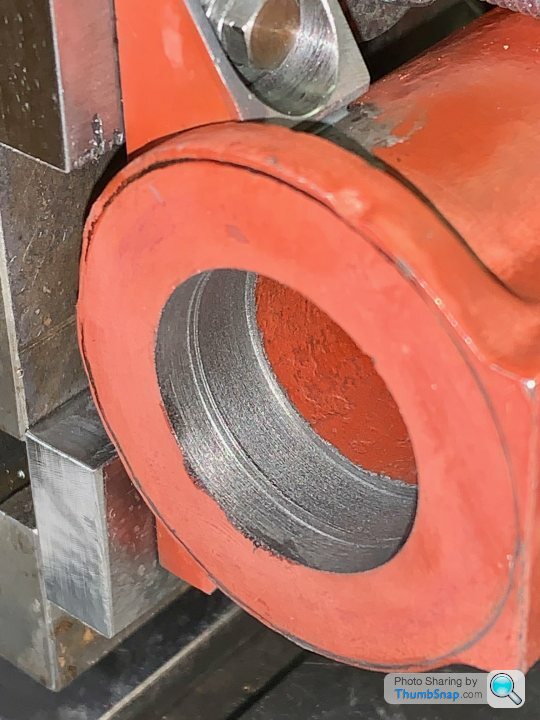

                                          I think overall it went OK, but I'll let the experts be the judge. I started the first cut at 62 rpm, and initially, all seemed well. Then I thought something wasn't quite right, so stopped and found this:
                                          I realised that the bottom of the cutting face was probably scraping on the bore, so I ground some material back:
                                          Not sure how it formed the ridge, but anyway it was fine after that. These were the chips:
                                          So I measured the bore, incremented the bit a tiny amount, and went again, this time at 110 rpm. All seemed OK, took about 12 minutes. These were the chips:
                                          And the bore:
                                          So I've now got within about 0.025" on diameter after two cuts. Surface finish isn't quite as good as on the 10V, but of course that was with a Sandvik tip:
                                          So how should I proceed? Modify the bit, or will lapping with a wooden plug be OK? And how much should I leave on for final lapping?

                                            That's a good result and looks fine for the initial cuts Doc so if you don't want to radius that tool bit take the tool out ready for the second one and grind another up with a slight negative leading edge and a decent radius on and take a couple of cuts to size. If done right the finish will be much improved.
                                            This is what I used to do the cylinder in the post back a bit – the leading edge of the bit is the left side as you look at the image. The finish straight off the tool was fine enough to just lightly hone with a brake cylinder hone. Bear in mind if you are only going to run on air then the piston can be fitted with PTFE impregnated yarn as discussed before. With a one thou or so annular gap on the piston the friction will be minimal but the seal will be as good as you could wish for.
                                            You will of course need to redo all that for the second cylinder but you should be able to get them close to diameter if not exactly identical – any discrepancy easily taken up by making pistons to fit.
                                            Unless you get some major turning marks (radiusing the tool should eliminate those for the greater part) lapping (as opposed to honing) should not really be neccesary
                                            Good outcome – twelve mins is not long really though I bet it felt like an hour eh

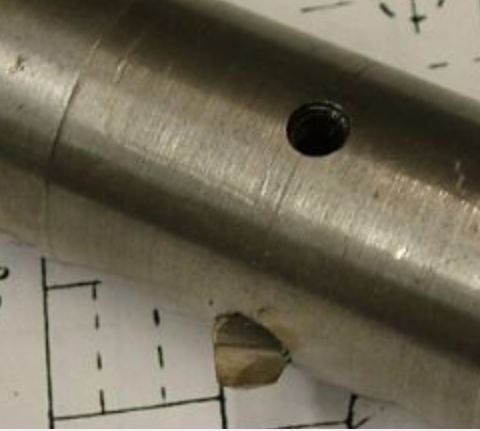

                                                Any help, the leading edge on the left is angled back about 20-30deg
                                                Edited By JasonB on 31/07/2021 07:01:08

                                                  OK thanks I’ll have a go.
                                                  How come that angle is much larger now? What would happen if I duplicated what I have, but with a radius?

                                                    Thanks Jason yes
                                                    I have found the tool as above works well on cast Doc but it's not specific. If you are happy with your toolbit then by all means duplicate it with a decent radius – make sure that radius is backed off so it doesn't rub behind the cutting edge though.

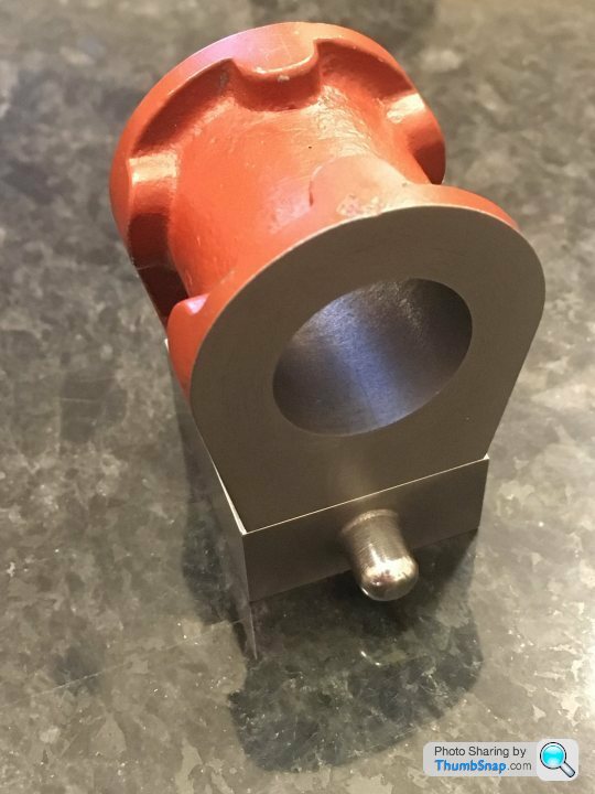

                                                      Thanks both. Ground another tool, this time with a radius:
                                                      But unfortunately it wasn’t great – got chatter and I could hear it was rubbing not cutting. I tried slower speeds to no avail. I reduced the radius slightly, and increased all the angles – not very scientific, but basically made all the edges ‘sharper’. This time it worked. I stuck with 110 rpm. These were the tools I’ve used:
                                                      The final cut chips were small curls of material, which looked ok to me:
                                                      Surface finish is much better, I might do lapping anyway as per the 10V, mainly because I liked doing it. The bore did break into the feet screw holes, but that was expected.
                                                      I measured the bore in several places with the gauge and micrometer:
                                                      And with the verniers, both ends the same. It really did measure 1” at both ends. I know verniers aren’t the best for I/Ds, but it’s close enough I think, and I was somewhat startled at the result, so took a picture before it changed!
                                                      Now for an issue. I had a small heart attack when I first saw this:
                                                      …but there is no ridge at all, confirmed as I said because the bore seems very consistent (almost unbelievably consistent I know). Any idea what this colour difference us? The last cut was continuous, and there was nothing at all to suggest anything changed during the cut. No discernible change in surface finish either.
                                                      Cheers!
