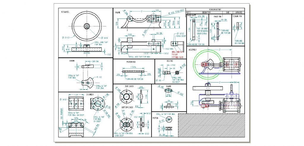

        SarahJ
          @sarahj
          I wasn't sure about a few details when i stsrted my Progress, so when i was laid up and bored with my back injury i did some drawings to help.progress assembly drawing.jpg
          Let me know if I can help with anything.
          Sarah

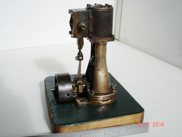

                  Ian S C
                    @iansc
                    When the progress engines were introduced in the 1920/30s there were 4 engines, a horizontal and a vertical oscillator, and a horizontal and a vertical slide valve engine. There is a vertical slide valve Progress in my mates little museum. This is as found, I tidied it up a bit and did a bit of repair, a nice wee engine, about 90 year old.
                    Ian S C
                    Edited By Ian S C on 24/10/2018 13:28:40

                      Posted by SarahJ on 21/10/2018 19:46:03:
                      Sarah
                      Edited By Sarah Frazer 1 on 21/10/2018 19:47:35
                      Hi All. I'm extremely new to the world of model engineering myself and recently got a second hand set of castings for this engine and was wondering if anyone had a higher resolution picture of these drawings as they are significantly more detailed that the provided ones however I can't make out all the measurements. Thanks in advance.
