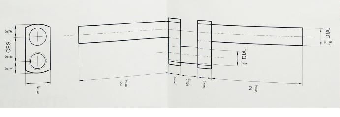

              right now I am also completing a ST #4 engine from the same period of casting production. 35…40 years old and still with a cast iron crankshaft. The ST #4 drawings I have were drawn in 1953. I found the dimensions of the webs of the crankshaft to be incomplete in the drawing. The size given is 5/8 x 3/8 x ? To what size did you finish yours?
              Thanks,
              Manfred
              #431566
                About 1 1/8 to should do, The later drawing has the ends 5/16" from the pin and shaft ctrs but that does have a smaller 3/8" pin but still gives 1 1/8" on the later engines

                  Many thanks for your help. I think I'm going to adopt the dimensions of the built-up crankshaft as pictured in the more recent drawing you supplied.
                  Regards,
                  Manfred
                  #431576
                    Just looked at it again, the pin is actually still 7/16", just the two ends reduced to help with spacing on the built up version

                      Not sure where I located my original drawings! but having a quick look at the engine the crank webs measure 3/8 by 3/4.
                      I also upped the bearing diameters to 1/2
                      Hope this helps?

                        Many thanks. Problem solved.
