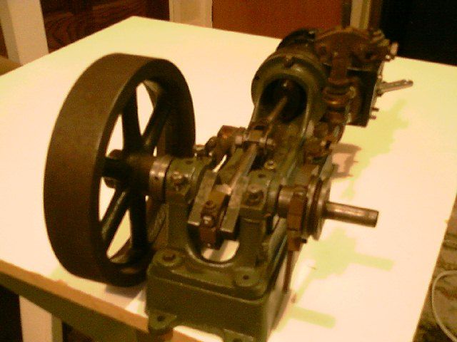

              a year or so ago I rebuilt an S9, the crankshaft had a slight bend, so rather than try and straighten it I made a new one from flat steel as John suggested, well I actually made two, the first one just as I was finishing it got caught up , and bent, which was enough to make one say bother, and pack up and do it again the next day.
              Unfortunatly this engine got nicked from a public open day display. The origional CS seems to be a forging, the engine was at least 50 years old. Here it is the S9 before anything was done to it
