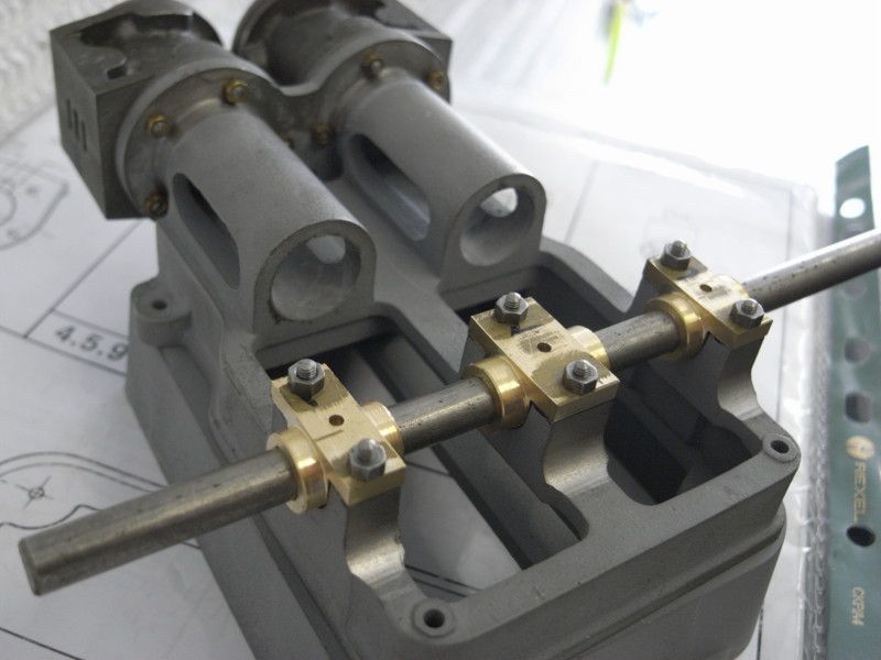

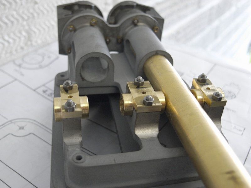

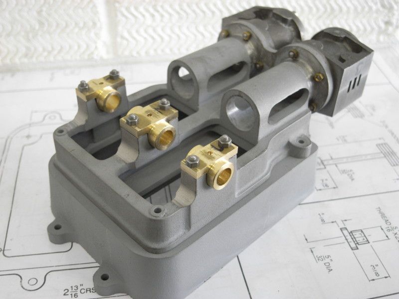

      Checking and centralising bearings

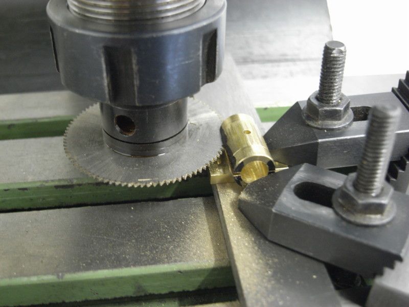

      using a slit saw to split the centre bearing – I may solder up the open edges with a brass filler strip and re-bore to close up the large gap left !

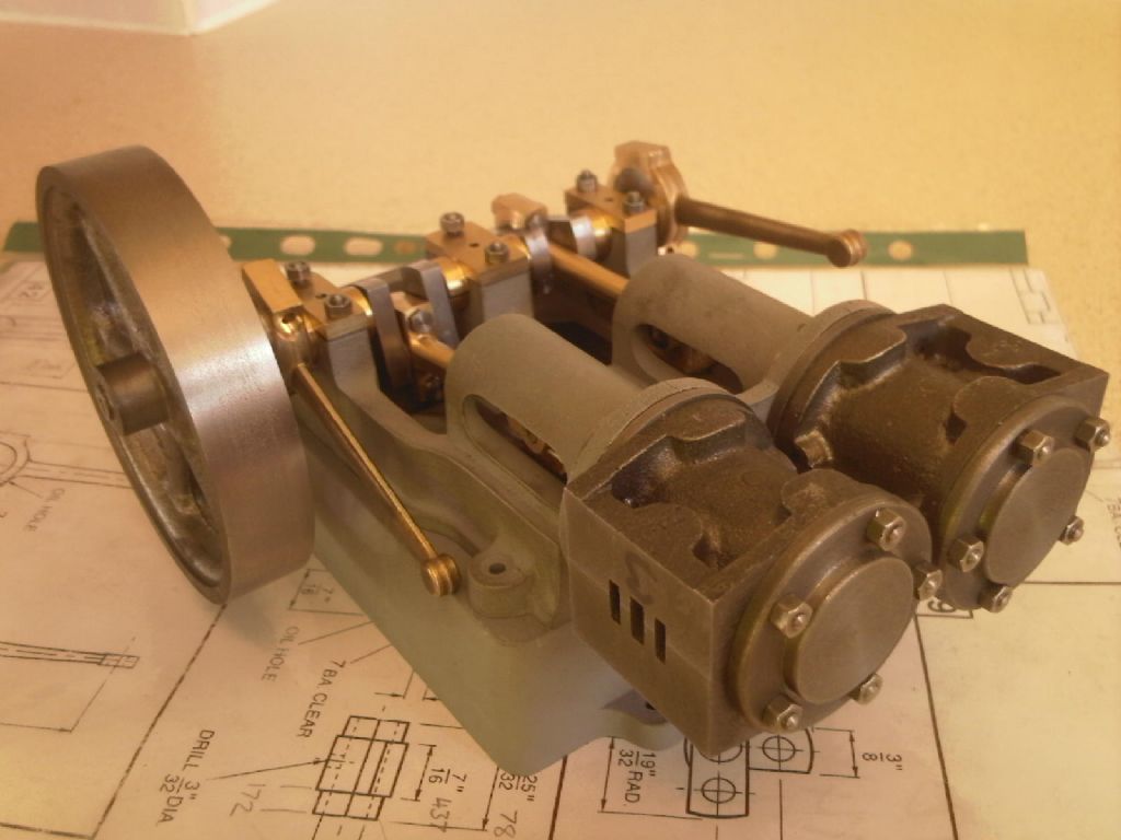

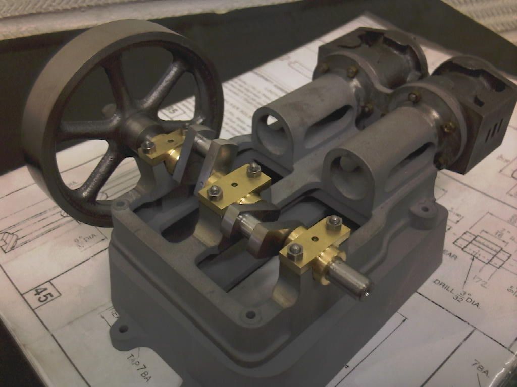

          Finally got chance to get back in the workshop and finish the build

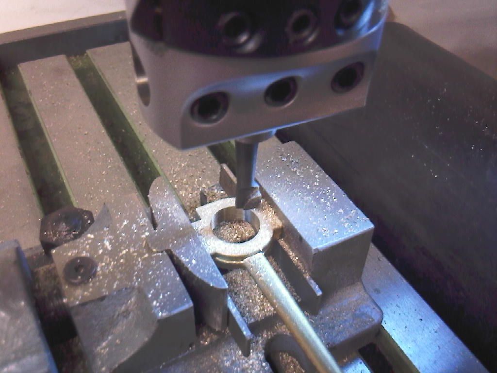

          Crank made up pinned and silver soldered
          Boring eccentric
          Building up

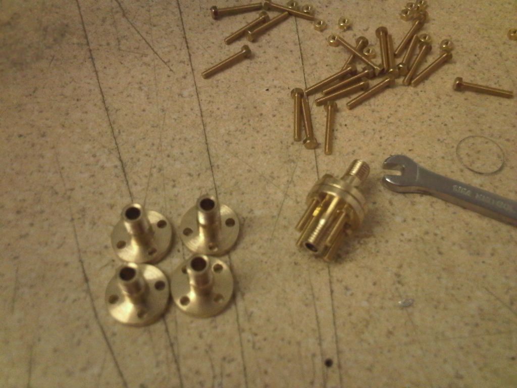

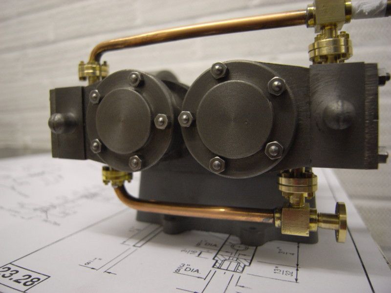

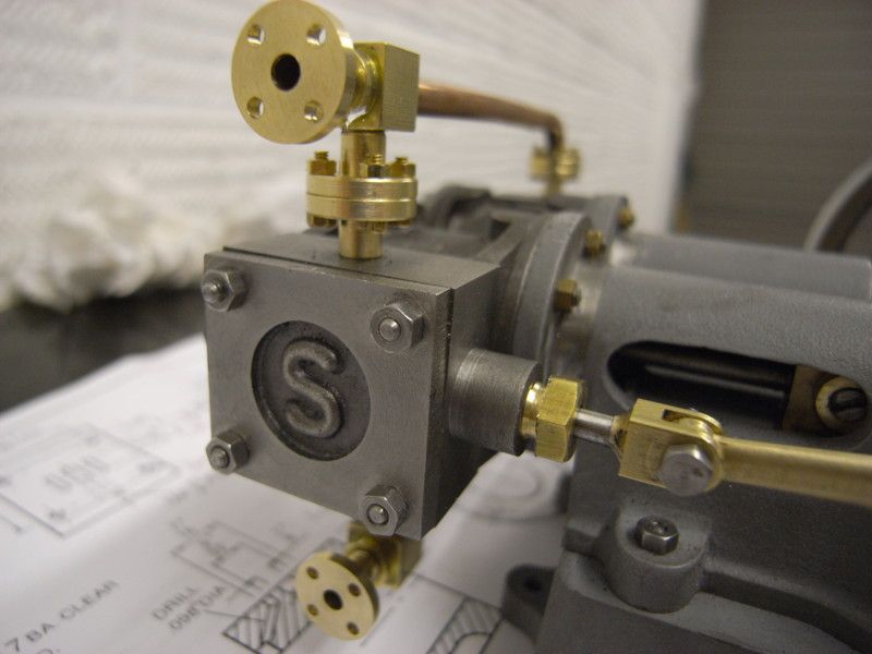

          Wanted to pipework to look a little more to scale than the Stuart “off the shelf” ~ so made some flanges and pipework as she’ll only be running on air
          oh what fun with 10BA bolts !

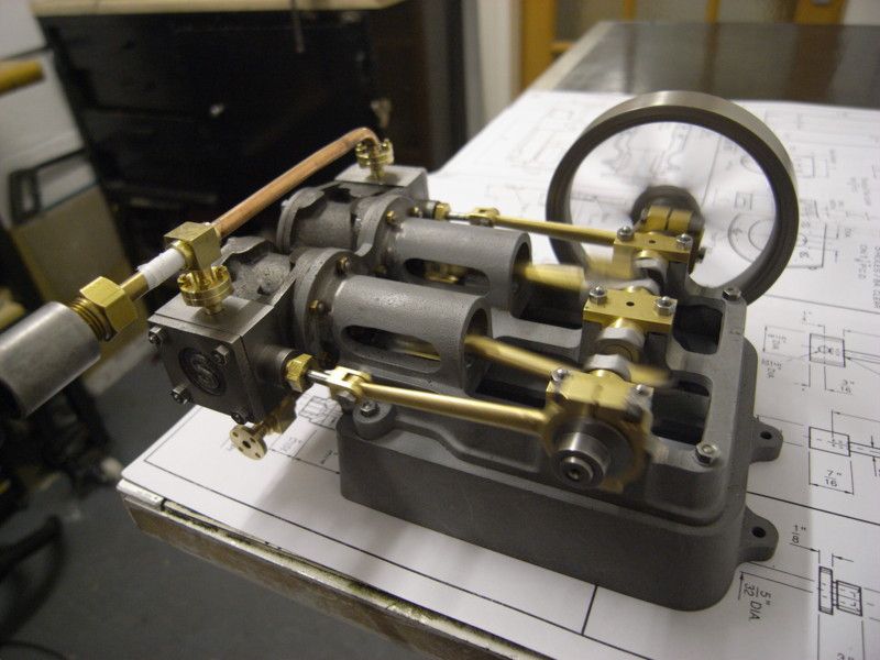

          Here she is running on air

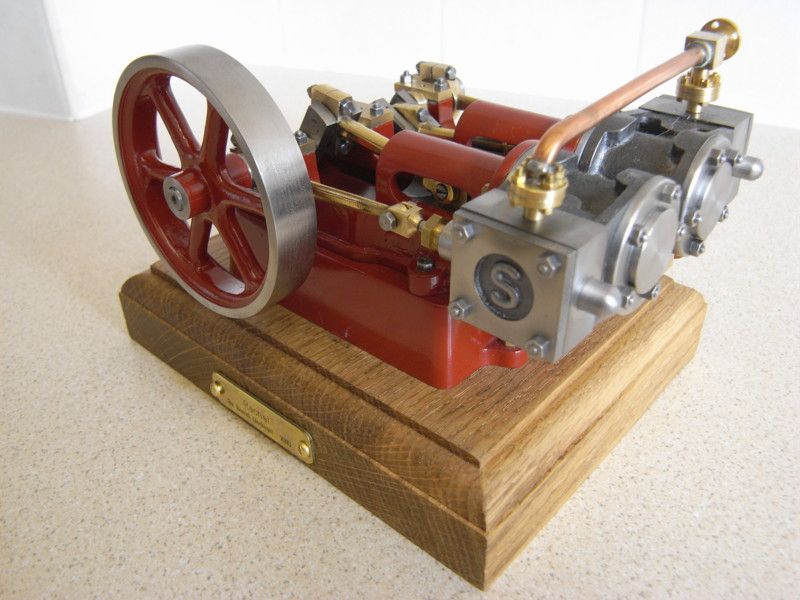

          Just need to make a base, and then I’ll wait for the warmer weather before painting, not sure if to go for red or green?

            Looks great David, especially the pipe flanges. So much better looking than commercial fittings.
            Regarding paint, it sure would be nice to see a stuart engine not painted fire engine red or John Deere green.
            Blue with orange highlights looks great, so does maroon or burgundy on these engines.
            I did see some USA made stuarts with pale green and pale yellow or white trim, they looked very smart.
            Up to you of course. Great job so far.

              Some very good images showing some very nice workmanship – you should be proud of your achievements David, so soon in the hobby.
              I’m with Jeff on the ‘traditional’ red or green – you do see far too many but maroon always does go well with smooth shiny steel and brass in my book.
              I like the thought of Jeffs suggestion of pale green though.
              Congrats on another model – so what’s next then ?
              Regards – Ramon

                Many thanks, for the coments. Painted my last engine Pale Blue, I too could’t face another British Racing Green. The wife said she’d like red, I’m thinking Brown / Biege but Maroon may be a good compromise.

                  OK ~ so I gave into the wife, I said I didn’t want to paint it red !! she won, well it is named after her

                    She looks fantastic ( I’m sure your wife does too ). I’m about to start on my first model project after four years of “tooling up”. I’ve opted for a 10v and I’d be delighted if it turned out anywhere near as good as yours.

                      Hi David, great job on the build. If you followed the drawing and went with the dimension for fitting the cylinder to soleplate studs, I am pretty sure that gave you a bit of a headache to fit the nuts…caught me and quite a few others, lots of fettling to do and 1/2 sized nuts. contacted Stuarts re.changing pitch circle dia. to a tad bigger, a lovely engine to build and run.

                        Congratulations on another fine piece of workmanship again so nicely finished and presented. It might be ‘red’ but it’s a very nice shade (or should that be hue?) so what did you use?

                          many thanks for the positive feedback – paint is plastikote, several thin coats, rub down in between.
                          When i did the 10H “Lancelot” tipped me off about the wrong PCD of the cylinder mounting stud hole, so I enlarged it to 1 3/16″ it was still a bit tight so i made half size nuts. Having done it both ways I’m not too sure which is best ?
