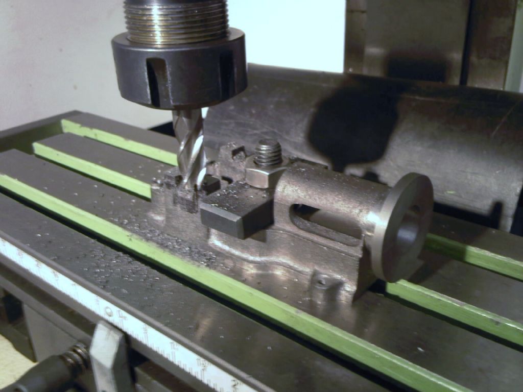

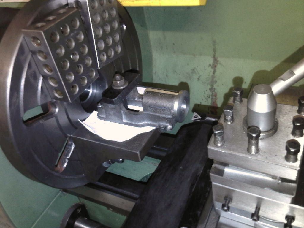

              As a novice I’m currently having a go at building a Stuart 10H and also the Score, had a similar problem of how to bore the crosshead guide in the sole plate. How to keep the bore parallel to the base, square to the bearing mounts and on centre whilst holding it firmly?
              The casing core is 1/2″ so I removed the flash with a 1/2 reamer then mounted it on my face plate, square using a reamer in the tail stock got me within a few thou very quickly, with the a parallel reamer in the bore check along the shank with a DTI is easy
              BTW the threaded square blocks were just handy for balance wieghts but are great for mounting smaller cylinder blocks
              Boring the 10H to 5/8″ – once set square
              Using a 1/2″ reamer to locate parallel, centre and square in one go on the “Score”
              milling bearing mount tops on the 10H
              Edited By David Dodwell on 02/01/2010 18:25:18

                Already been shown Matt, but not only the angle plate fastened to the faceplate but also a “Keats” type vee block to faceplate.
                      Regards   Ian.

                            sorry for not explaining myself very clearly – the use of the reamer was just to help set up the rough casting first before boring, not to ream the hole to size!  dimensional accuracy is less important than geometrical accuracy for the first cut – the success of these little engines depends up on the centre line of the bore been machined parallel to the base, and square to the bearing journals (square to the crankshaft)
                            I just found it easier and quicker to set up on the faceplate this way – having spent sometime trying to average out the clock readings from around to outside of the rough castings and getting no where fast I tried a differant way which worked for me – once things are set up geometrically and the first cut is made, I find the dimenisonal accuracy follows easy
                            Could of used a piece of wood dowel – but the reamer was to hand and fitted the hole nicely in the casting and also the tailstock giving reasonable geometric set up enabling me to clamp to the face plate before boring.
                            Thought about using my milling maching but it seems not to have the rigidity
                            sorry if the pictures are a bit misleading – guess it does look like I’m reaming the holes out but this was done by hand with only a light cut as I’ve found the Stuart casings to be great to work with
                            Edited By David Dodwell on 03/01/2010 01:28:28
                                Just read like you used the reamer to clean up the cast bore??
                                The way that stuarts cast their parts this method of alignment is just acceptable but I would not want to use it with a sand casting where the core may have moved or may not even be anywher near round
                                May have been easier to set the casting up with the angle plate stood on your marking out table so it could be checked with squares and height guage. Then plug the bore to make locating the ctr easier and just move the angle plate about on the faceplate until it clocks true

                                    David – I’m surprised that mill in the picture isn’t rigid enough. Unless its a round column and all the vertical movement required is outside the range of the quill.
                                    There are a number of good reasons to do it on the mill/cross slide. First of course you get a datum across the front using the easily accessible cylinder mounting flanges.  Also of course you get another datum – the bed of the mounting plate. That’s parallel to the bores too – automatically. And there is no resetting between bores, other than moving the handwheels. And of course with no second set up, its a lot quicker –  without mucking about with angle plates and  balance weights.
                                    I;m sure that Tubal Cains “how to guide” will have been extremely good. His stuff always was amongst the best IMO. But I doubt that, when he was writing, the average modeller had access to decent sized mills, in the way that many of us do now.
                                    Yes, of course the faceplate system will work, and with care will work well, despite “2 set-ups”, but not trying to line up off a reamer  – used turn and turn about in independent and independently lumpy bores. Much wiser IMO, to have used a square off the faceplate and used the same face or edge on the bedplate as a datum for each set up.
