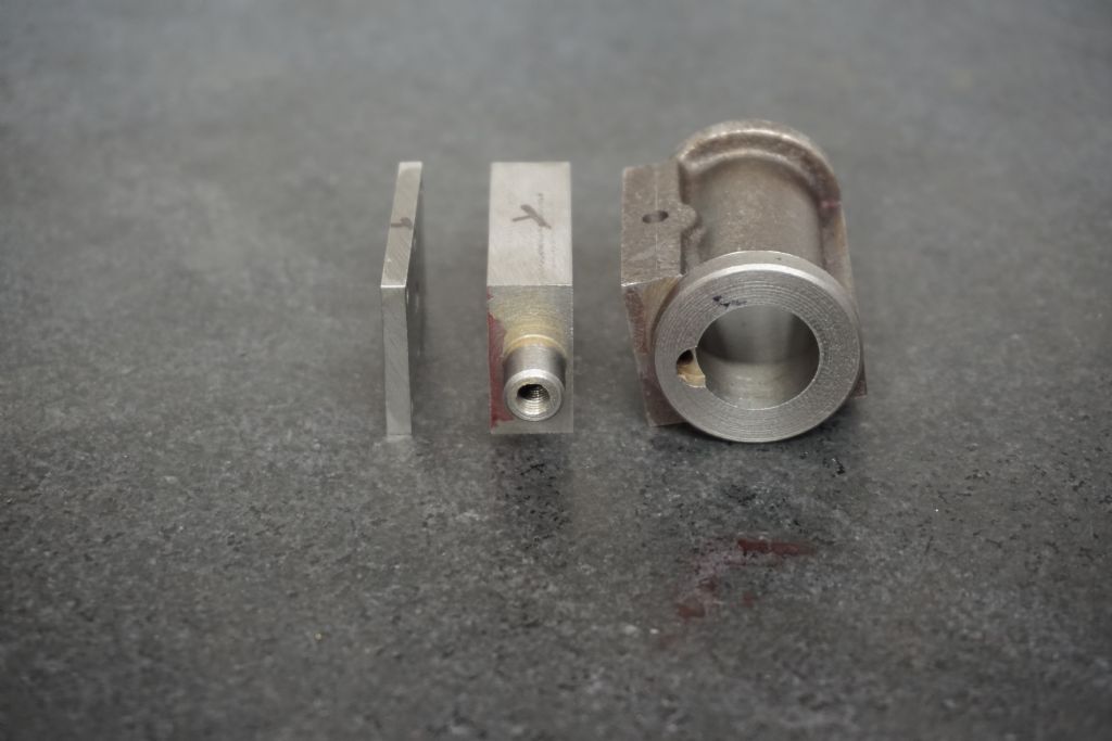

      dsc02005.jpgHi
      I'm a novice and building my first stationary engine – a Stuart S50. Very enjoyable so far!
      I'm following Tubal Cain's Model Workshop series (one of the reasons I chose the S50) and have got to the point where I need to transfer and drill holes from the chest cover, into the chest and through to the cylinder. The bosses on the chest are offset and, from what I can gather from Tubal Cain, they are offset towards the cylinder side. However the assembly diagram that came with the kit seems to suggest that the bosses are offset towards the cover. I think the assembly diagram isn't 100% accurate, or maybe it's just the way it appears in print.
      My guess is that the bosses should be offset towards the cylinder, but I need to be 100% sure before I start drilling.
      Can anyone confirm which side the bosses are offset towards?
      Many thanks in anticipation.
      Andrew

          Hi Andrew, I haven't built a S50 so I'm no expert but can it be worked out by looking at the thickness of the slide valve and the nut that retains it ?
          #361443
            Away.
            Easiest way to check is to look at the valve and nut. The part of the valve that does not have the nut slots in it is 1/8" thick. The nut is 3/16" wide with a central hole so 3/32" from the edge.
            Add up 1/8" and 3/32" you get 7/32" and will also need a slight amount of movement so the valve can lift off the port face.
            Now if you put the bosses for the valve rod closer to the cylinder port face that will only give you 3/16 to the center of the valve rod but you need over 7/32" so it can't go that way around.
            With the bosses away from the port face you have 1/4" to plat with so that works out nicely for 7/32" and a 32nd for lift.

              Hi guys – many thanks for the super fast replies. Your logic is spot-on. I never thought to look at Part 9!
              It looks to me like Fig 28 in Tubal Cain's Part 4 is therefore wrong – as it clearly states 'Top face' – in which case the bosses would be closer to the cylinder. But, maybe, I am misinterpreting it.

                Just checked my S50; the valve rod bosses are biased toward the top plate, away from the cylinder, only just noticeable, so falls in line with JasonB's description.

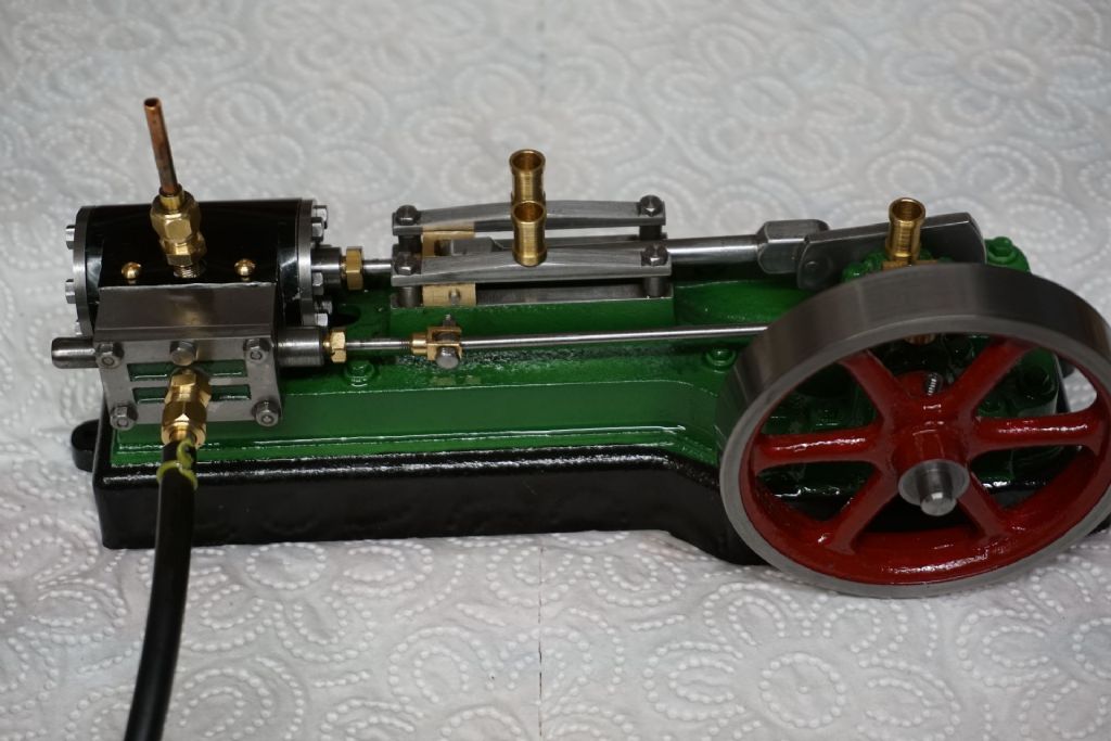

                    Finished
                    Hi folks – just an update…
                    I managed to complete the S50. It runs really well on air and I am well chuffed. Gas_mantle is bringing his boiler over tomorrow to give it a run on steam!
                    Many thanks for the help and advice.
