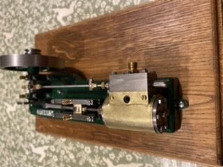

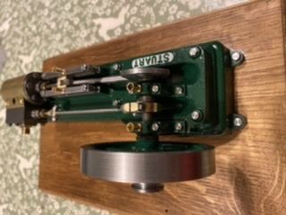

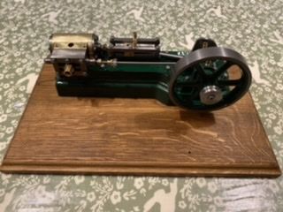

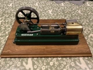

                I’ve now finished my first steam build, my Stuart S-50.
                Heres the finished model. Hope you like. Comments gratefully received.

                Oldiron
                  @oldiron
                  Very nice looking job Jim. Have you tried it on air or steam yet ?
                  regards
                  #501996
                  Jim Beagley
                    @jimbeagley46363
                    Hi OldIron.
                    yes I’ve run it on air successfully. There’s a bit of a knock at one end of the stroke but being a novice I’ve not got enough knowledge to know what’s causing it immediately.
                    Sadly I don’t have a boiler to steam it on which would be ideal.
                    jim
