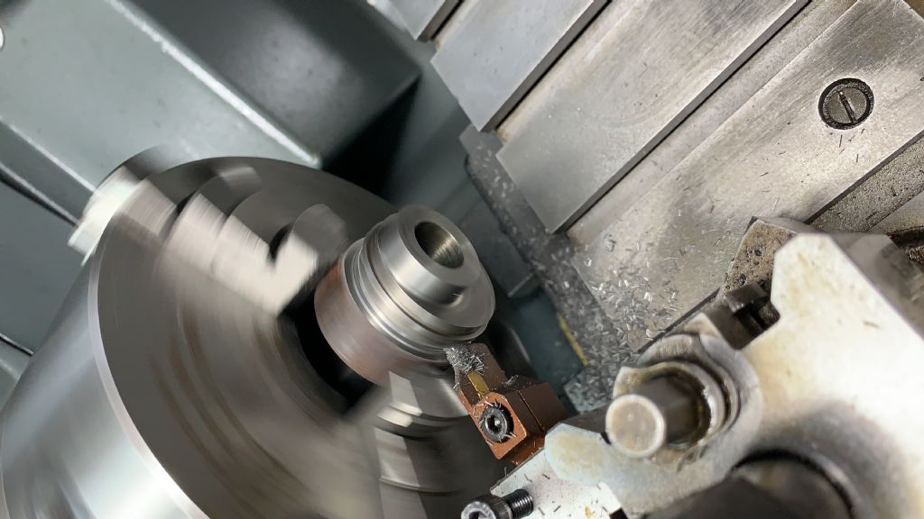

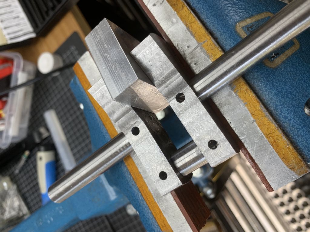

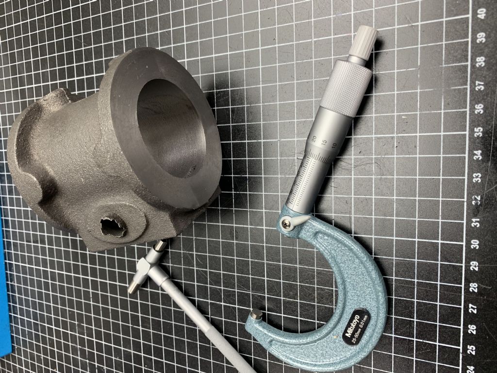

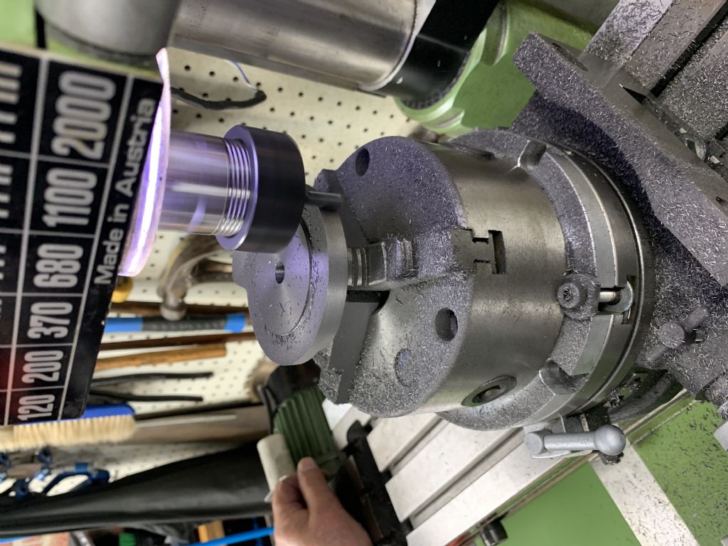

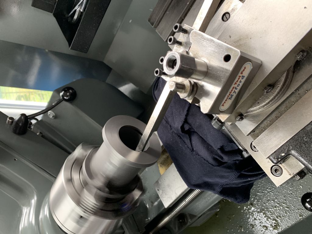

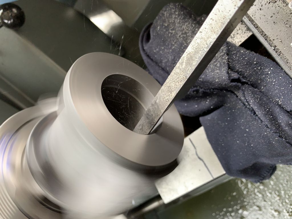

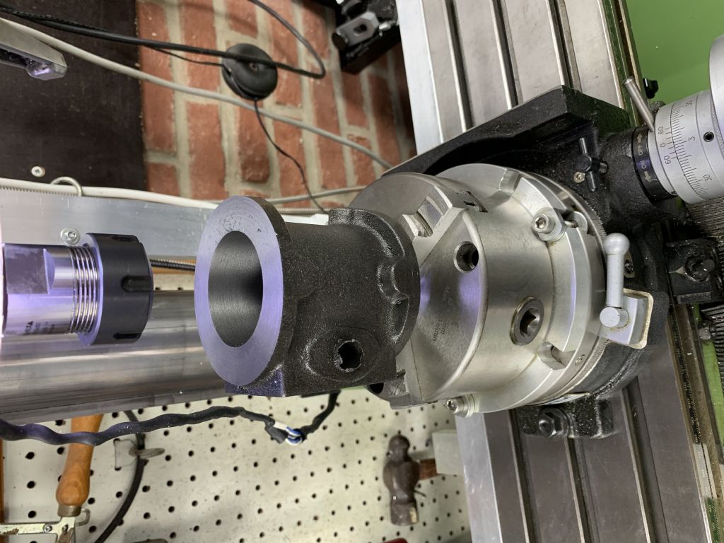

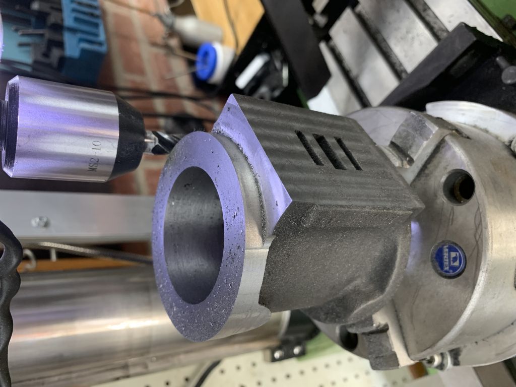

              We have been steadily chipping away at the Stuart. We got the cylinder honed and both cylinder covers done. We also got the crankshaft pinned.
              Overal glad with the progress, no major snags except one which was quite a biggie. Whilst turning the cylinder on the rotary table I was distracted by the neighbour who popped into the garage to see how we were getting on. After he left I got back to the mill and promptly turned the x-axis handwheel instead of the rotary table handwheel! Gave it a good old yank too so the cutter plunged into the cylinder by 0.5mm so to clean it up we reduced the overal diameter of the cylinder to match the notch I'd just cut. Very frustrating!

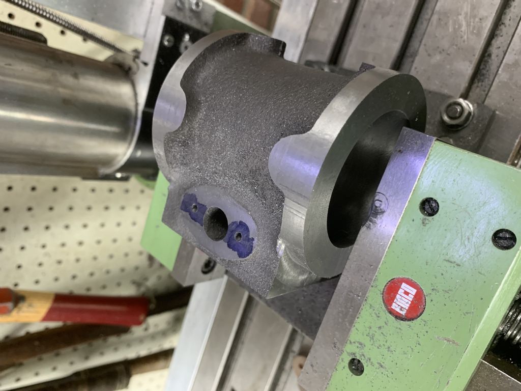

                Mark Gould 1
                  @markgould1

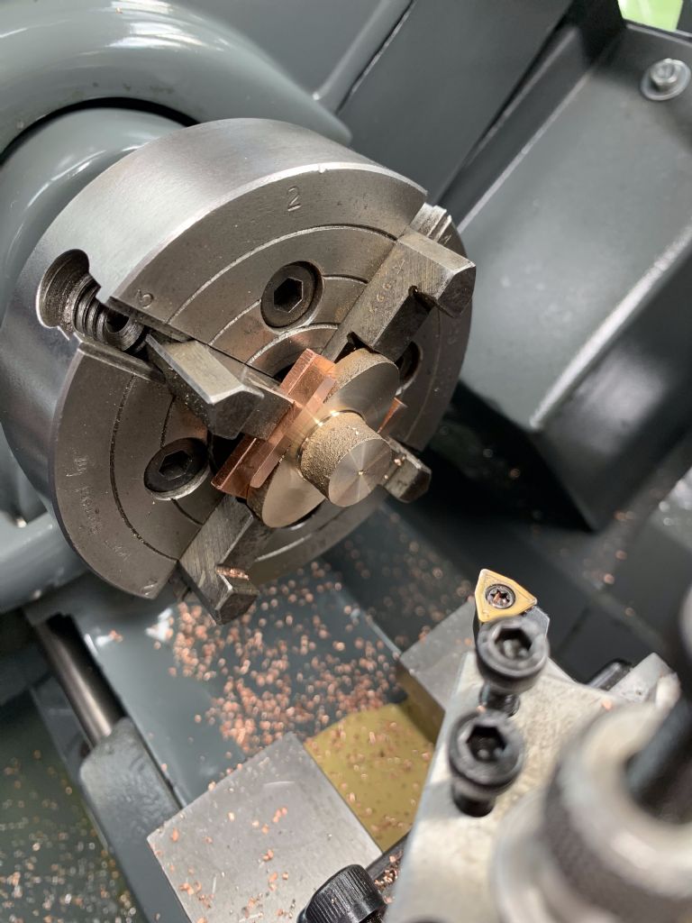

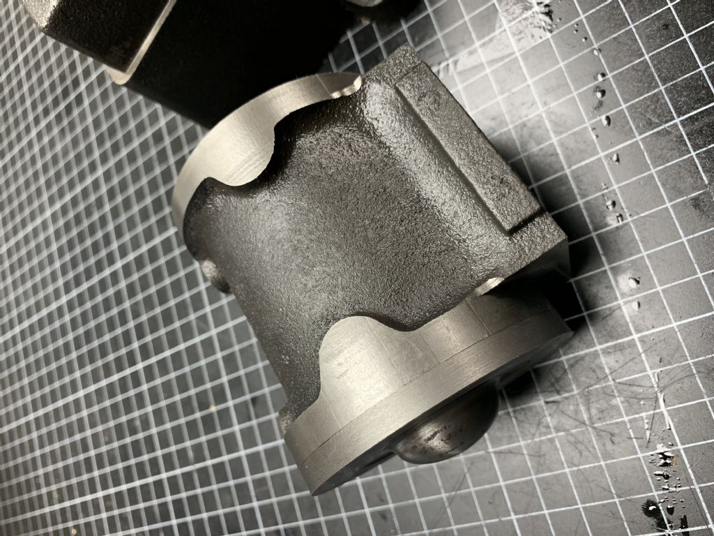

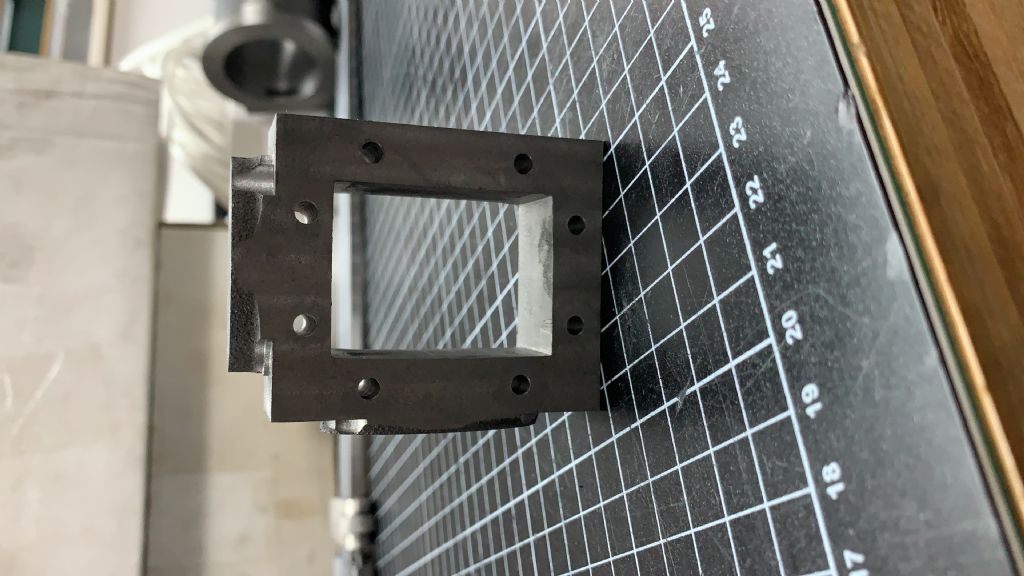

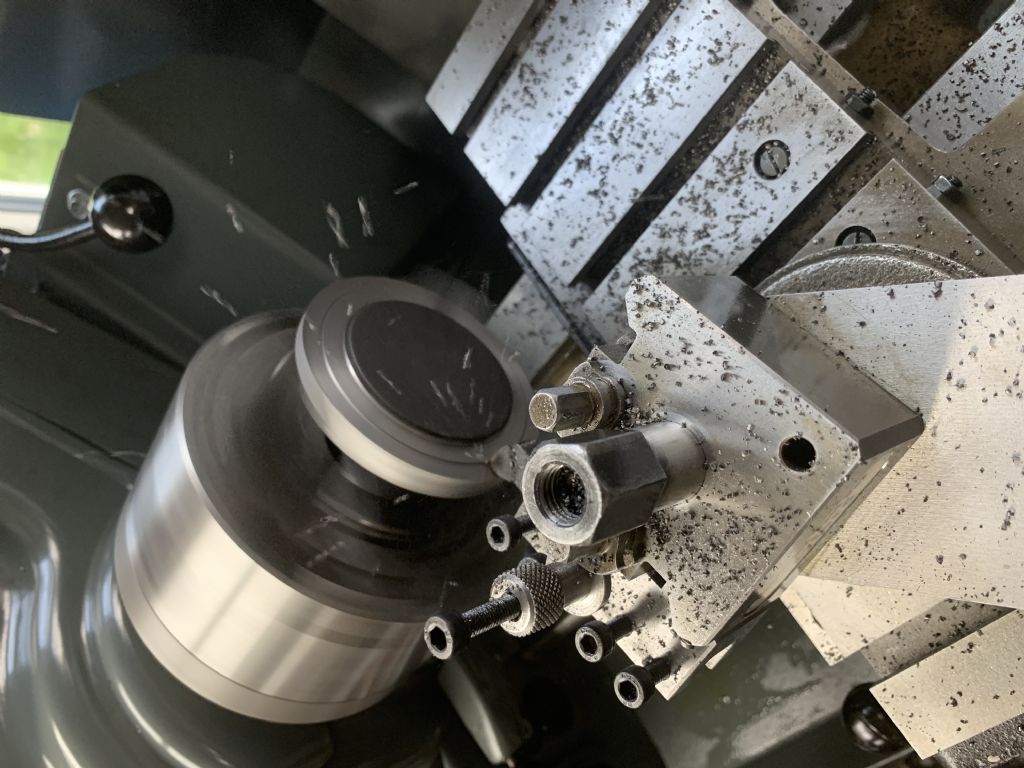

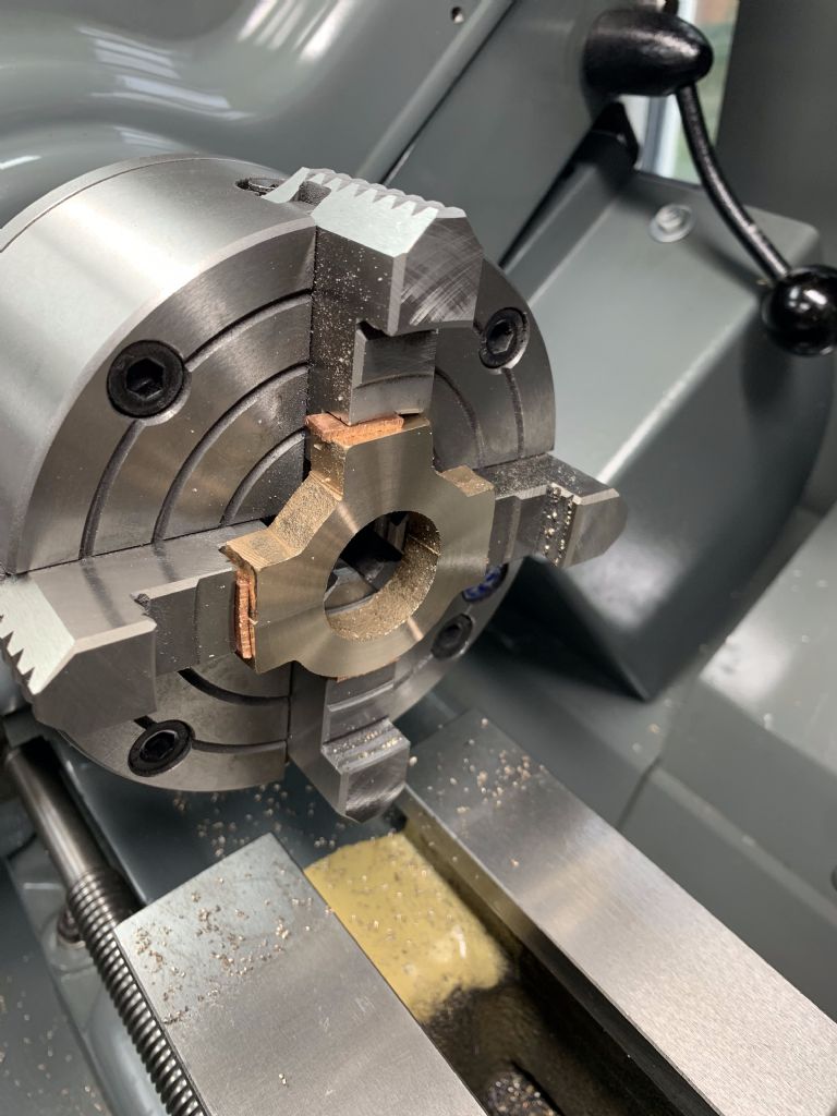

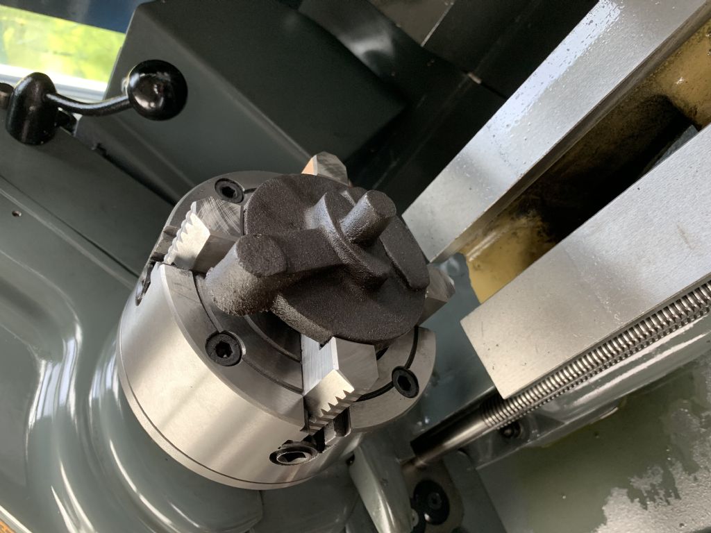

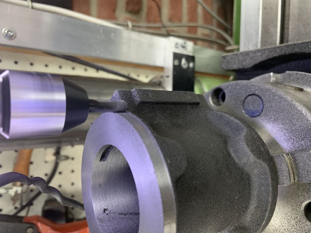

                  Here are some more build pics. It was challenging getting through that hard layer in the casting.

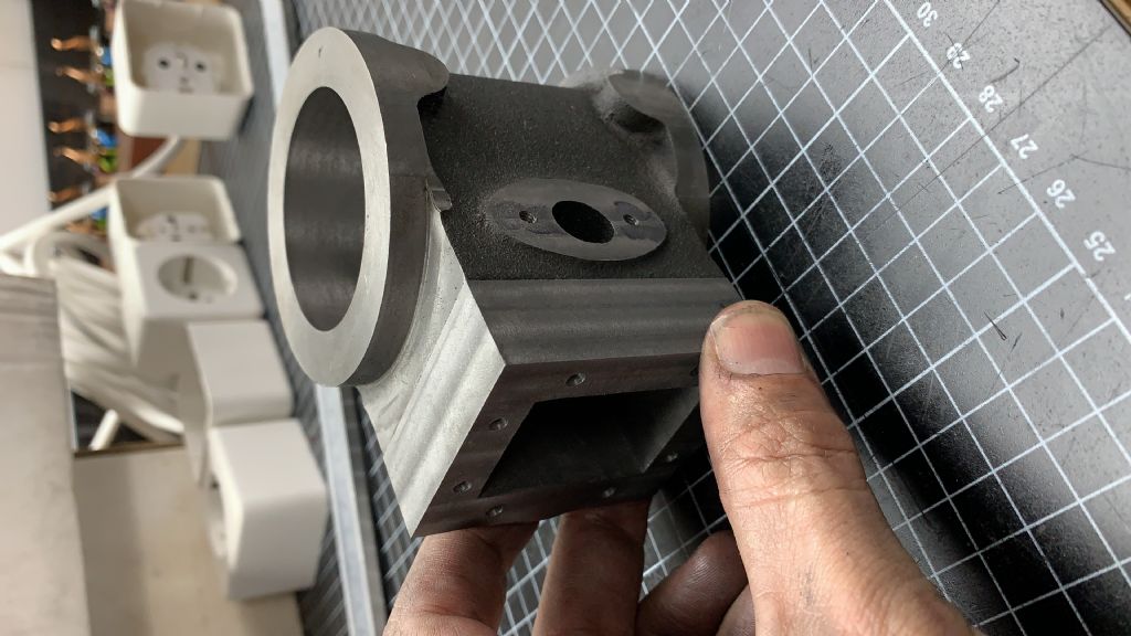

                  #433467
                  Mark Gould 1
                    @markgould1

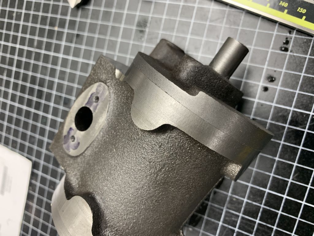

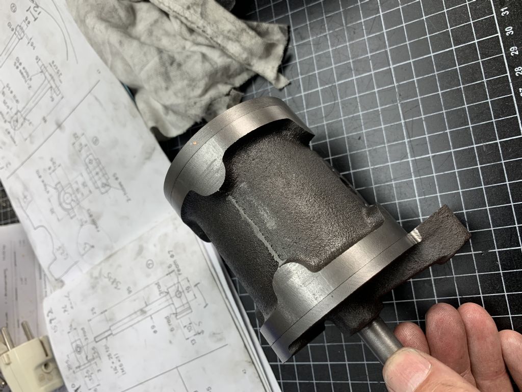

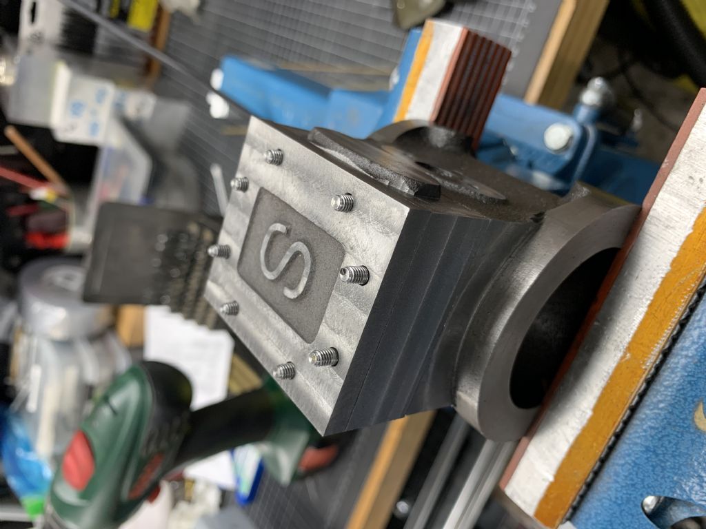

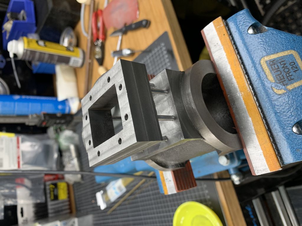

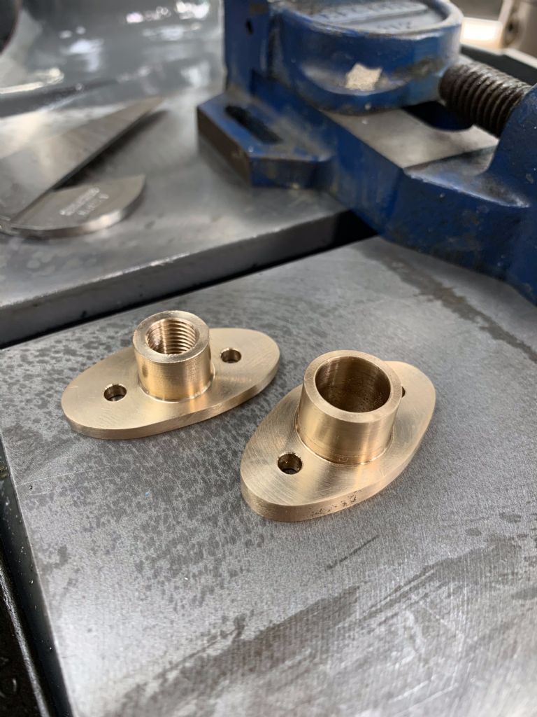

                    We have been whittling away at the Stuart and are getting there. We have completed the steam chest and cylinder.

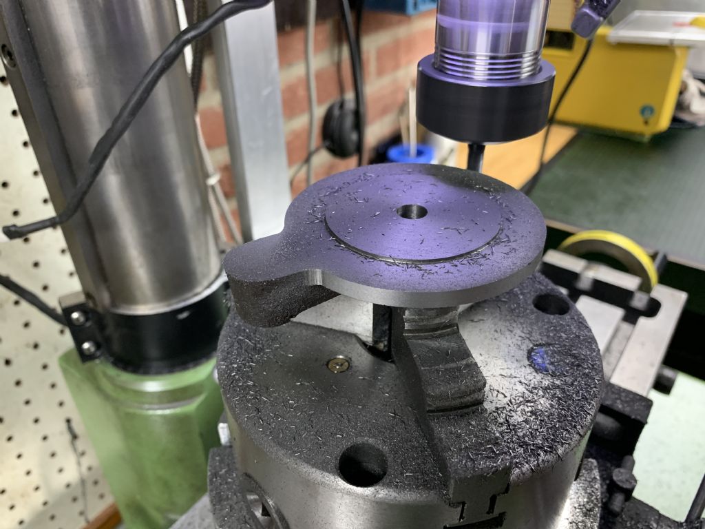

                      We have also done the top and bottom cylinder covers (what a joy a PCD function is on a milling machine!)

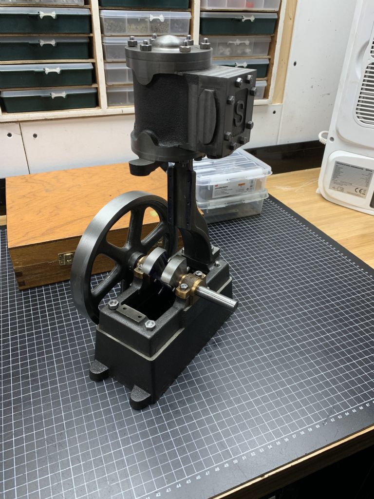

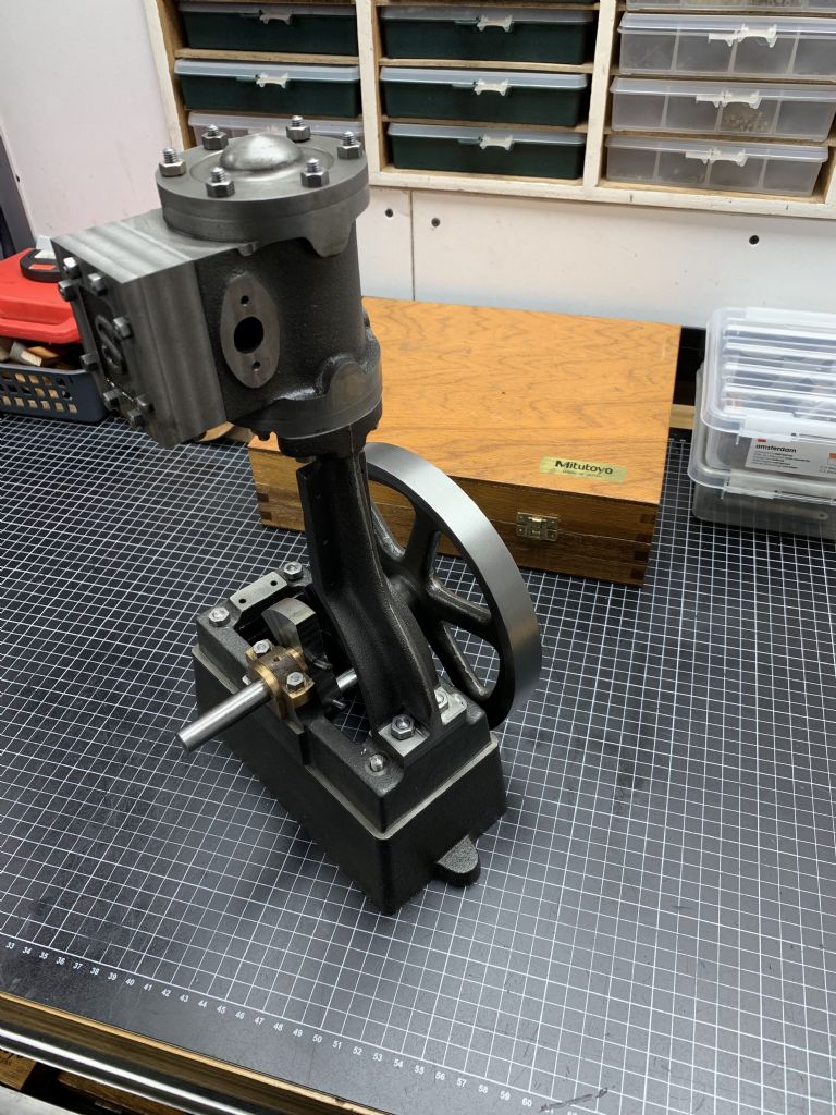

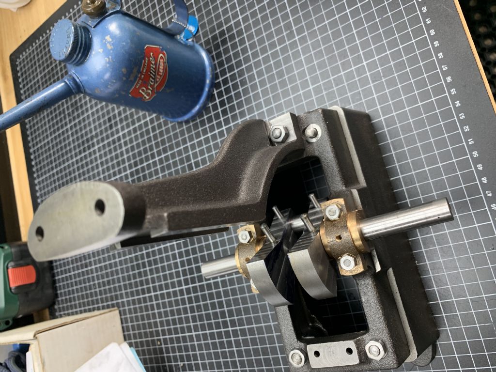

                      #452764
                      Mark Gould 1
                        @markgould1
                        I keep forgetting to uploads the pics. We have basically completed the Stuart No. 1 but I forgot to take a photo of it in all its glory. We have run in on compressed air without piston rings or gaskets and yet it runs nicely. There's probably some more tweaking of the eccentric to be done to make it run even better but thats something I will have to look into.
