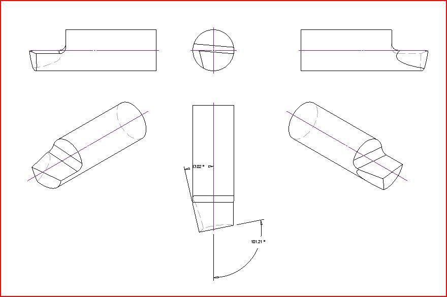

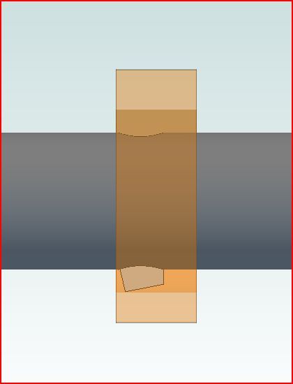

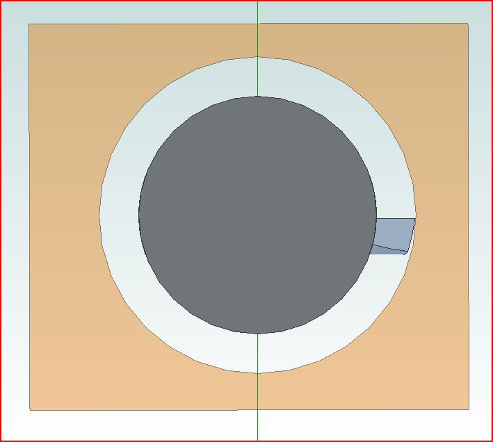

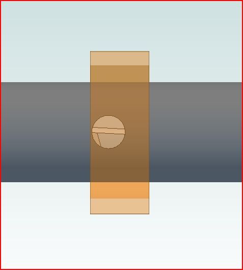

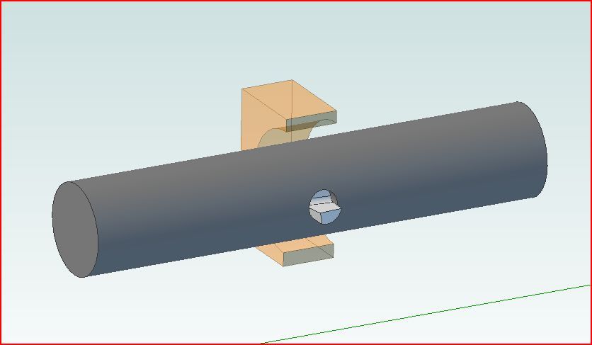

                  #152774
                    Here you go
                    View looking along the bar, hopefully you can see that I have cut the edge back at a radius so it does not run on teh hole below the centre line.
                    A view from above, the work is set to move away from the chuck eg towards the right.
                    Looking horizontally, you can see the slight top rake of the cutter which slopes down from the cutting edge
                    And an overall view, I will e-mail you a PDF of this which you can move about and zoom in on.

                          #152840
                            Just as well I poped in from the workshop.
                            To my eye the one you have done looks a bit pointy and if the cut surface was magnified would be very much line a fine pitch screw thread.
                            If you look at the second sketch I did from above you should see that the front of the tool is about 10deg from a line taken across the lathe and likewise the side of teh tool about 10deg from a line along the lathes axis. When magnified this would give the impression of a much flatter series of Vees and result in a smoother bearing.
                            Yoy can click all of these images to get them larger, I have added teh actual angles to this one I was just eyeballing them when I drew it so don't try to match them exactly its just to give an idea or what to aim for.

                                          #152905
                                            A couple of points about setting teh tool.
                                            I theory with a 3/8" bar and the tool sticking out 1/16" it will measure 0.4375 on the mic and produce a 1/2" hole.
                                            In practice the tip may not be exactly on the central axis, the bar may be running a fraction eccentric or have a slight bend/bow making it cut over or under the calculated size.
                                            So take some measurements of the bore you are produceing and work out how much more the tool needs to be advanced to arrive at the desired size. Its not easy measuring a small bore so find something a bit smaller than 1/2" either the shank of a 12mm cutter or a 15/32" drill and use that as a bore gauge. A bit of maths will then tell you how much to advance the too to get to teh crankshaft size but when you get close do test fit rather than just measure.
                                            On way to set the tool to a measurement is to have the grub screw just making the bit firm, push it out past where you want and then use the mic to gently squeeze it back into the bar, stopping when teh mic reads what you want the tool set at.
                                            J
