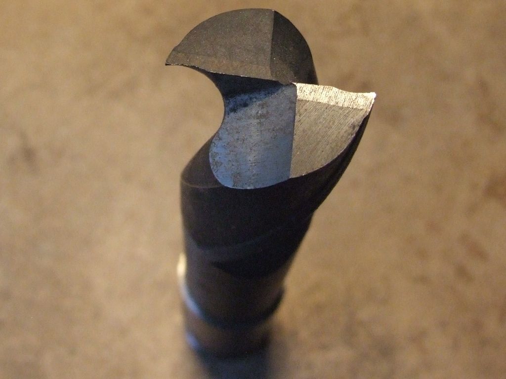

                                Anonymous
                                  Allan: I'm still with you, this is one of the few threads I read regularly.
                                  Hmmmm, where did you get the slot drills? I ask because the ground end doesn't look like right. The end of a slot drill should look like this, no 'bridge' in the middle:

                                      Wow yes, your slot drill looks very different – mine came as a boxed set from Axminster Tools. They do seem to work ok I should say. If it hadn't been for the issue I had with the one that had the shoulder I don't think i would have had a problem this morning. I've not yet had to buy any individual slot mills extra to those to compare..
                                      I didn't know the difference between Hand and Machine Reamers – just been reading up a bit – will make sure i get the machine type. I usually buy from Tracey Tools and I see now in looking they have theirs described as Hand or M/C reamers..
                                      Now having a size to 'ream at' is very helpful, thanks.

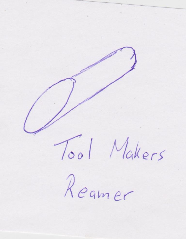

                                              Ian S C
                                                @iansc
                                                If you don't have a reamer the right size, a tool makers reamer can be made . A bit of silver steel (ordinary unhardened steel might do for a one off job in bronze), cut one end off at an angle of about 20*, you can either put a square on the other end, or leave it. Here's a rough sketch I did for someone on another forum. Ian S CTool Makers Reamer

                                                  Hi Ian
                                                  Thats interesting. I haven't even begun to come to grips with things like this especially drill and tool sharpening angles etc. So I don't have a clear picture yet of what constitutes or will work as a 'blade' in 'turning' terms – not the right words but perhaps you get my meaning..
                                                  I often seem to be reading of people boring with broken centre drills, parting off with bits of broken hacksaw blade, turning with broken drill bits etc – at the moment such things would seem to be on a par with something out of the 'dark arts' class at Hogwarts..! I'm hoping some of it will begin to sink in over time..
                                                  Thanks for the drawing, if i see enough of things like this one day the penny will drop – I hope!

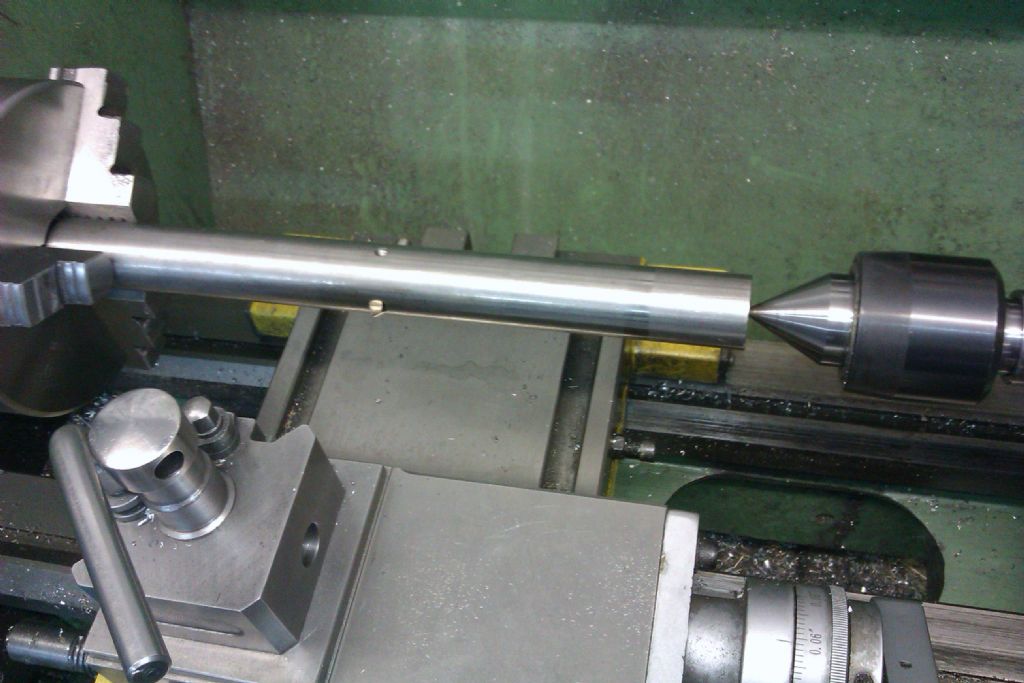

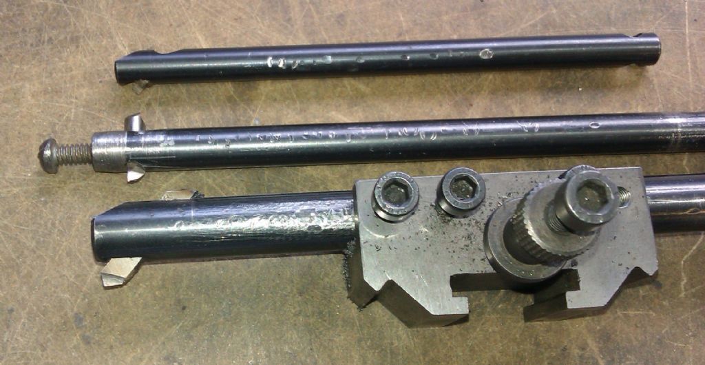

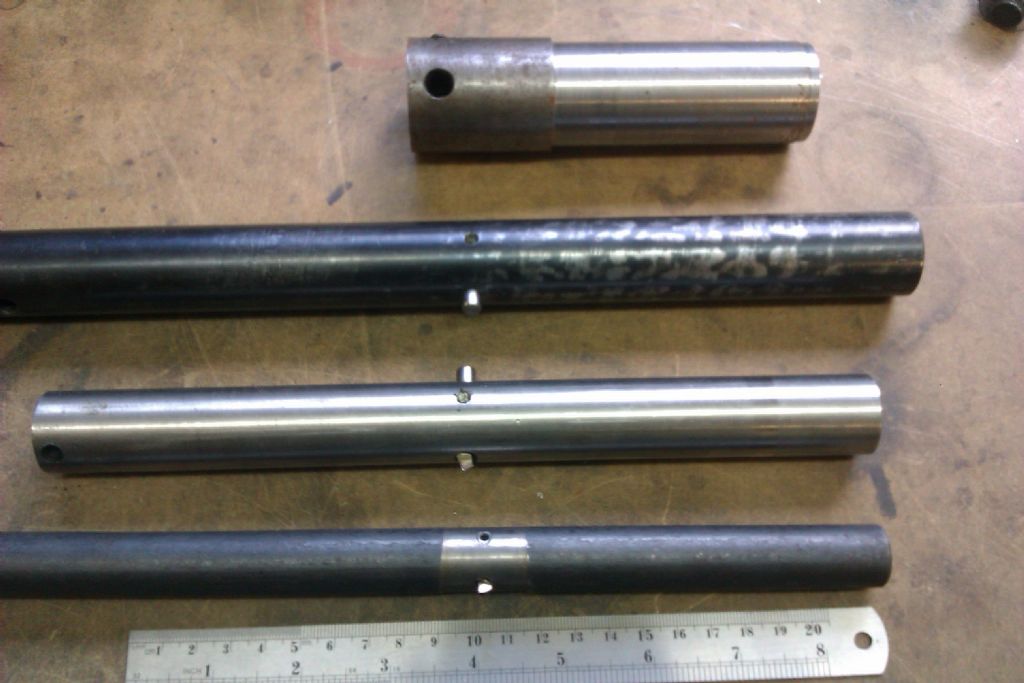

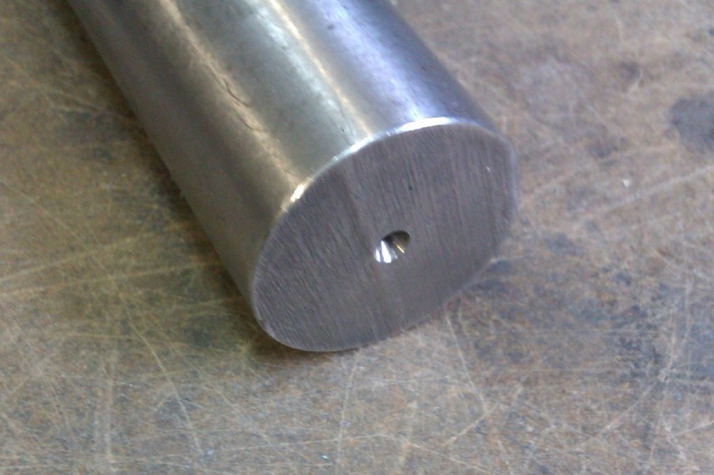

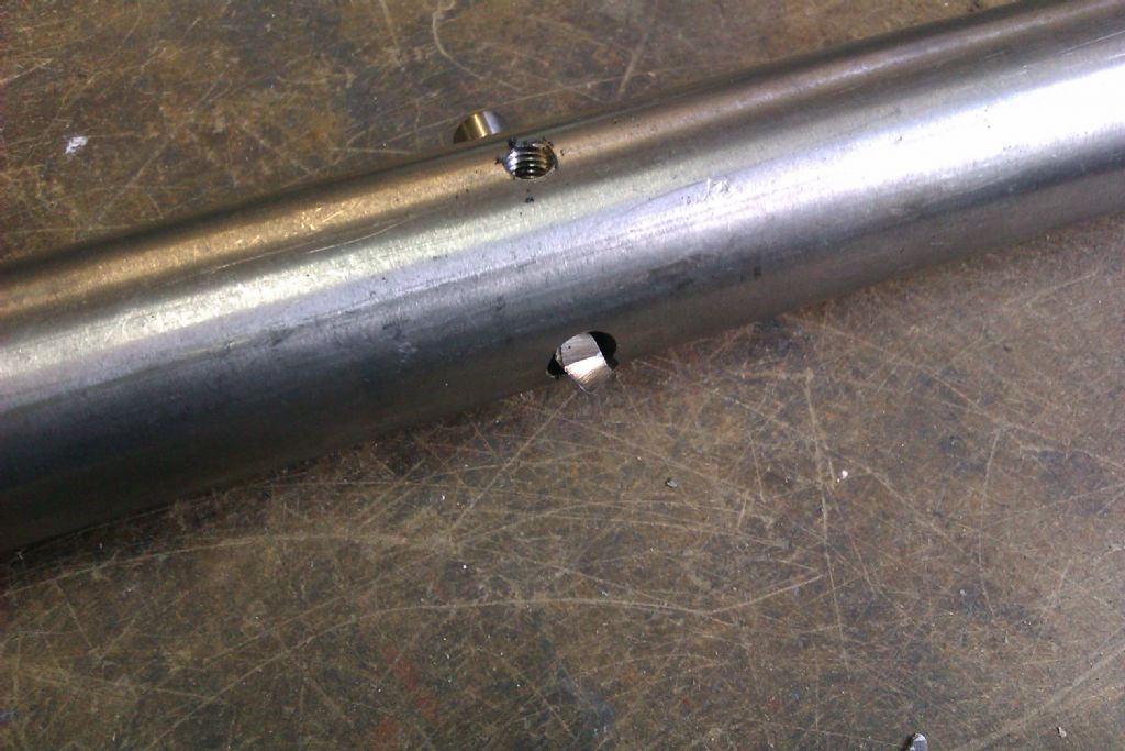

                                                      Well mine are a bit larger than will fit through your pilot holes but the principal is the same.
                                                      A piece of bar long enough to allow the work to pass from one side of the cutter to the other and a bit more at one end to either hold in a chuck or drive with a dog. In your case as the outside face of the bearings look to be about 3" apart I would say a 8" length will do, 3.5" each side plus 1" to hold.
                                                      Cross drill 3.5" from one end to suit the cutting tool, with a 1/2" finished hole you will probably be limited to a 3/8" dia bar so a 1/8" cutter would be about the largest without weakening the bar. At right angles to that hole drill from edge to hole and tap to suit a grub screw say M3.
                                                      Centre drill one or both ends depending on how you will drive the bar and thats about it.
                                                      Selection of bars – 18mm, 25mm, 35mm and 45mm
                                                      Close up of the cutting tool on the 25mm bar which takes 1/4" bits
                                                      Centre drilled end
                                                      And how I tend to drive it using the 3 jaw or a collet depending on whats on teh lathe at the time
                                                      It is also possible to use the single ended boring bars that are usually held in the tool post as single point cutters by holding the shank in a chuck. Only use for short overhangs or to open up prior to using a between ctrs bar.
                                                      You may have noticed that some of the between ctrs bars in the firt photo have also been drilled to take a bit at the end so they can also be used in the toolpost as boring bars.
                                                      If you felt so inclined you could open up the 10mm holes to just over 12mm with the first bar and then make another from 12mm stock to take it out to 1/2". Probably cost youy £2 for bar stock plus a bit of HSS tool bit if you don't have a broken drill/milling cutter and it sall good practice.
                                                      Do make sure the cutter is sharp for the bronze and just take light cuts using the lathes power feed on its finest setting to move the work along the bar.
                                                      J
