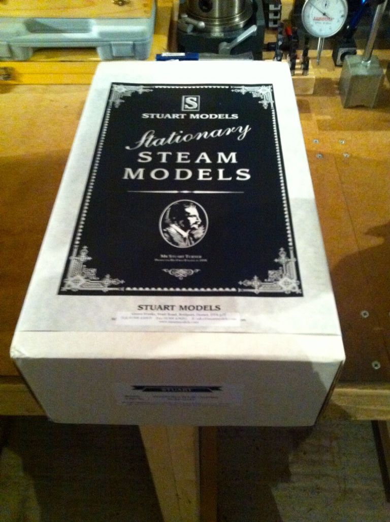

        Back again I'm afraid, this time to have a go at my second project – a Stuart No.1 Steam Engine – following completion of the Stuart 'Victoria', which I enjoyed immensely.
        I believe the 'No.1' was the first model built and sold by Mr Stuart Turner over 110 years ago, sometime during the 1890's – which appeals to my sense of history and add's something for me to the project. It's a fair sized and heavy model and when on a small base should stand about 15 inches high. 'Victoria took about 9 months to complete, the No.1 has much more to it and I can see lots that I'm no doubt going to struggle with – its going to take much longer….
        I don't know how much interest there will be for this on here and I wasn't sure to try and put the whole build up again or just to ask questions when in difficulty, I certainly picked up lots of tips and advice by putting all of 'Victoria' on and so I'll keep my fingers crossed and hope to do the same again with this one – another 'learner project' for me – I would imagine it will only be beginners like myself who may like to follow it and with this in mind I'll try to include as much as possible…
        Thought I should mention that I had a very nice telephone call from 'Tracey Tools' yesterday, I had placed an order for some bits and pieces that I will need for the No.1 and this to say that I had ordered 1/4 inch BSF taps and also 1/4 26tpi BSB (British Standard Brass) taps and that they were the same – did I know and would I like a £12 refund – great service and their goods always turn up next day. Needless to say I didn't know the threads were the same.
        I'm still with my old iPhone for photo's at the moment I'm afraid – its refusing to die…..
        I've made a small start with the Box Bed……
        The Stuart No.1 box arrives.
