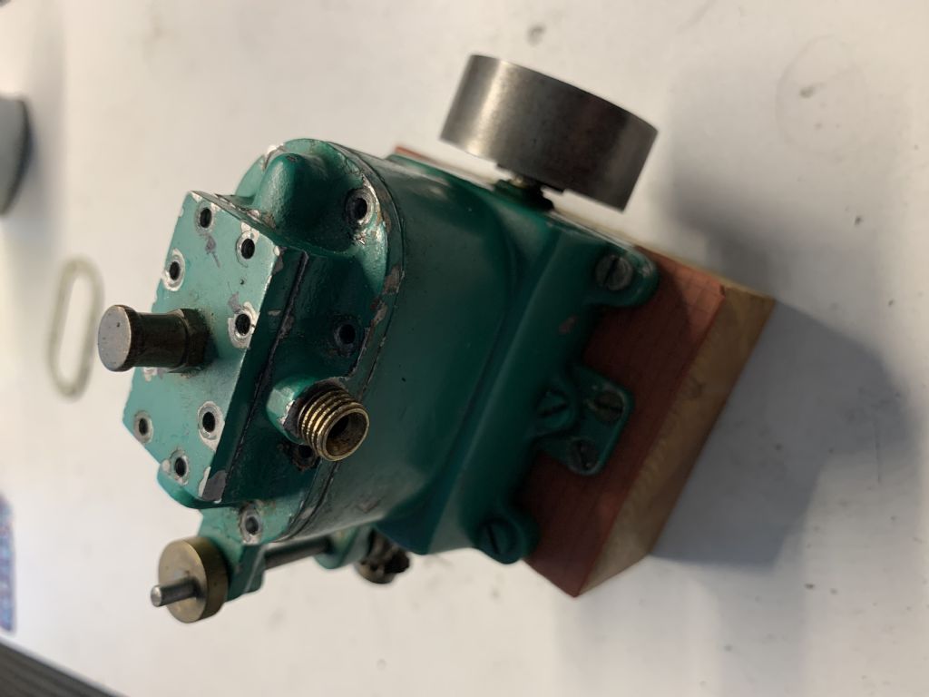

                          Hello,
                          this is my engine. The model is complete even if the photo doesn’t shows the fully assembled engine.
                          Sadly 3-4 threads are stripped. I have to find a solution for this. What would you do? Replace the the existing threats by M3 threats?

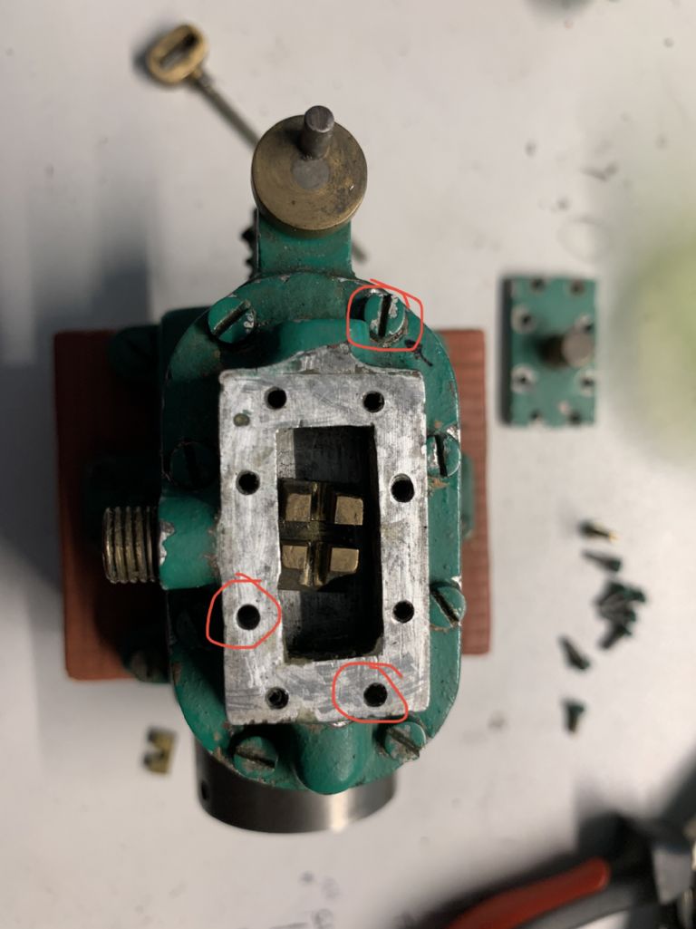

                                    BasKo
                                      @basko
                                      Here are some photos with some marks of the threads which are stripped.
                                      There is enough room for a new thread, but the diameter of screw head will be the limitation.

                                        #554805
                                          If the cheese head screws are original then custom made ones with the same size head and an enlarged thread would be an option, you could stay with Whitworth threads that way.
                                          #554811
                                          BasKo
                                            @basko
                                            Thanks for all the response!
                                            @JasonB: yes, the cheese head screws are original! Thus nuts and bolts would destroy the original look.
                                            I think helicoil or to enlarge the thread is the way to go.
                                            Does anyone know which thread size has been used? br indicated BSW? I would assume 3/32 BSW then.

                                            #554813
                                              Early Stuart engines use Whitworth so I should think that would apply to this engine too. What diameter are the screws?
                                              I'd take a stab at them being 3/32" whit so if making new screws then 1/8" whit
                                              #554816
                                                3/32” BSW is 48tpi … which might explain why they stripped
                                                #554817

                                                    Posted by Michael Gilligan on 19/07/2021 17:10:04:
                                                    And why 1/8" whit at 40tpi may be better than the originally suggested M3 x 0.5 which is almost 51tpi.
                                                    Helicoils would be same pitch as the original screw so still quite fine.
                                                    #554820
                                                    BasKo
                                                      @basko
                                                      @JasonB: die screw diameter is 2.3xmm. Thus I think BSW 3/32 is the correct size. This was also the reason why I thought about rethreating as M3 because the holes needs to be drilled by 2.5mm. But then the engine would have metric and inch screws…
