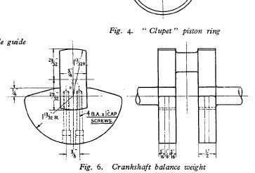

                                    One thing that's noticeable on You Tubes of the No.1 and 10V is the way they vibrate at anything more than very low revs. This certainly affects my 10V, and I think it's due to the absence of balancing webs on the crankshaft.
                                    This didn't occur to me until after I'd built it, but I think if I was starting a new one I'd try to work some balance in.

                                      I made a No.4 and put balance on the crank webs. – They worked well and the engine showed little vibration even at high speed.
                                      But lets remember this is this chaps first build and unless he wishes to actually use the engine at a later date it will probably (and look best) just spending it's life on a slow tickover.
                                      I would advise at this stage for him to stick to the original drawing as much as possible. Lets face it there are countless No.1's out there made this way that spend both working and demonstrating lives. – If he wished at a later date to incorporate 'bolt on' balances it's not too much of a major task with an engine of this reasonable size I would think.

                                          It would not be hard to add balance weights at a later date, easy enough to make then "C" shaped ones with a slot to fit over the rectangular crank webs retained by a screw, this is what is used on engines like the Swan and 5A

                                              I just happened to be looking through an old ME and it seems great minds think alike, similar balance weights to what I mentioned above by a certain K.N. Harris as one of several mods to the St No1.
