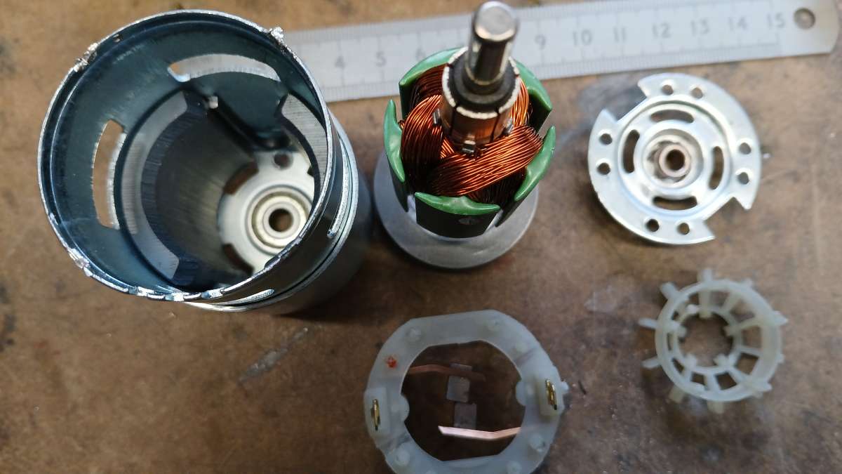

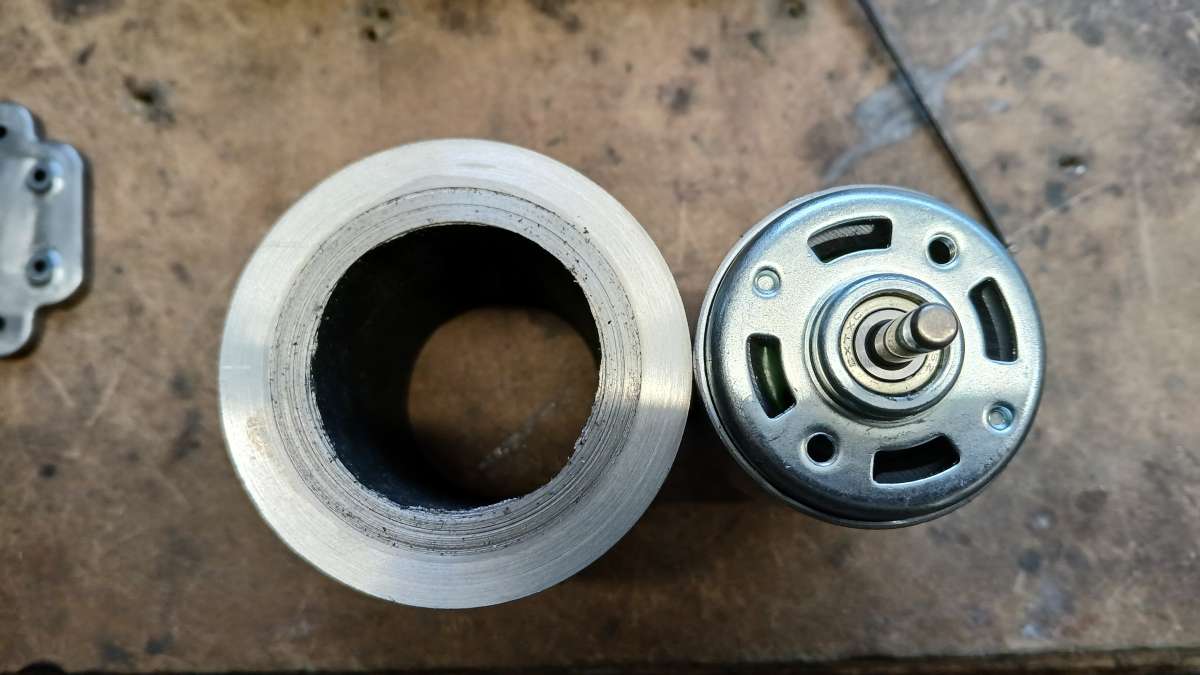

                            I had a look on the net at the P M Research Dynamo and it looks like the fotor an dmagnets are about the same size as a 775 motor, I just happen to have one of those which was a bit small for something I had intended to use it for. Inside of the can is 40.5mm
                            20241026_083652

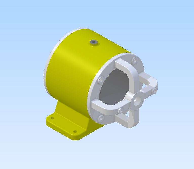

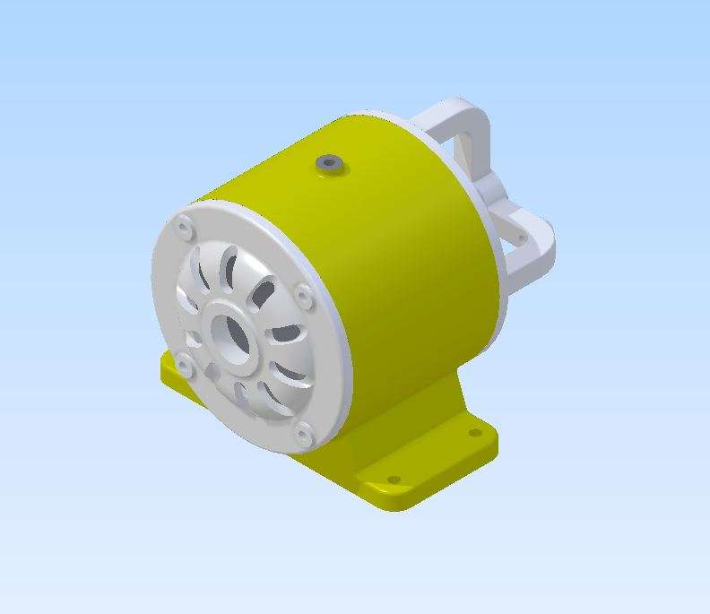

                            So did a quick sketch based on my ideas mentioned yesterday and a bit of 63 x 12.5mm wall tube that I have
                            20241026_085421
                            775 dyno 2
                            The body could just as easily be turned from 60mm solid or go upto 62.5 (2.5″) and there is scope to make the body barrel shaped. Foot just cut from flat bar and screwed to the body from below.
                            The same material can be used for the pully end. This would just be turned on the lathe and the slots milled. The bosses just short lengths of 6mm round bonded into shallow counterbores. Motor’s bearing can be used.
                            775 dyno 1
                            The other end can have the ring turned from the same material as the body. In fact it could all be turned from solid and milled to leave the four supports but I would most likely silver solder four “L” shaped pieces to a central Hub. Again bosses for screws and terminals JBWelded into counterbores.
                            The existing brushes could be used so just a couple of brass terminals to add. magnets have a spring clip that retains them so can be fitted into the new bodyM
                            A quick look at M-Machine and materials including some fixings and a tube of JBW would be around £36. A doner motor £10 so lets say £50 all in.

                                Before dismantling stick it on a meter and see if the idea has merit eg suitable output, or better mount on a base and run with the intended engine. Jason that motor would seem perfect to use with a bit of scaffold tube, ID 41.5mm or so The casing and magnets will fit inside give or take a bit of fitting, tube OD 48mm ish. The brush plate will fit inside the cast cap after machining as will the bearings, a pair of through bolts and the job would seem done ? as a commutator is being used the output will be a lumpy DC, voltage will be determined by the rotational speed.
                                My  reading of ME V2 last night did talk of the need for correct positioning of the brushes to avoid arcing and heating losses though not sure it matters in this case. Great thank you. Noel.

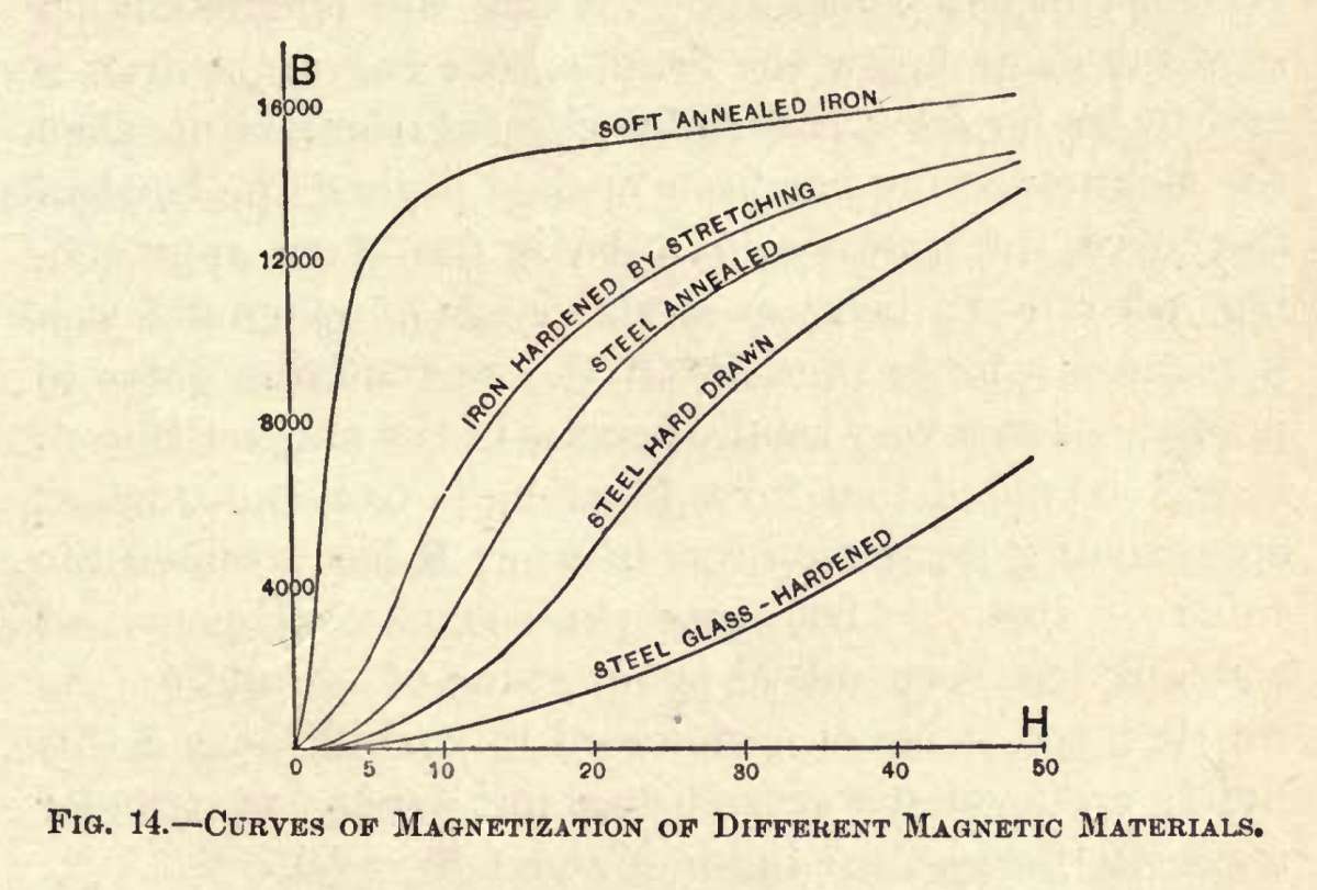

                                                    My find of the evening:
                                                    Lectures on the Electromagnet [1891]
                                                    https://archive.org/details/lecturesonelectr00thomrich
