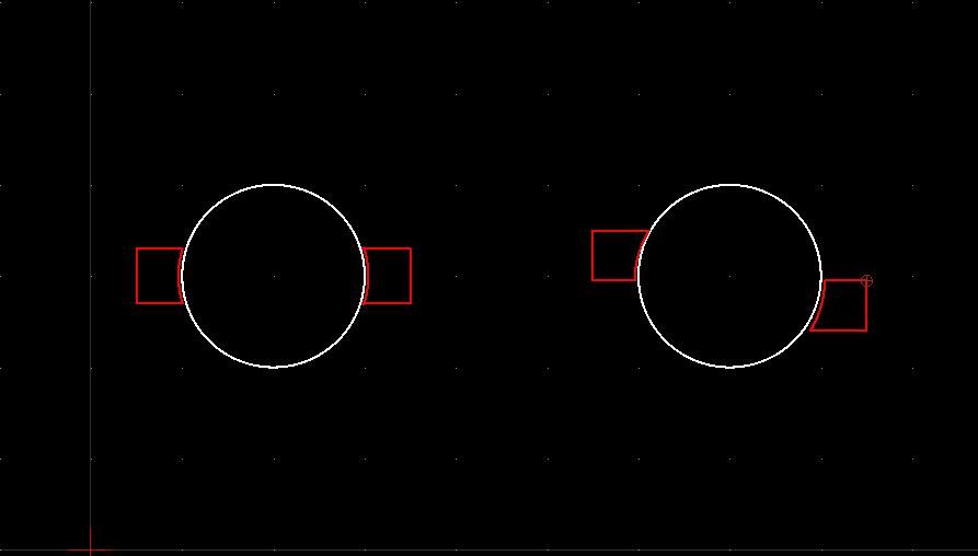

          I've never seen a Stuart Dynamo, but if the brushes are angled no as they would chip off the leading edge in reverse. If they are straight, I can't so a problem other than the polarity of the terminals. John

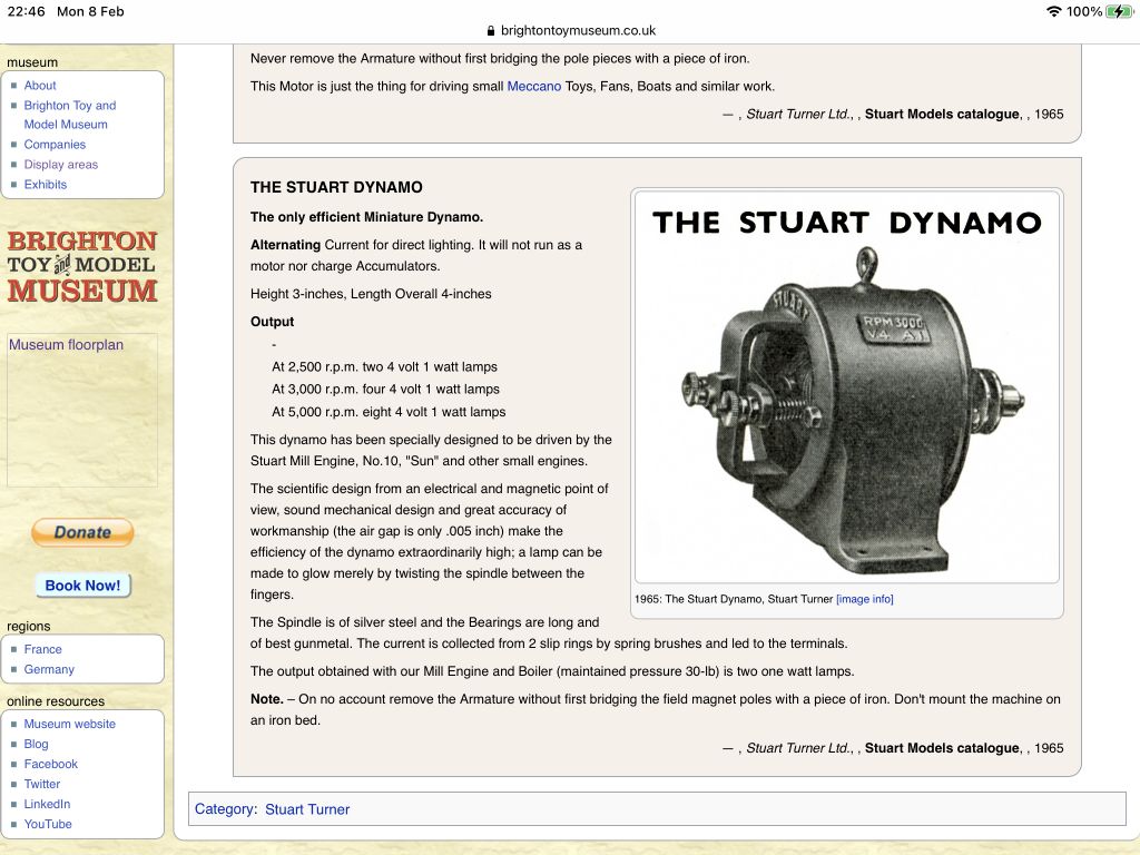

                  The spare parts list mentions a magnet which suggests a PM field., in which case it will happily run either way but polarity will reverse.

                      I think so too, but some DC motors have offset brushes, which improves efficiency, and running them in reverse damages the brushes. The drawing is exaggerated but if the brushes are offset as shown on the right, don't run in reverse.
                      Is it likely a Stuart Dynamo is designed to maximise efficiency? Probably not! Never seen a DC motor with offset brushes either, but my experience is tiny. They do exist.

                          I thought AC series wound motors can have offset brushes to improve efficiency given the inductance in the windings – and they are not reversible. DC motors uness made for a very specific application may be required to run in either direction so would not have offset brushes. Anyway this is a model dynamo to show off a steam engine, efficiency is hardly likely to be an issue!

                            At the risk of inciting semantic outrage …
                            The ‘Stuart Dynamo’ is an AC Generator:
                            **LINK**
                            So the brushes are in contact with slip-rings, and therefore most unlikely to be damaged by reversing the direction of rotation.

                                My best guess is that the word ‘alternator’ was coined for the emerging Motor Industry, to conveniently distinguish AC dynamos from DC dynamos … but I don’t know by whom.
                                Alternating Current Generator
                                Here’s some more info about the Stuart machine : **LINK**
                                http://www.stuartturnersteam.com/Machines/Bottone/Bottone.html

                                    Excuse the outrage but Stuarts also made two DC ones, which Dave may have been thinking of as Br had not shown which one he had at the time. One was small and intended to be run from the S50 and 10 series models, the other older one was more like Br's in looks

                                              Just out of curiosity does it have brushes at all? Is it really a Magneto, i.e. the armature spins a permanent magnet rather than an electromagnet powered by slip rings? The warning about not removing the armature without bridging it suggests a permanent magnet to me. Doesn't matter: Magneto or slip ring alternator, it should generate rotated in either direction.

                                                    I think it's worth drawing attention to the warning not to disassemble the 'device' without bridging the magnet pole pieces first.

                                                      The advert clearly mentions slip rings … therefore there must be something[s] playing the role of brushes.
                                                      Did you watch the little video, Dave ?
