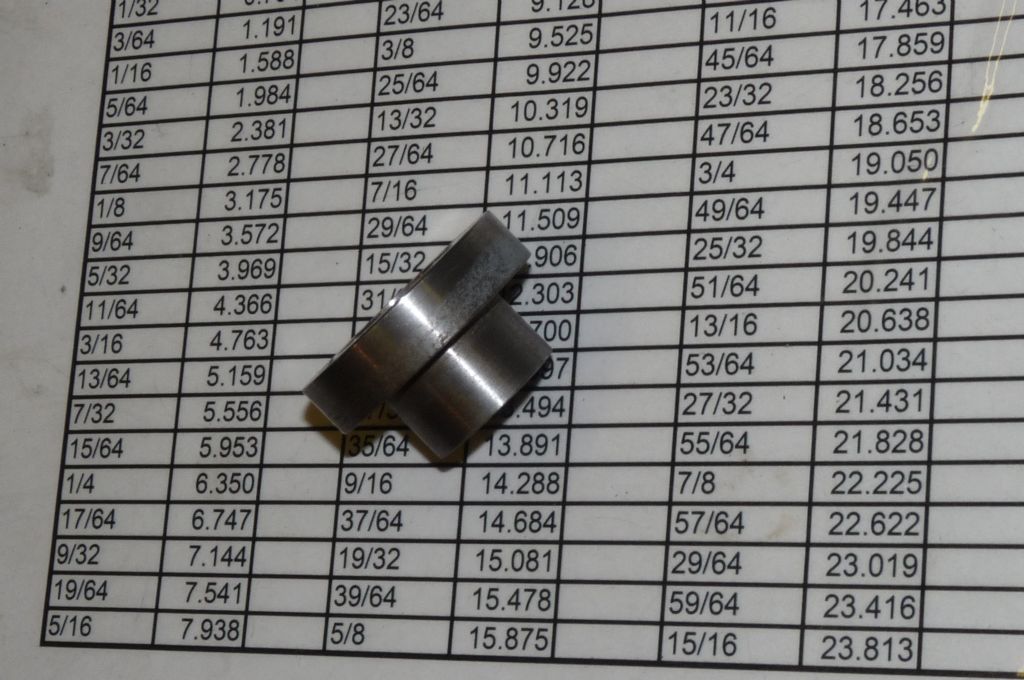

                  I'm on my second Stuart Model and the conversion isn't a problem. Excel will produce a chart tailored to the users short sightedness, which can be laminated and becomes extremely long lived.
                  I usually have a calculator to hand too. I just don't find the conversion an issue.
                  I have a similar chart which is fractional inches to decimal inches,  but never used it.

                        This :- (iPhone app or similar)
                        Plus :-
                        Plus :-
                        Plus :-
                        Half an hour with the drawing and it was all sorted for my Stuart James Coombes. While doing it I was familiarising myself with the general layout of the engine, which I imagine is time most people spend anyway.!
