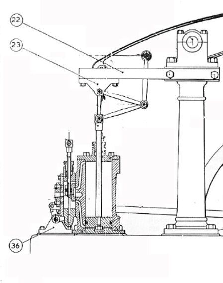

        I wonder if anyone can help. I am refurbishing a Stuart Beam engine following severe fire damage in which many of the brass and gunmetal components were damaged beyond repair. I have remade many of them but am stuck with the entablature arms, item (22) on the drawing below, the radius link bearings (23) and the bearing for the valve spindle (36).
        I have the Anthony Smith guide to building the engine and most of the parts are drawn there but not these. If anyone has the details I’d be very grateful if they could let me have them.
        Best regards
        Terry

          You might find Stuart models will send you a scanned image FoC, rather than charge you for a full paper copy. Worth a try.
          Steve
          #78499
            If no one comes up with a drawing I’ll have a measure of mine for you.

                  Terry are you having a few more senior moments?
                  Just happened to look through the Andrew Smith book and if you lool on pages 5 & 29 you will find drawings which will allow you to make these three items.

                    Terry is this the big Stuart beam engine or the small one, if its the small one I can help you.
                    Unless you’re already sorted

                      Thanks muchly for the offer but the problem is sorted now,
