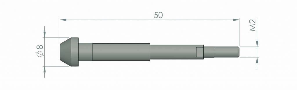

                        I have been making spindles for some small valves from 8mm dia 316 S/S rod. (316 is not an easy material to machine). The end is turned down for a M2 thread. The overhang from the chuck was too much and the rod flexed at the end when trying to turn the full length. The 2mm dia at the end was too small for a centre and the part too small for a travelling steady.
                        Made the part by extending each section from the chuck and turning to finished size, then extend a bit further to finish the next section of the rod. Procedure works if the concentricity of each section is not super critical.  For llengths that are turned in 2+ cuts and dia. not critical, blend joins by smoothing with emery.  (I used an ER collet chuck – MT3 taper in the lathe spindle which is more accurate than my 3-jaw chuck).
                        Paul

                          Lots to go at here. I think my tool is a touch below centre. It’s shimmed up with bits of .8mm mild steel. This may need addressing. I’ll dial it in with the quick change tool post. Jason’s point that it only needs machining at one end is very valid. But I’ve clearly made something else on the engine with that material… I think it’s the piston rod.
                          im going to try and get a good cut on the remaining part with the tool better centred. Clearly what leaves a tiny pip is enough to give a vertical force and bend the rod.

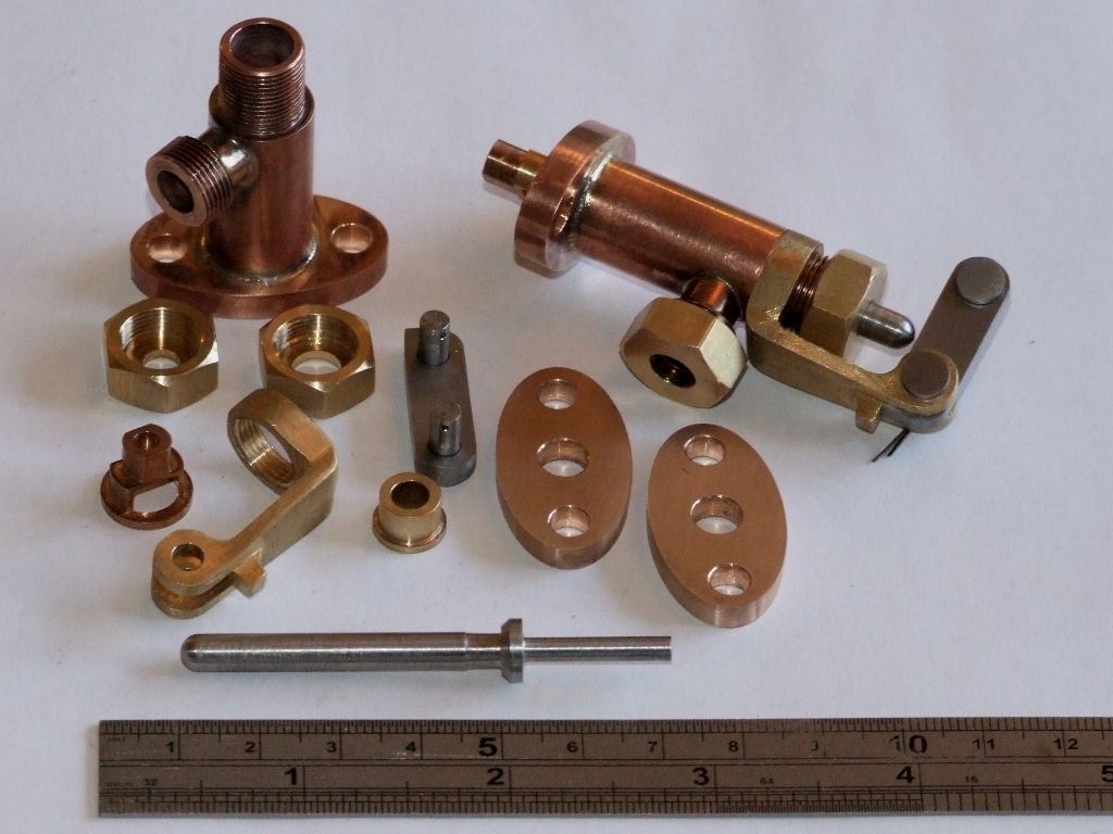

                            In the absence of fancy equipment the simplest way to turn a slender section is in short lengths, moving the work further out of the chuck at each cut.
                            The 1/8" diameter spigot on the stainless steel valve rod bottom left was done using the above method:
