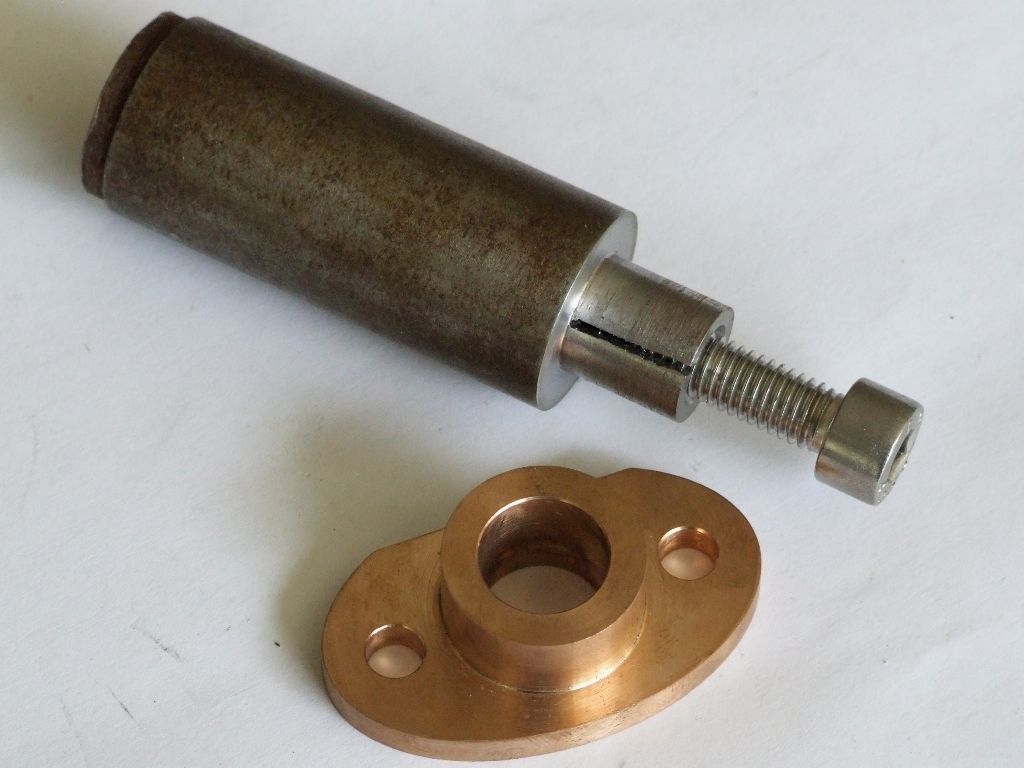

                                  A split bush is easier, and quicker, to make than a tapered arbor for holding work:
                                  The split bush shown was used to face the gland to length, turn the boss to diameter and face the back of the flange. Width of the flange and height of the boss are parallel to better than 0.02mm. A split boss can also provide a high clamping force. Here's one being used to cut a 6DP gear in EN24:

                                    Thanks Andrew, how do you make the bush?

                                            Anonymous
                                              Posted by Dr_GMJN on 16/06/2020 11:46:15:
                                              ….how do you make the bush?
                                              Simples!
                                              Turn the spigot to the wanted diameter and length. If I'm going to be facing I leave the spigot slightly short of the work. Drill and tap the hole. Ideally use a taper tap and only go in a few turns. You only need a couple of full threads and then the thread needs to taper off. So when the screw is inserted it binds and forces the spigot apart. Slit the spigot with a hacksaw. Clean up the saw lines with a needle file. Job done.
                                              Andrew

                                              Dr_GMJN
                                                @dr_gmjn
                                                Posted by Andrew Johnston on 16/06/2020 14:13:00:
                                                Simples!
                                                Andrew
                                                OK great, thanks. I'll try that on some of the other components. I still need to shorten the bearing bosses, so I'll need something like that to hold them.
