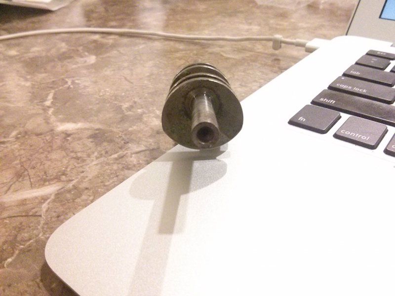

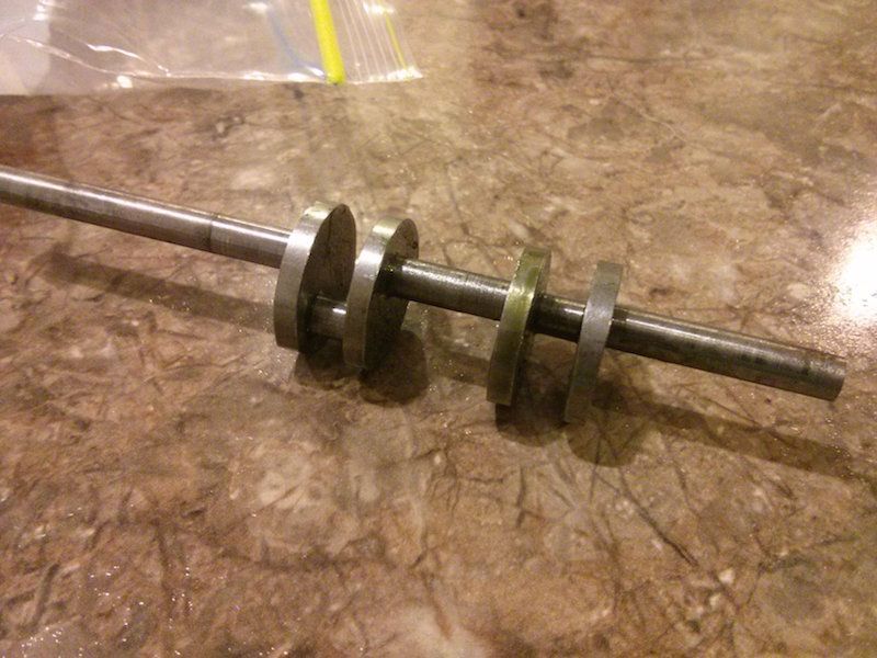

                            I have a D10 question so I hope David doesn't mind a Thread hijack.
                            My D10 is quite old. The crankshaft looks like it might be manufactured from one piece and the crank pins are set (machined) at about 120 deg rather than 90 deg.
                            Does anyone else have a D10 like that? Will there be any problems with an offset like that?
