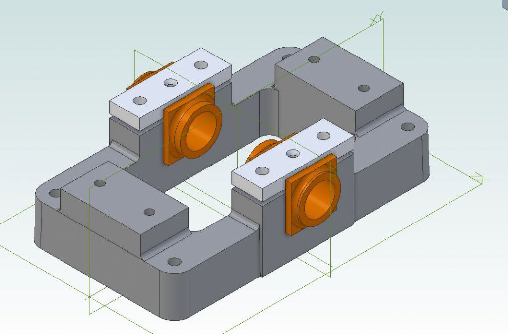

                If all else fails it should not be hard to fabricate abase that looks like a casting, this is one I drew up for someone who was missing it from some 10V parts they had
                Built up in a similar way to this one of mine
                Who's to know what's under the paint

                  When I said in my previous post "just add 1/4" to the 1/2" dia. – – – – " I was thinking you were talking about the spacer not the whole lever but making the whole reverse lever out of the solid would certainly be a possible solution. Wouldn't actually be much harder as the casting (which is malleable iron and machines pretty much like steel anyway ) needs to be machined all over.
                  As far as fabricating the bed plate for the 5A, that's definitely possible but where I live it is next to impossible to get raw materials.
