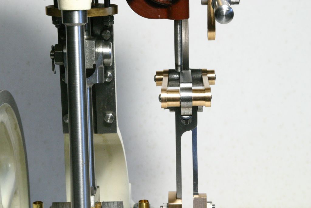

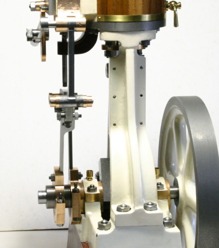

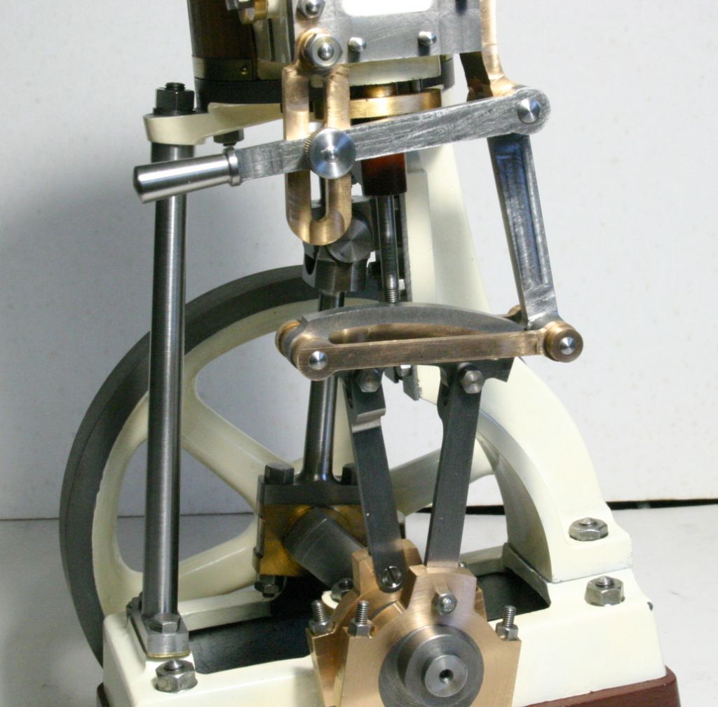

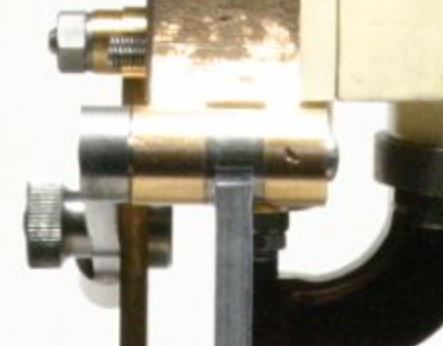

              I've finished all the parts for the reversing gear for the ST#1 except for the valve rod head and the die block. On doing a trial assembly there is a problem. The valve rod doesn't line up with the expansion link. As can be seen in the picture below the link is a good 5/32" further out. I have an idea how I can fix it by making 2 new parts but I was wondering if others that have made the #1 reverse gear have had the same problem and how they got around it. The valve chest and cover and all the parts of the reverse gear are dimensioned according to the plans.
              #585840
                Can you post a side view that goes a bit lower down so I can see the eccentrics
                #585853
                noel shelley
                  @noelshelley55608
                  Looking at mine I would say that the eccentrics need to be closer to the crank throw to make everything line up, it might be just that simple ? Noel

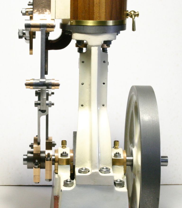

                    Here are a couple of more pictures with different views. The first, Jason, is from the back and shows that with all the reverse linkages lined up the eccentrics are spaced out on the crank shaft and the valve rod and the expansion link don't line up.. The second shows the eccentrics moved in on the crank to line up the valve rod and the expansion link, but now the reverse lever is spaced out from the rest of the reverse linkage. The position of the reverse lever is fixed by its fastening to the slotted link which is bolted to the valve chest cover. The obvious fix is to make a longer 1/4" pivot pin and a spacer between the reverse lever and the rest of the linkage. But my question is have other people had this problem or am I missing something, or are the drawings of the reverse gear in error?

                      John, have you checked that your valve rod ctr is 2 1/8" from the cylinder ctr to match the 2 1/8" centre line of all the valve gear? First picture looks like you have the valve gear too far away from cyl ctr as it should come about 1/2 way over the side of the chest cover

                        John Purdy
                          @johnpurdy78347
                          Jason
                          I had previously measured the valve chest cover at .250" and the valve chest at .750" as per the drawings. The valve rod is in the centre of the valve chest, ie. .375" in from either edge. Cylinder bore is 2.000". I've just taken off the cyl. top cover and the measurement from the outside of the valve cover to the edge of the cylinder is 1.752". Therefore cyl. centre line to valve rod centre line is 2.127", close enough to the drawing dimension of 2.125"
                          Yes that's the problem, if I move the whole reverse gear assembly over to line up with the valve rod then the reverse lever doesn't line up with the rest of the reverse assembly as shown in the second picture above.

                          #585945
                            As noel says it looks like you have the vertical link central in the bracket as the bronze either side looks to be the same width but it should be offset.

                            #585946

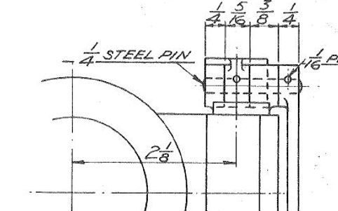

                              No that's not the problem. The outer boss on the support fastened to the valve chest which supports the vertical link is .375" wide as per the drawing ( the other side is actually about 5/16 not 1/4 as the drawing but it is in the wind so to speak).
                              #585955

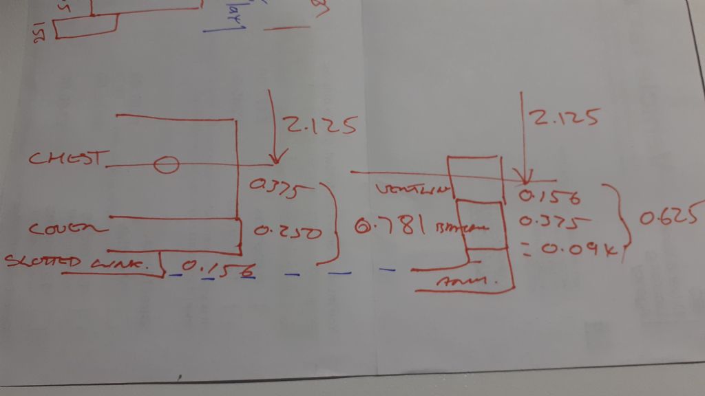

                                Got it. Sizes on the drawings don't add up.
                                If you take the bracket first then from the ctr line you have half the 5/16" which is 0.156, bracket 0.375" and the 5/32" arm thickness off of the levers 1/4" boss leaves 0.094" to the inner edge of the lever. Total 0.625"
                                If you then work out the position of the slotted arm from ctr line you have half the 3/4" chest so 0.375", cover 0.25" and the arm is 0.156" thick. Total 0.781"
                                Difference between the two is your 5/32"
                                I think I would set it up as per your second photo and add a spacer between lever and bracket.
                                Edited By JasonB on 17/02/2022 19:43:19

                                  #585959

                                    Thank you Jason, I'm not crazy after all. I had also added up the dimensions as you have done and came to the same conclusion, but was wondering if I was missing something. I'm sure many examples of this reversing gear have been made to these drawings, how many others have had the same problem and how have they got around it? Are Stuart Turner aware of the errors, are the current drawings the same as ours or have they been amended?

                                      That's my plan. Make a new longer 1/4" pin and a 5/32" spacer between the reverse lever boss and the bracket on the steam chest. Everything would then line up. I was just wondering if I had screwed up of was missing something. It now appears that it is the drawings that are in error.

                                            Got a reply from Stuart Models this morning. Seems they are still using the same plans and are not aware of the problem. Here's a quote from their msg.
                                            "We are still working from the same drawings as you seem to have,
                                            I haven’t had anyone notify me of this issue before, but this maybe that they have worked around the issue.
                                            Will moving the reverse shaft bracket solve the valve rod alignment, also on our engine, there is a spacer between the reverse shaft bracket and the reversing lever, so this may be the get around."
                                            Looks like their fix is the same as I have come up with!
