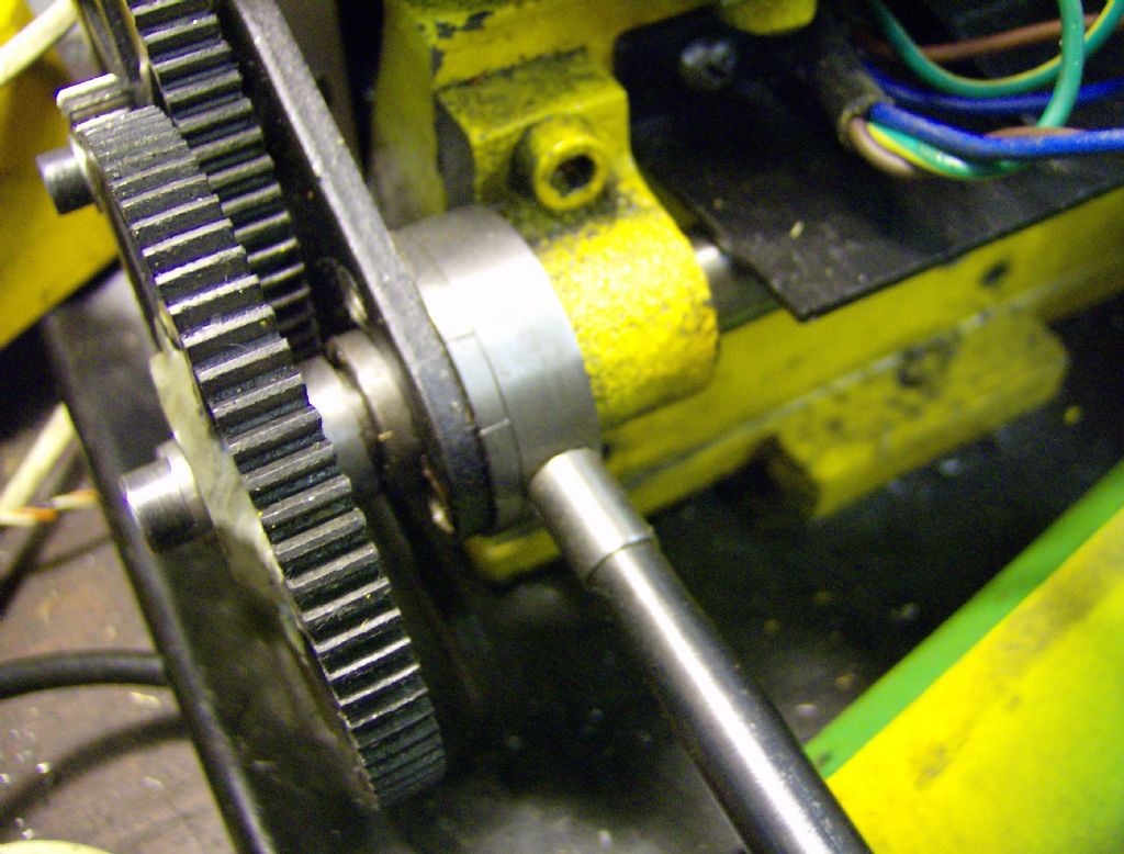

                                    As the Chilean red suffuses into my veins this New Year's eve I am tempted to contribute on a subject beyond my competence. What happened? the words have gone all lopsided?
                                    I made a leadscrew clutch for my mini lathe – irelevant? Perhaps? But I did it by a very simple expedient – the banjo in this case has an arctuate (good eh?) slot which permits it to be adjusted for different gears. I added a bellevile washer and an extended nut so that it can be set so the gear can be moved in or out of mesh and stay that way. I also added a simple arrangement so that a lever (which protrudes through a slot in the gearbox) can move the gears in and out of mesh, just by moving the banjo. A cunning (i.e. too complicated to describe in a state of partial; inebriation) arrangement means the lever can adopt one of three different positions to allow for different gear sizes. Result? A simple clutch that works for both fine feed and gear cutting BUT it does not keep the gear engagement like Gray's masterpieces as you can engage the gears at any relative position.
                                    That said it does make it very easy to securely engage or disengage the gear train without any spanner wangling and probably could apply to any banjo-style gearbox.
                                    Neil.

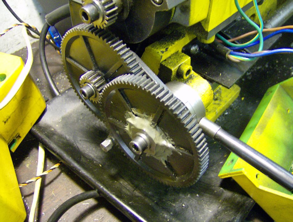

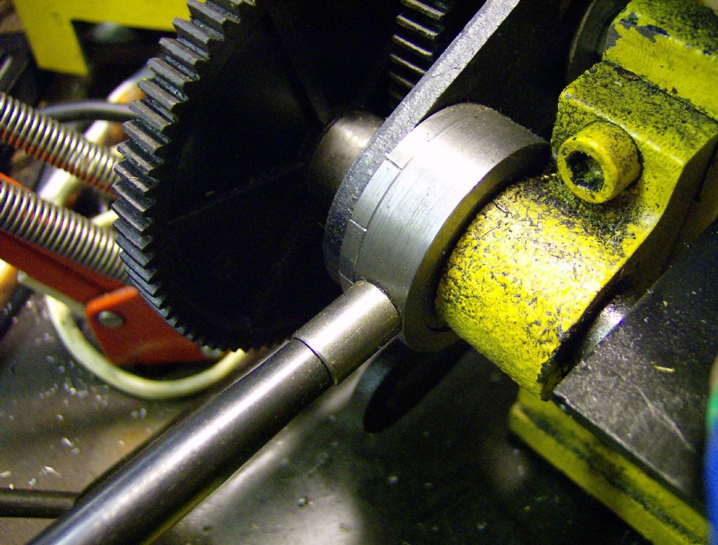

                                        To my surprise there are a few pics in my albums:
                                        The lver just pivots the banjo up and down on the end of the leadscrew bush.
                                        You may just make out two of three countersunk screws that hold the device to the banjo.
                                        The lines on the left hand part show positions where the handle can be screwed in to an outer ring and engage with the inner 'hat' shaped part.
                                        You can see the tiny extended nut that adjusts the grip poking out below the change wheels.
                                        The body filler is just to stop a bush made from hex material rotating in the bore. A kindly chap sent me some surplus plastic chnge wheels when he converted to metal ones so I have a proper one their now.

                                          Neil,
                                          It can`t get simpler than that!
                                          In my last but one post I mentioned that a design may work for you although it doesn`t necessarily satisfy the standards of accepted machine design, and I think that this is such a case.
                                          I`m interested to find out whether your idea will work with the EW and at this moment cannot see too many problems, except that the poor old gears may protest when engaging the drive at top speed. Perhaps the answer is to engage the gears when the spindle is at rest and, of course, the gears may be disengaged at speed with little or no protest.

                                          Sub Mandrel
                                            @submandrel
                                            At the very least it provides a way of stopping the leadscrew reliably without having to use a spanner or reach round the back to play with the tumbler reverse. It really is no different from putting the tumbler in neutral, but it is so much quicker and easier. It also speeds up changing the gear train a little.
                                            I keep meaning to make a super-fine feed banjo with another 80:20 gear pair, to get ~1 thou per revolution.
