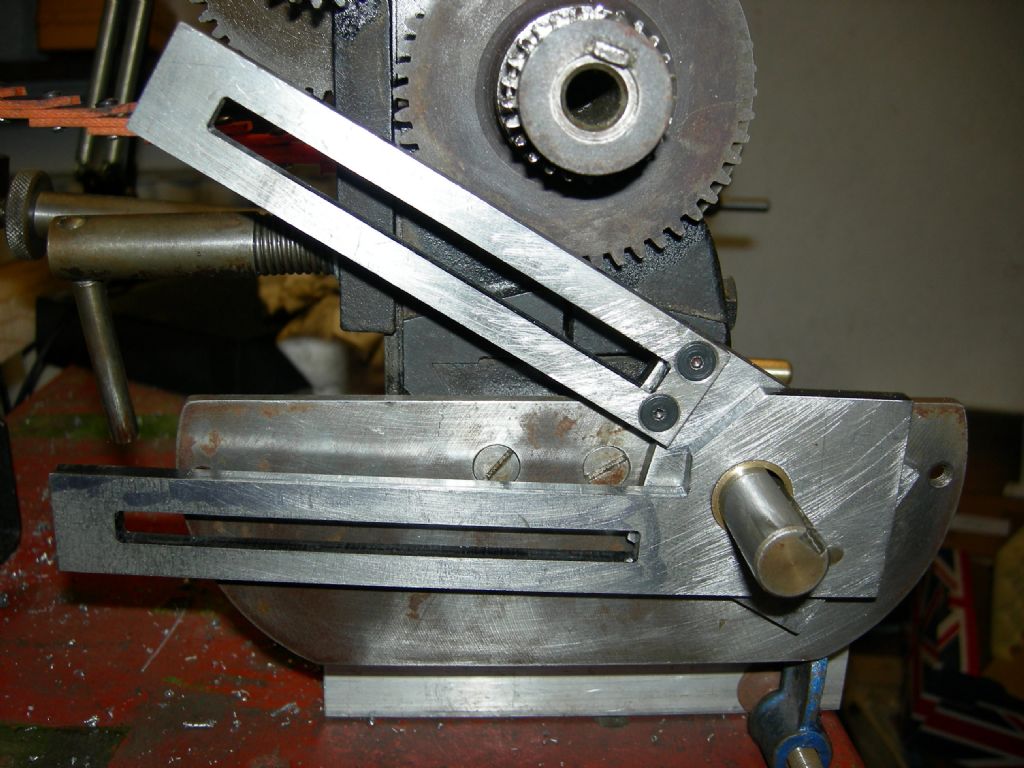

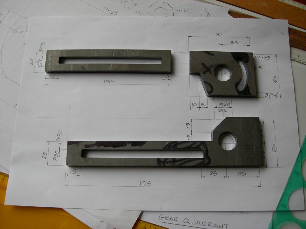

            EWers and bookmarkers,
            I enclose a photo of the laser cut experimental screwcutting quadrant:
            One more step towards the prototype.
            Alan

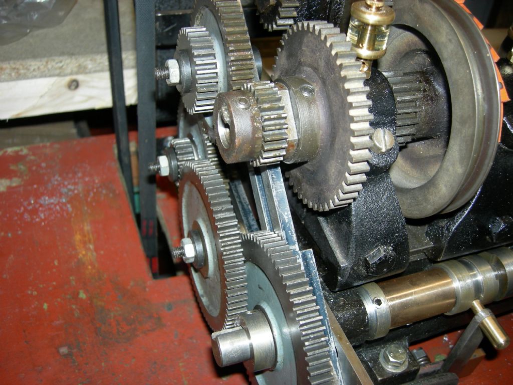

              Herewith the prototype five gear slow feed.
              More info to follow.
              Alan

              #103841
              IanT
                @iant
                That looks very tidy Alan!
                I could hack those arms out of the raw metal (but it would add another thing to my long list of things to-do) – but what sort of costs are involved in the laser-cut solution you adopted?
                Regards,
                IanT
                #103853
                alan smith 6
                  @alansmith6
                  IanT and EWers,
                  The laser cutting cost me £24 but there was a minimum charge so that I had to buy two sets.Sorry but I need both.
                  When you source the laser cutter ask them what the tolerances are on the cut dimensions. In my case the figure was plus and minus .02mm about 7 thou. So that in the case of diameters, you have to make the dimensions so that the upper limit tolerance is below the dimension that you want. this is important on the 3/4 dia holes which have to be reamed and to the slots which do not want to be undersized but about 5 thou plus.
                  Most of the ( metric ) dimensions you can glean from the photo, I can't scan the drawing for you at the moment.
                  You will be glad to know that preliminary tests were successful with smooth and quiet action.
                  Alan
                  Edited By alan smith 6 on 16/11/2012 11:08:16

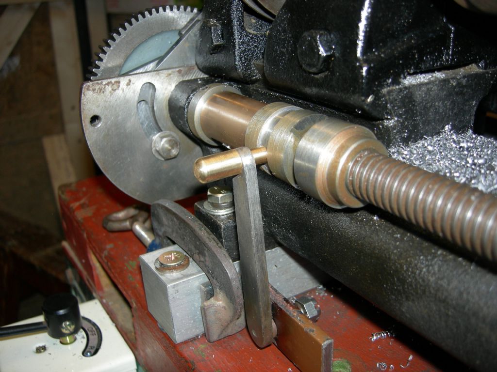

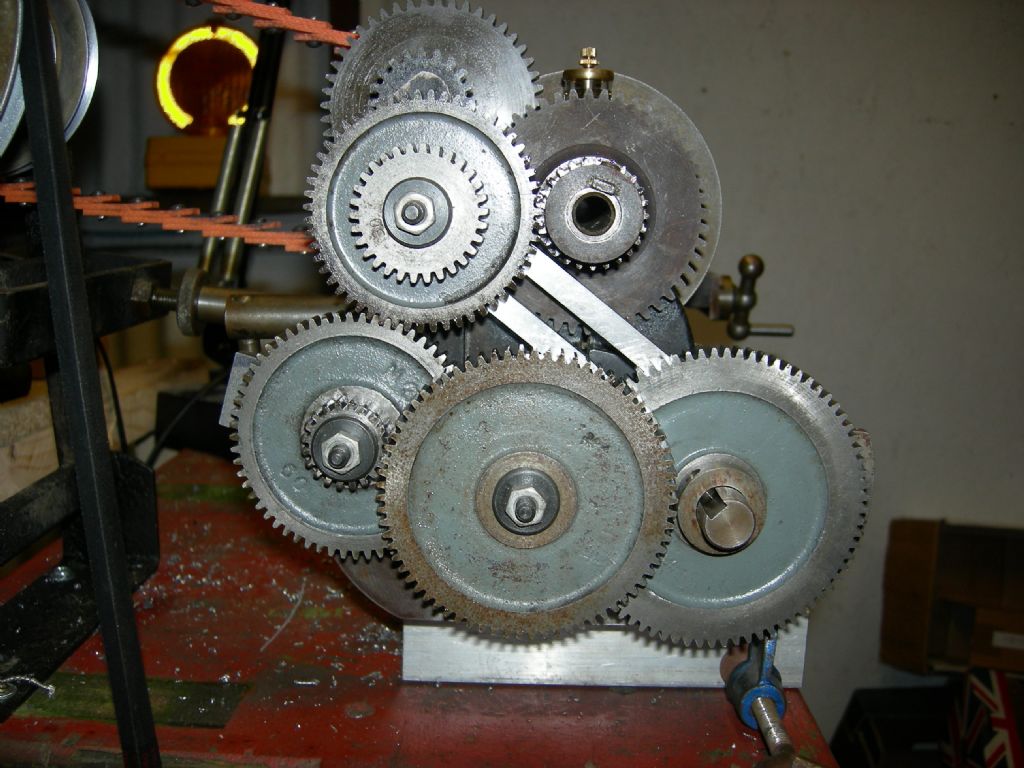

                    Just a word about the state of play of the slow speed and clutch:
                    When adding the gears to the quadrant I found out that I was wrong about the 20DP 20 tooth gear, the pin radius at the EW spindle collar is too large so that the pin hole breaks out at the gear tooth base diameter.
                    The answer is to substitute the 25 tooth gear which is OK.
                    I will be talking about the overall picture for the gear train in a later posting.
                    I was very pleased at the outcome of the gear train prototype, I used myford gear studs which I modified to suit the new EW quadrant. These studs were purchased from a well known tool supplier and looked OK but when it was time to fit the gears I was horrified to see that the keyed barrels which carry the gears were grossly undersized, varying from -12 thou to -25 thou.
                    As I was all set up to run the gear train on the lathe I continued the assembly and set it in motion and was rewarded with a smooth running and quiet train.
                    The next thing was to try out the leadscrew clutch, with the operating lever temporariy clamped in position I started the lathe and saw that with the clutch in the disengaged positon the friction in the clutch was turning the leadscrew.
                    Then engaging the clutch, I set a cut on a piece of mild steel and again was gratified to see the metal being carved away.
                    Obviously there is a problem with the clutch that needs to be addressed, which I will do soon.
