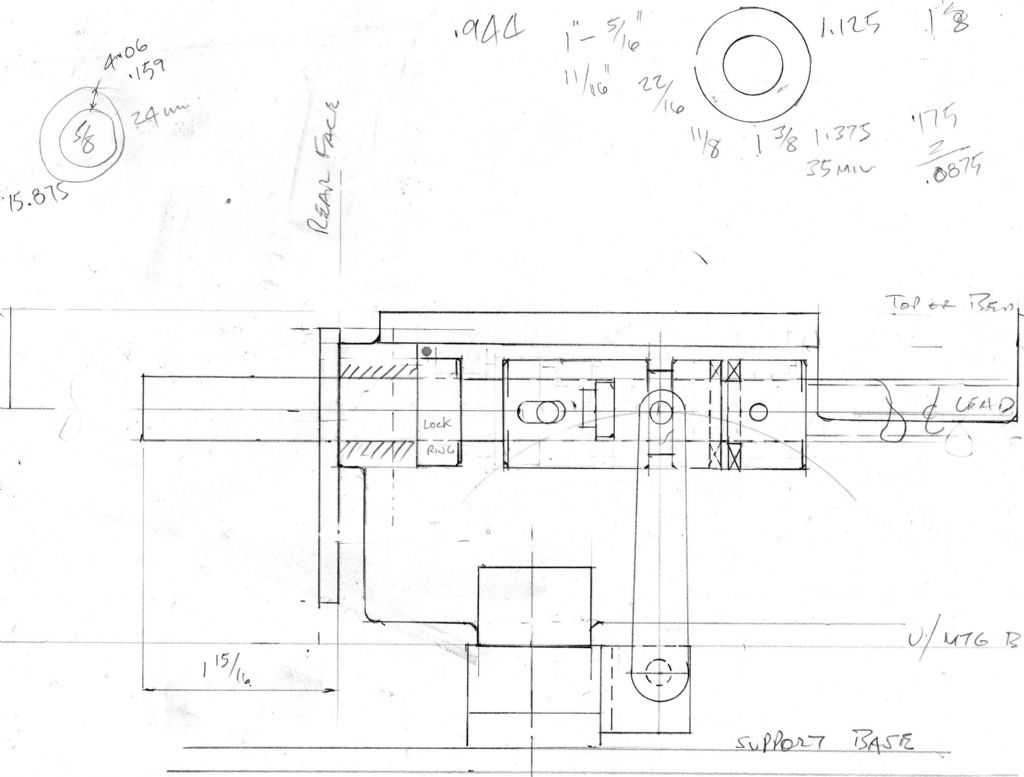

                        #99594
                        alan smith 6
                          @alansmith6
                          Hi EWers butterflies and others,
                          Just a word of explanation about the rather chaotic, back of a fag packet, sketch that I posted:
                          This sketch is based on Martin’s ideas. What I have done is to bring the design of the lathe leadscrew clutch down to the absolute bare minimum.
                          Under commercial design projects, because of the cost and time restraints it’s often the case that a safe over designed path is followed.
                          In our humble little lathe project, no such constraints are in place, so that design safety can be partially ignored which increases the fun for the designer.
                          When I say designer I mean anybody that can hold a pencil, as in my experience, lay people are capable of creating radical ideas although in all probability, not able to bring these ideas to completion, that’s where the proff’s come in.
                          The design of the clutch presented several problems. Those of you that have read my previous postings will remember that I was critical of Martin’s proposal to drill a hole in the lathe bed and not only that; he wanted to profile the intermediate leadscrew bearing that was being attached to the lathe bed to sit on a curved rough crackle enamelled casting, instead of a machined surface.
                          The other criticism was that in order to eliminate any need for splines keyways etc. He proposed that the driving end of the leadscrew and clutch be in one piece, which meant that the whole part would be moving in and out of the rear leadscrew support and thus move the leadscrew gear in and out of the intermediate gear, not desirable in my opinion.
                          OK that’s the preamble, now to my design thoughts:
                          I thought through several ideas such as creating a support for the leadscrew by mounting a bracket on the face of the screwcutting quadrant mounting plate, this would also serve to mount the operating lever as well. It’s all very well having brilliant ideas but quite often these ideas are not found to be suitable when drawn out on paper or other medium. The killer of this idea was the need to have access to the quadrant locking screw, which made the bracket too fiddly to be practical.
                          I deemed it sensible to keep the leadscrew nut whole and not split it as proposed by “Exactus”, as a split nut would require the use of a screwcutting dial if cutting threads not devisable by 8, the tpi of the leadscrew.
                          Instead of making the dog clutch using a pin as Martin did, I opted for a stepped face clutch which is much simpler to make as it doesn’t require that level of accuracy that the pin type does and engagement is easier.
                          I would eliminate the leadscrew intermediate bearing and replace this with a long sleeve to support the two ends of the cut leadcrew. There is a risk in this as any radial play in the two leadscrew ends relative to each other could cause problems and the probability of the sliding sleeve sticking and not moving smoothly into engagement with the driven clutch. In mitigation we have to remember that at a feed rate of .006” per rev of the spindle, the leadscrew only turns at about 5 rpm and also, that the leadscrew nut would tend to steady the leadscrew.
                          To take the torque of the leadscrew whilst allowing the sleeve, which is part of the driving clutch, to slide forward on the leadscrew to engage with the driven part of the dog clutch, I cut a slot in the sleeve and drilled and tapped the leadscrew so that a caps crew with the head machined down to accurately engage in the slot could be fitted.
                          As you can see the workings are very simple and can be made from parts lying in your scrap box. The probable cost will be nothing!
                          Only a working prototype can prove this design.
                          Any risky design moves should come with a way out and this would be to provide provision for an intermediate leadscrew support if required.

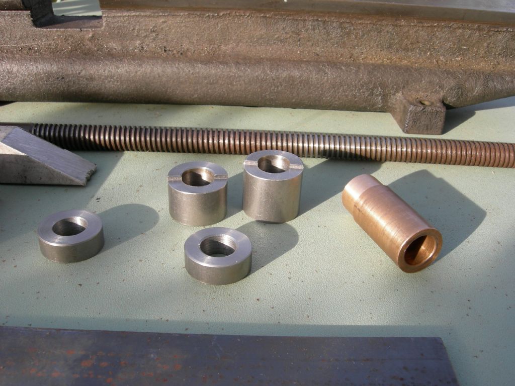

                          #99893
                          alan smith 6
                            @alansmith6
                            Hi EWers and others,
                            Don't forget to click on the sketch that I posted which will increase the size.

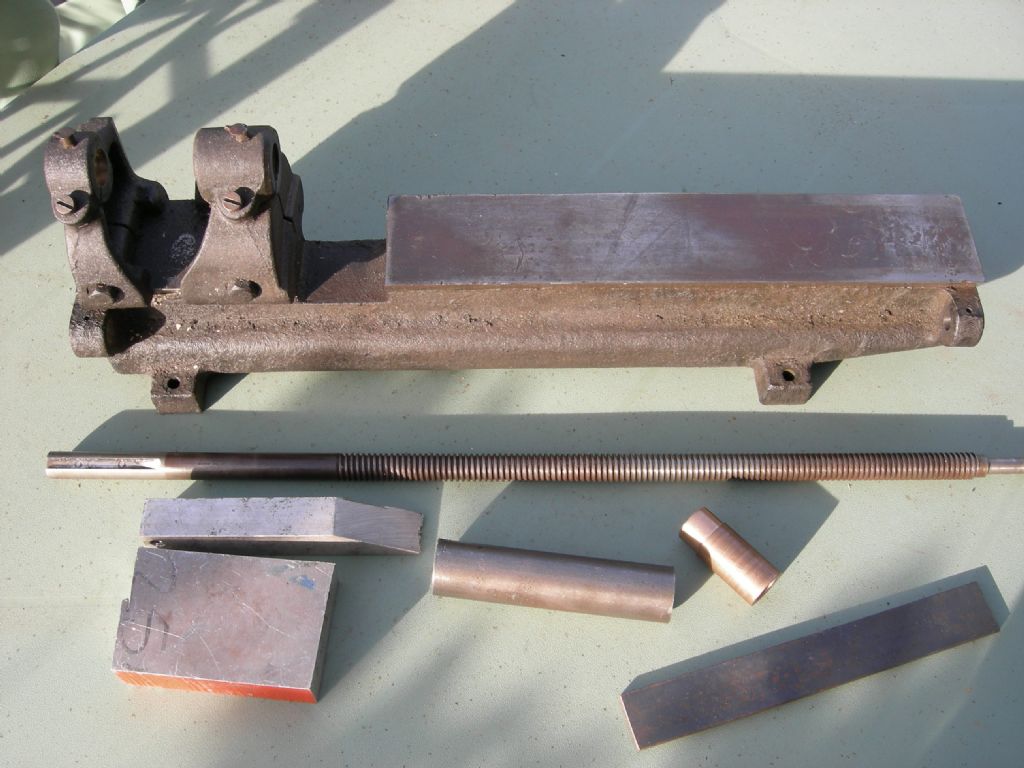

                            I encose a photo of the materials that I've collected from the scrap heap in the garage. The Aluminium is for creating a pair of 1.25" square packing blocks for placing under the lathe feet. I highly recommend this addition and they are also useful for hanging brackets from.
                            The bronze bush is from spring hanger bracket from a large vintage car and will do for the sliding sleeve.
                            The mild steel bar is a 30mm dia offcut and will serve to machine the clutch ends from. The flat bar is for the clutch operating lever.
                            Alan

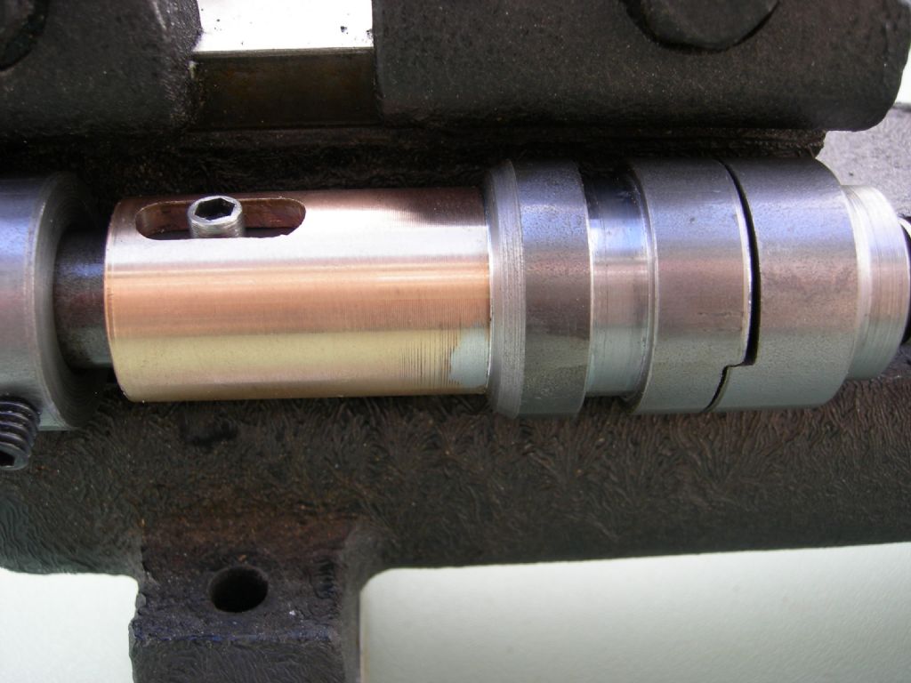

                              #100395
                              alan smith 6
                                @alansmith6
                                Hi EWers,

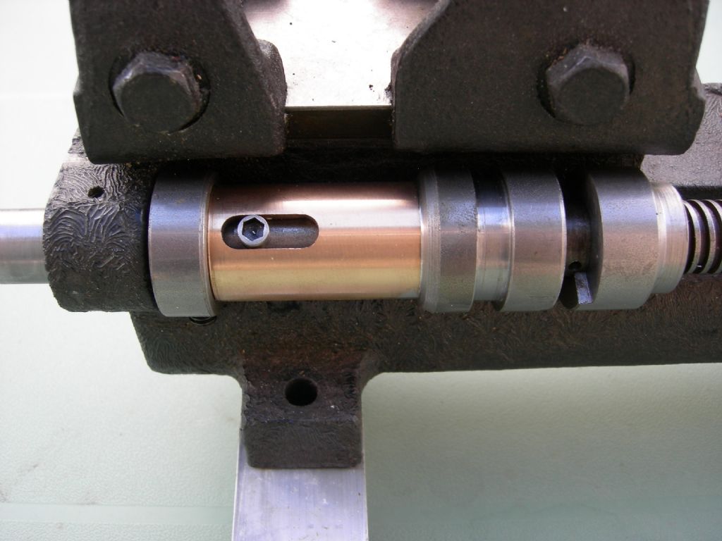

                                I'm sure that you are all gagging to see the progress on the EW leadscrew clutch, well I won't dissappoint you.
                                Here are some shots of the leadscrew clutch in situ on the EW lathedscn1477.jpgdscn1478.jpgTo be continued

                                #100451
                                alan smith 6
                                  @alansmith6

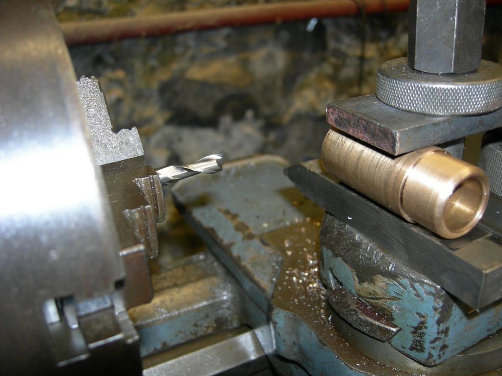

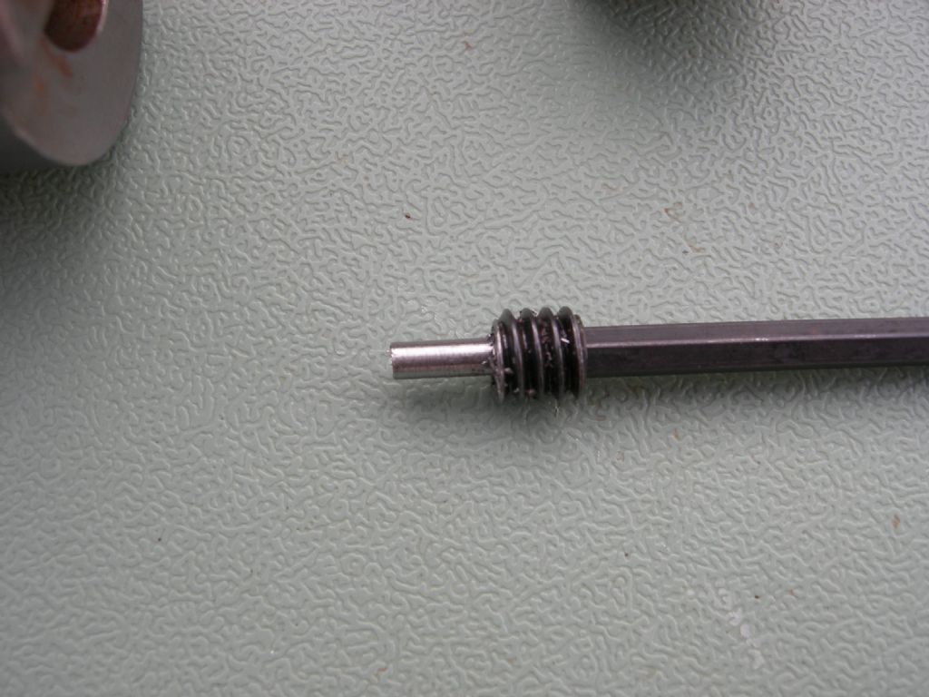

                                  Some more photos and explanations:
                                  Photo of the parts laid out
                                  The leadscrew has been cut and a brass thrust bearing has been inserted into the driven shaft. I have made this .25 long to lengthen the shaft. In the centre we can see that the bronze sliding tube has been soft soldered into the mild steel clutch driver and the finish maching carried out. On the left we can see the new thrust bearing now necessary because the leadscrew is split.
                                  Photo of the sleeve being machined.
                                  Just to prove that I did all this work on my Boxford. You can tell it was previously a school machine.
                                  Detail of the shear pin arrangement.
                                  Here you can see a close up of the shear pin arrangement. This is what holds the driven part of the clutch onto the leadscrew. I drilled the clutch and leadscrew 2.5 mm diameter ( .100" ), then opened out the hole in the clutch part to the 1/4 BSF tapping size, making sure that I had left about 30 thou of the 2.5 mm dia at the end. Then it's down to tapping the hole and machining the 2.5 mm dia on the end of the 1/4 BSF screw, make this long enough to engage with the hole in the leadscrew before the threads engage in the clutch thread. This will make this fiddly assembly easy, don't forget to drill the hole in the leadscrew all the way through so that a sheared pin can be knocked out.
                                  Alan

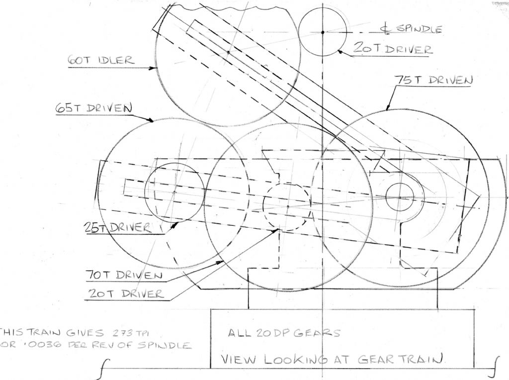

                                            We’ve covered the simple part of the EW leadscrew clutch with a 90 percent probability of success but are now are faced with the daunting task of the leadscrew drive.
                                            Martin Cleeve proposed that the drive take the form of an additional gearbox which would be placed at the headstock end of the lathe and drive the leadscrew via a limited torque coiled wire belt due to his dire warnings about possible clashes that would damage the lathe.
                                            You can see the articles part 1 in ME 2952 and part 2 in ME 2955 and I would urge you to read them as it will bring sense to the following monologue.
                                            Those of you that have faithfully followed the thread will be aware that I’m not enthusiastic about this gearbox, it may have been very useful for the MY***D lathe but on inspection does not suit the EW lathe!
                                            The only good thing that one could say about the “grandfather clock” as I call it is that Martin did not fit Westminster chimes to it. I’m tempted to make a giant winding key to fix to the box. Does anybody know whether any of these gearboxes were made for the EW? I doubt it somehow.
                                            Joking aside, I’m not sure why Martin chose to add his already successful gearbox design downsized to suit the EW. I’m surmising but there could be several reasons for this.
                                            It could be editorial pressure from the ME which caused Martin to take the easy and quick way to solve the slow feed problem by simply reducing his classic gearbox design to EW proportions.
                                            Martin ignored an easy way to solve the problem which would have taken two pages to present via the ME. The ensuing Five plus pages of copy for the reduced design gearbox would have been a better earner for him. More of this in the design notes.
                                            The other possibility is that Martin became embroiled in a “design fog” which can happen and prevents clear lateral thought once following a design direction.
                                            DESIGN THOUGHTS.
                                            In one of my postings I proposed a sort of gearbox which used timing wheels and belts between shafts on the new countershaft that I intended to build for my lathe which lacked one. The idea had me fired up for a while; I just loved the thought of those belts whirring around. This idea would have worked and was capable of flexibility in the choice of speeds. The idea was to take a drive from the rear of the headstock to a loose wheel on the lower fixed bar of the proposed new countershaft and then drive to a compound wheel free to revolve on the countershaft shaft which itself is revolving. After three compound passes between the shafts, the drive would go to a wheel attached to the 25T gear on the quadrant and then an idler and then to a 60T gear on the leadscrew.
                                            I still love the idea and I might build it for myself but after all this activity I suddenly realised that all you EWers had already built your countershafts or had an original one so that this idea became yet another stillborn one destined for the rubbish bin.
                                            In part one of Martin’s independent feed articles he discusses how he tried to create a slow feed by using the gears provided with the EW lathe. There is a question that needs to be asked, why did Mr Stringer choose 16 DP gears for such a small lathe when MY***D, Boxford and other manufacturers had embraced 20 DP gears.
                                            One answer to this problem is the method that Mr Stringer used to drive the gears, he used 1/8 dia. Pins and driving collars. Perhaps he thought that the 20 DP (the 20t one) gears were too small in diameter to use this system. I will check this out; duly checked the 20T gear has enough meat on it to take the 1/8 pin
                                            Another marketing reason why he used the 16 DP system could be that it would prevent purchasers of his lathe from using cheap second hand 20 DP gears.
                                            The problem with the EW lathe was that due to the small size, Mr Stringer only designed for a three gear set up, meaning that the drive from the spindle gear went via an idler gear to the leadscrew gear which would allow one compound gear set only. I understand his design philosophy; this set up gives a good range of modeller’s threads but no possibility of a slow feed. There have to be financial limits otherwise he would have ended up making a Boxford when he intended to manufacture a small, cheap but good lathe with its own niche in the marketplace, which I believe he did.
                                            Mr Stringer could have quite easily created a four gear system which would allow for two compound gear sets and enable a decent slow feed. Exactly as in the MY***D lathes but he didn’t.
                                            The EW lathe having the three gear system has a problem in that it has a right hand threaded leadscrew and to keep this right hand thread system entails that we create not a four but a five gear system. Of course we could always change the leadscrew to a left hand one and revert to a four gear system and make the gear quadrant more compact.
                                            I don’t think that modellers like to spend money and would probably prefer to go for the five gear system which would be much cheaper. This also has the advantage that we can have up to three compound gear sets which can potentially give us a very fine feed indeed.
                                            Martin discussed how he had tried all possibilities to create a slow feed for theEW, even going to the extent of using MY***D DP 20 gears, the 20 and 100 gears in the intermediate position which gave 129 tpi. My Boxford has a slow feed of 160 tpi which is good for me but might be too fast for others.
                                            This is the moment that I have to ask, why in the light of what he was doing in the gear quadrant area, did Martin not look further and create a five gear system which would give as what we want but instead, pushed his gearbox system onto us with all its limitations. What do you think?<

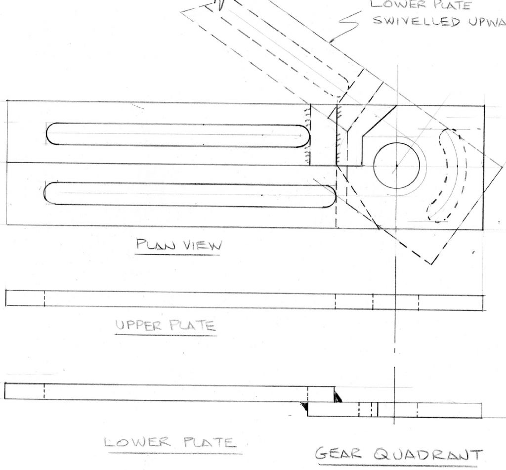

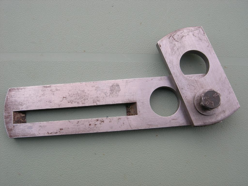

                                                    EW Gear Train continued.
                                                    The quadrant is made up from three pieces of ¼” plate which I personally will have laser cut to size by a specialist rather than hack them out from plate and it saves having to machine out the slots as well.
                                                    I had begun the design of the gear system with Martin’s words ringing in my ears where he tried using 20 DP gears combined with the 16 DP gears supplied with the lathe to create a slow feed.
                                                    Of course the three gear system defeated this attempt but then I wondered why Martin had not opted for a five gear system? Was a five gear system possible with the space available?
                                                    I started to sketch out a five gear system but the limitations of a drawing board soon became tiresome as at every attempt to draw out a viable system involved a lot of rubbing out of the last. This is an instance where CAD is very useful as changes can be quickly made.
                                                    Then came the inspiration, why not have the quadrant made from two separate arms?
                                                    EW Lathe screw cutting arm and spacer.
                                                    The clue was that the EW single arm has a spacer between it and the lathe end plate; this spacer could be replaced by another arm so that the quadrant would be variable. Of course the faces of both arms will be flush, which you can see if you look at the drawing.
                                                    Martin did not have to draw out his gear system he had the gears and the arm, so that by creating the variable quadrant all the possible gear combinations could be tried out by using the available gears with no need for drawings.
                                                    I have to admit that I’ve used Martin’s excellent book “Screw cutting in the Lathe” to recap the principles of gearing and chose one of the ratios that he proposed for slow speed feed.
                                                    Design wise, I can see that the single arms of the quadrant could be twisted by the forces on the cantilevered gears and the one bolt securing the quadrant may not be enough but there are simple solutions to this, so no worries.
                                                    So that’s it, too simple to be true.
