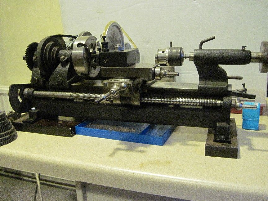

          I’ve posted some photos as promised. Please note that these pictures are ALL posed – I was starting to strip the lathe down, so I’ve just placed things in postion (mostly) to give you some idea of what the tool is capable of.
          Showing my crude (but useable countershaft and the backgear arrangement. The change wheel quadrant is not fitted. I have a full set of (steel) change wheels though. And yes, the wiring will be tidied up and everything enclosed!
          4-Jaw with economy QCTH in place – boiler fitting in progress!
          Side view of lathe – very solid cast iron construction – MT1 head and tailstock

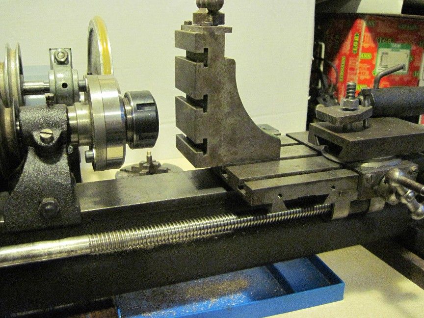

          The ER32 collett chuck works well – the diamond tool (from my Myford) is a bit big and therefore has limited travel – but is easy to sharpen and gives an excellent finish.
          Didn’t actually fit them – but you can see that the boring table and vertical slide (with the ER chuck) will provide a useful milling facility for small parts

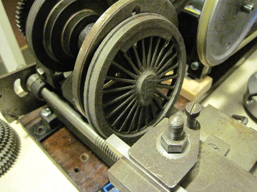

          I mentioned this in an earlier post I think – but here is the Gauge 3 ‘Sterling’ driving wheel leaning against the EW 5″ faceplate. The casting is 118mm in diameter and in backgear with a tipped tool – I think I could turn this on the EW if I had to. I’d probably use a mandrel mounted in the collet chuck though..
          So I hope this gives you some idea of what a potentially useful small machine the EW is and why I think it would be just fine for the majority of your modelling needs.

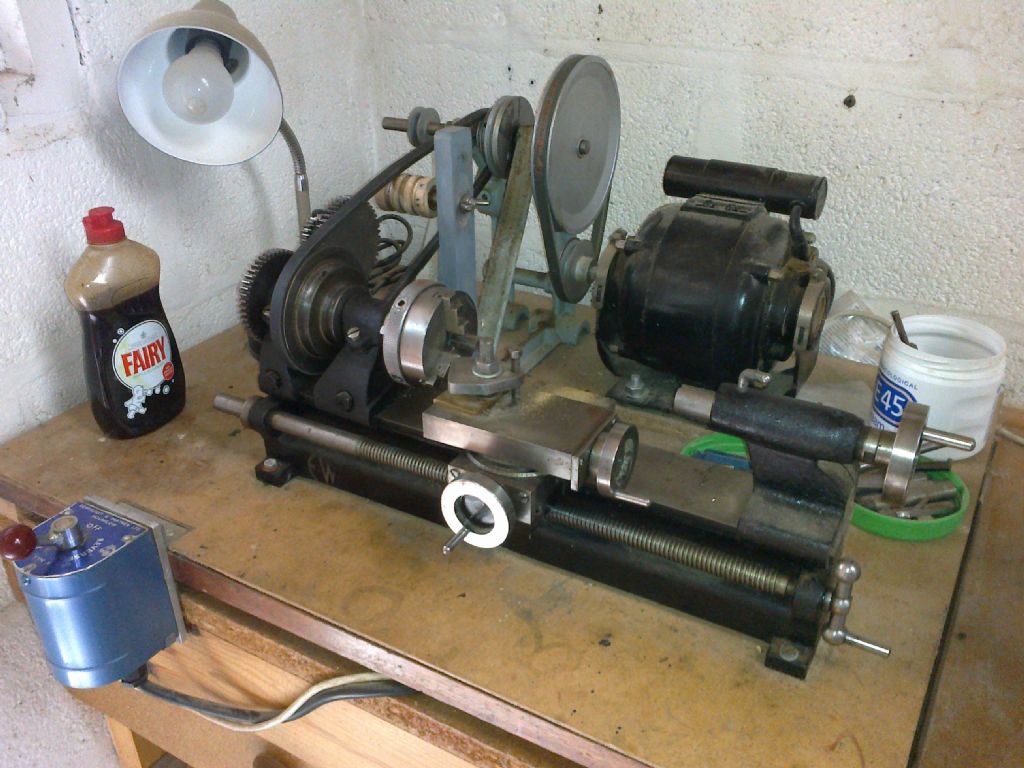

                                                      I took a couple with my mobile phone, and then clean forgot to do anything with them! But seeing the thread pop up again I remembered, so here they are:
                                                      Stringer EW
                                                      Overall view of it as it currently stands. Where did that chuck actually come from? I'm absolutely sure it's not original.

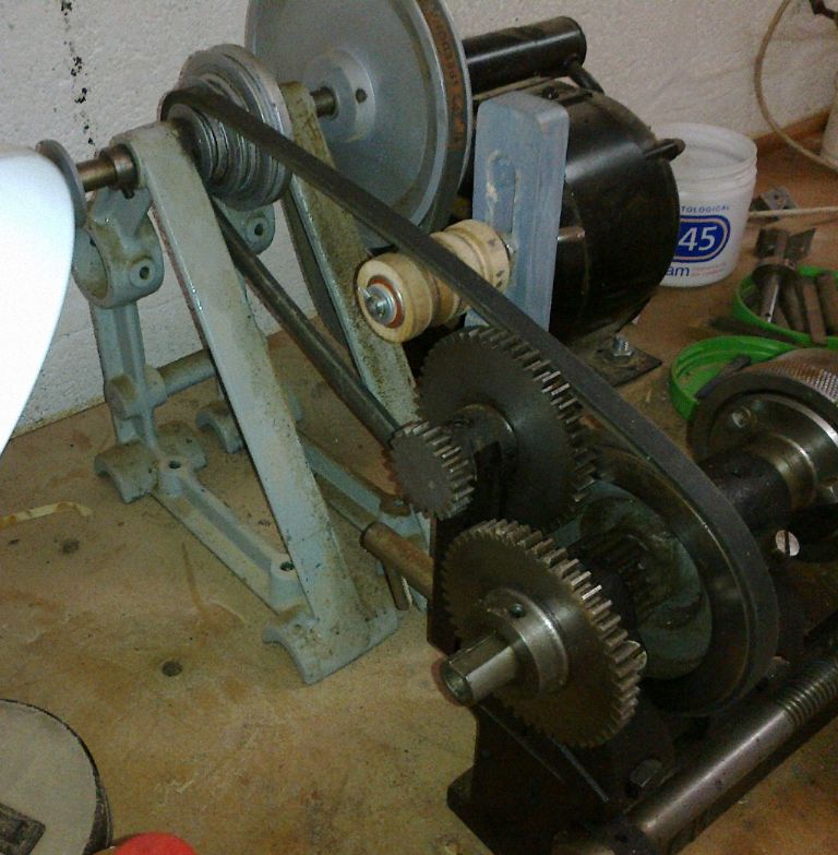

                                                      Stringer EW layshaft
                                                      'Interesting' layshaft arrangement… also not original, I'd guess.
                                                      He doesn't appear to have anything much else for it other than what you can see – so no threadcutting or anything like that, and no means of self-act either. Nice as far as it goes, but really needs some work doing to it, I'd say.
