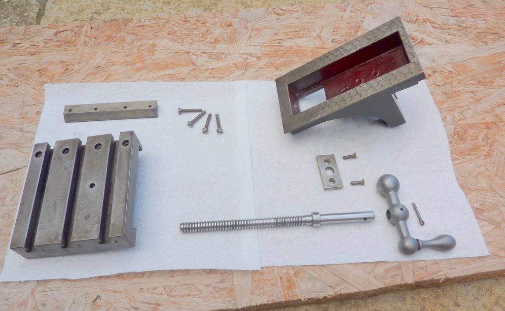

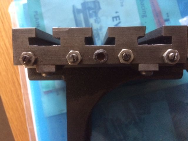

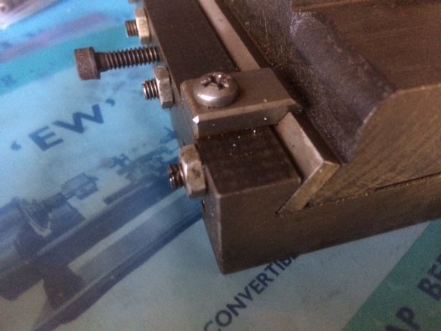

          Some photos of my vertical slide below. At the moment it is pretty unmolested with the exception of a small rebate cut out of the very bottom which allows it to clear the saddle where it sticks out in front of the cross slide on my Faircut lathe.
          As well as the extension and dial, I see some extra mounting blocks plus some modifications to the 'gib' arrangement on yours which on the original is not a gib at all but a separate dovetailed piece secured by 4 screws.
          For mine I'm planning an extension because the handle likes to foul the clamping screw on my machine vice. I may fit a dial one day too. Backlash is also an issue but it remains to be seen to what extent this is caused by wear in the feed screw or the nut. The leadscrew is longer than necessary so adding an extension will hopefully move the nut onto an unworn part. I suspect I will need to make a new nut but have not yet figured out how this is attached.

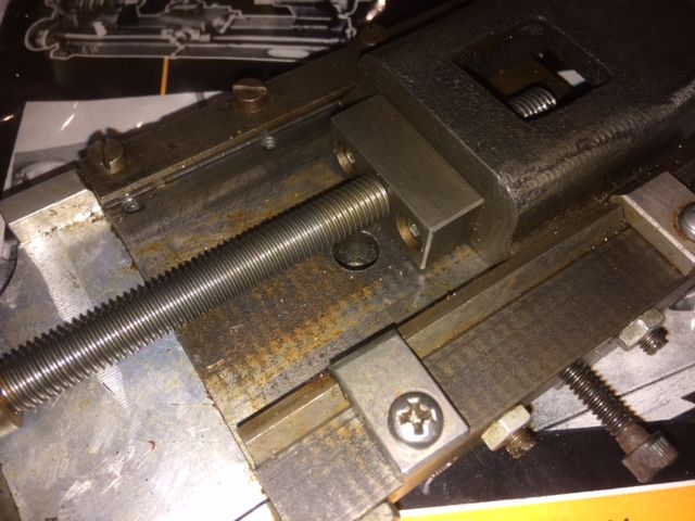

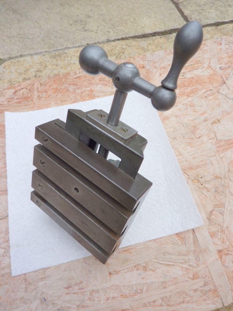

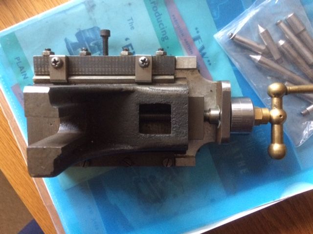

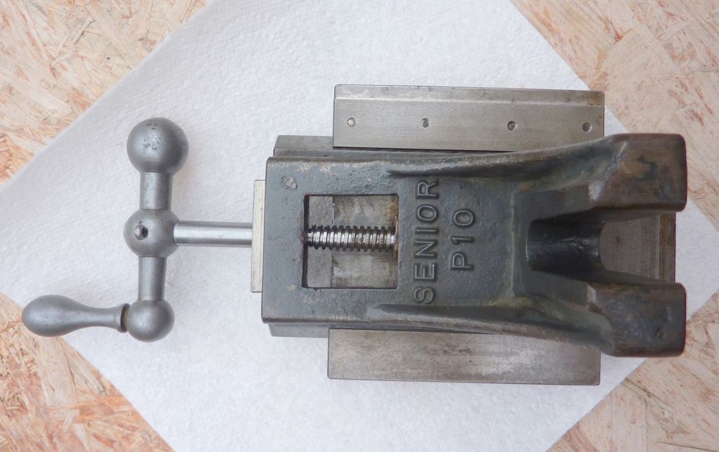

            img_1172.jpgimg_1171.jpgThanks for the advice on the tool post. It is on a single T bolt and I've been somewhat cautious tightening it because of the risk of damage to the t slots. I like the idea of a separate block and the rose blocks – I'll look them up.
            On the vertical slide, again thank you for the information. Here are some more photos – I hope they help:
            Let me know if you need any more.

                Thanks for the photos of the slide. I think the castings on yours are slightly different so probably not from the same maker but you'd have to look pretty closely to spot the differences. The basic design is pretty much identical to mine, even down to the four screws down one side of the working face and the hole in the middle for the feed screw nut fixing.
                I think I see a finer pitched, non square threaded feed screw on yours. Is that original or a modification? Did you ever take the feed screw nut off (and if so, how?).
                Regards, Andy

                  Hi – I'm pretty sure that it's been modified. The feed screw is a fine non-square thread and the nut is the block attached to the base casting – see below. There's nothing fixed to the central hole (which I didn't know was the original nut hole – interesting).
                  Stephen

                    Thanks Stephen. Sounds like it was a previous owner that did that modification… or maybe it started life as a kit of castings rather than being modified later… although if that was the case you wouldn't expect there to be an unused hole in the middle.

                      The first owner of my lathe was, I understand, a watchmaker/repairer and modified the lathe substantially. I suspect that this is another one of his, but I hadn't realised how much. Having a second almost completely unmodified version to compare it against is interesting. I ought to make a list as I strip down and clean the second lathe.

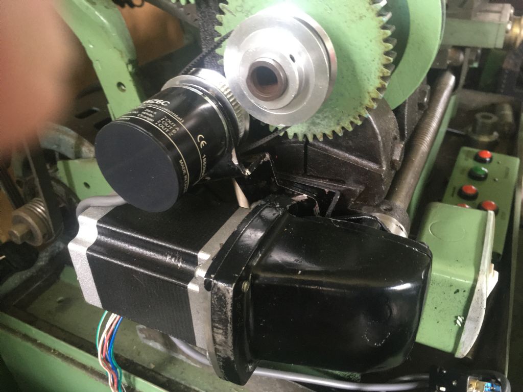

                          You mentioned in your posting the figment of an electronic leadscrew to the EW lathe.
                          I made and fitted an ELS to an old Dalton lathe. The result was all I could have wanted. The design was by Joe Noci , who was helpful in the extreme getting me through a whole, new to me , technology.
                          I have had the EW some 70 years since new. The cost of gears at the time of purchase was beyond me, lack of screw cutting capability had played on my mind over the years and with the success on the Dalton an ELS seemed the way to go.
                          I will send some photos.
                          Paul
                          #543881
                          Paul White 3
                            @paulwhite3

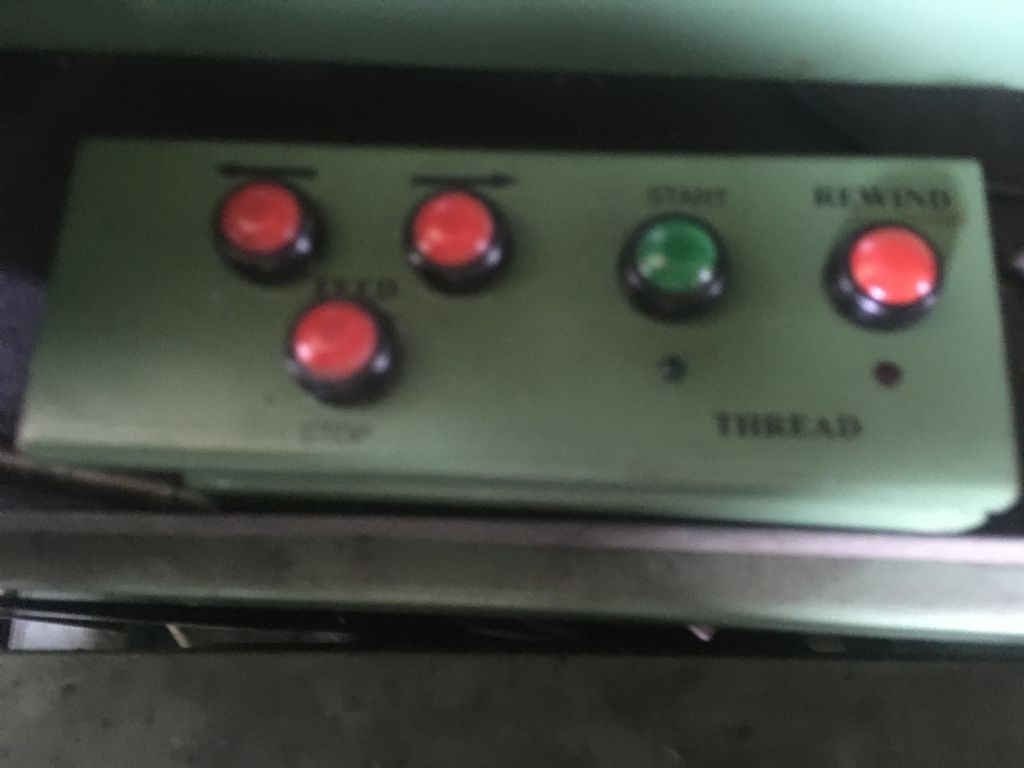

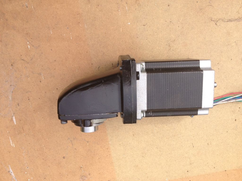

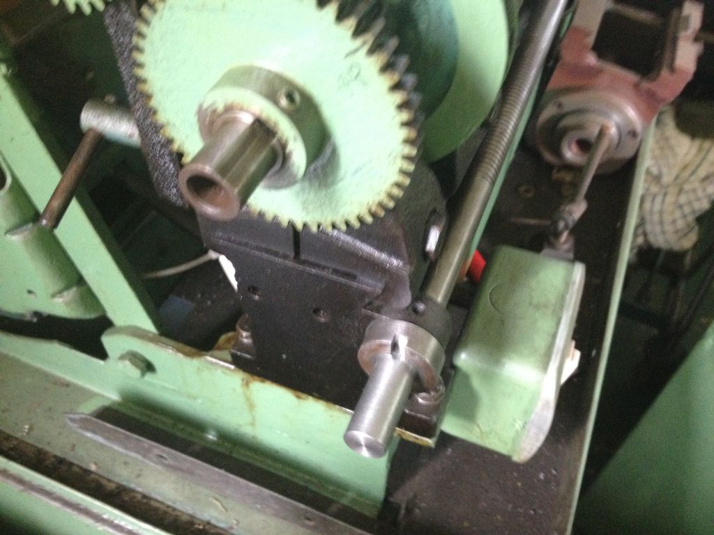

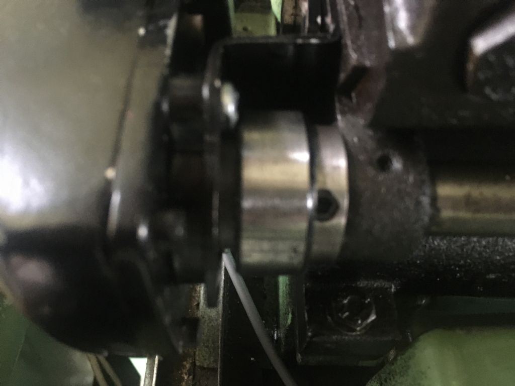

                            Photos showing arrangement of structure in fitting an ELS to the EW lathe.
                            Leadscrew end turned for connection to stepper bevel by use of a sliding single tooth clutch.
                            Stepper (nemo 23) assembled to recovered angle grinder casting into which suitable bevel gears have been fitted.
                            Stepper drive mounted and encoder with toothed belt drive from mandrel.
                            Sliding collar clutch for engagement of leadscrew to stepper drive. This arrangement keeps the carriage drive function as existing before ELS .
                            bb3c1860-e870-414b-bf50-f39e935aa3ae.jpegControl panel

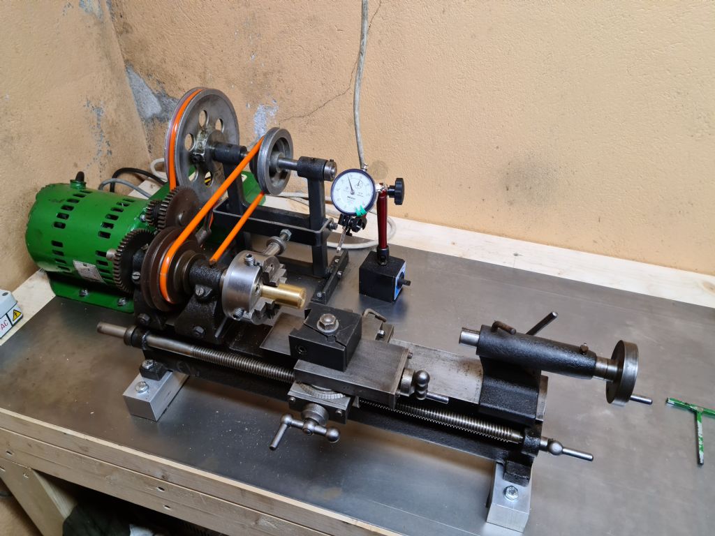

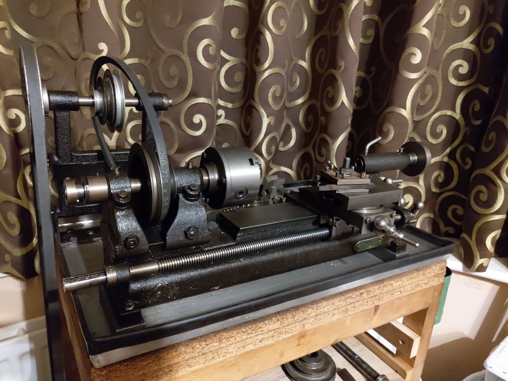

                                This is my current setup, all ready to turn a bit of brass rod. I am currently waiting on a bench grinder purchase so that I can sharpen my turning tools. The bench is a modified EAA Chapter 1000 bench with 2×6 top and a 2mm steel plate bolted between the lathe and the workbench.
                                #560560
                                Nigel Graham 2
                                  @nigelgraham2
                                  Nicely set up, Jamie.
                                  One point to note… a contributor much earlier mentioned "self-act". The facsimile literature from Tony Griffiths stresses that the EW is not intended for that in its standard form. Its change-wheels are for screw-cutting "only", and theoretically only to TPI standards.
                                  Yet it did me proud when I used it to make a special CO2 cartridge connector having a non-standard metric thread!
                                  It also came into its own even before I'd mounted it on a bench with motor etc. I needed to make a strainer from PVC pipe, by hand-drilling over 100 holes, with a battery-drill, through a guide-block clamped on the cross-slide; and indexed for both radial and length by sighting to felt-tip pen marks on a large change-wheel.
                                  Long prior to buying a similar QCTP set I made a set of tool-holders from m.s. rectangular bar, to take bits ground from broken or worn-out centre-drills and the like. Though not having the QCTP repeatability it still saves a lot of shim-shuffling at each change.
                                  No-one seems to have the change-wheel guard on theirs. Nor does mine although I have all the rest of the listed extras. It could be that few people bought them new so the ones we find never had one in the first place!
                                  Mine lives on a trolley made from angle-steel topped with a sheet of a very hard material rather like one of the Tufnol SRBP range, an off-cut from a laboratory bench at work. My 18th birthday-present and second-hand then, it too is intended as the "indoor lathe" when the nights are too dark and cold to encourage an expedition to the workshop; but the poor old thing needs some serious attention to bring it back into proper trim.
