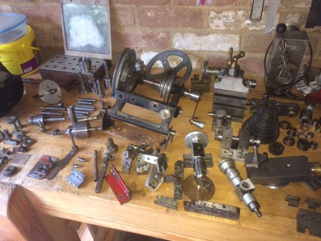

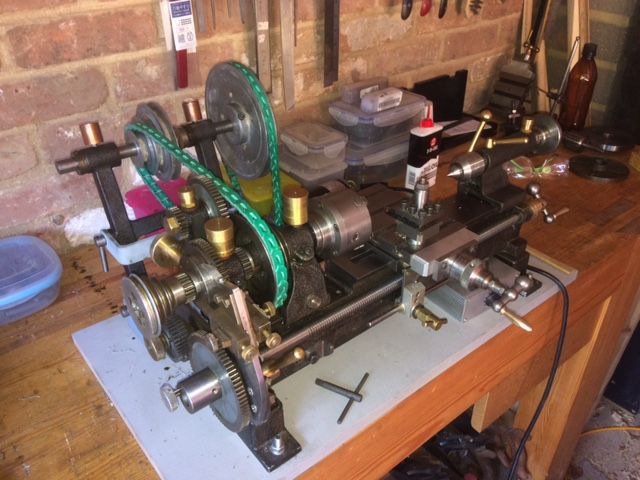

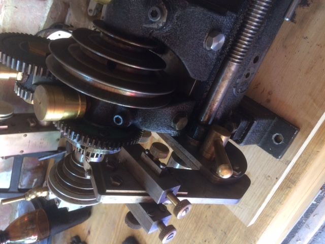

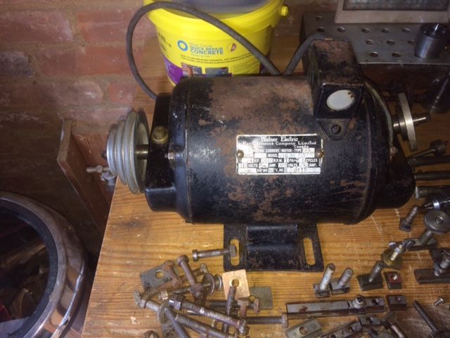

                          Hello all – I'm sorry for resurrecting an old thread. I've recently acquired an EW lathe which I hope to get up and running in the next few weeks. It's the model D version with back gear and screw cutting, and a swathe of accessories, some OEM, some homemade – 3 jaw chuck, 4 jaw chuck, vertical slide, full change gear set, OEM countershaft, etc.. It seems to be in pretty good condition, although there are a couple of issues. The bed has had a slot and hole cut in it, probably for bolting the vertical slide down as the holes seem to line up. This needs some cosmetic tidying up. Someone has taken a grinder to the 'EW' on the bed in order to mount a saddle stop and again this needs some tidying up. The OEM boring table has been converted to be the cross slide and the original cross slide to the top slide (which is now missing). The faceplate is also missing, although I've a spare backplate and so will have to make something up. The method of mounting the top slide doesn't seem to me to be ideal – two small clamps fit into the T-slots, but they are only accessible to tighten over a very limited range. I'll have to think about this, although it should only be an issue for cutting tapers. On the plus side are the various accessories, including a version of Martin Cleeve's independent saddle feed. Talking of Martin Cleeve, is the list of EW-related articles someone mentioned some while back complete? I've printed off the Exactus articles that someone posted. I'm looking forward to getting this lathe back in work again.
                          Here are some pictures:
                          EW lathe
                          EW accessories
                          EW motor
                          Stephen

                            My EW is the plain-bed version, was second-hand when my Dad bought it for my 18th birthday-present, ooh, err, last century; but I was delighted to learn many years later, from 'lathes.co', that its has all the original fittings and extras except the change-wheel guard, which the photos suggest was a casting.
                            The EW lathes were not fitted with clutches on the drives, and the lead-screw was permanently engaged for both feed and screw-cutting. NB: the change-wheel set supplied is not suitable or intended for power-feed, only screw-cutting.
                            I don't find screw-cutting to a shoulder to be too much of a problem – though I might baulk at large batches. I simply turn the machine by hand, using the big pulley on the countershaft as a (rather mucky) handle. With the motor unplugged of course! (And the motor belt loosened to reduce the effort needed.)
                            I do have a budget QCTP that just about fits but long before such things were available made a set of little tool-holders from short lengths of rectangular BMS bar, to hold tool bits ground from worn-out centre-drills and the like. The tool-holes are inclined, giving easy though limited height adjustment.
                            Watch out for the T-slots. They are thin, and one on my vertical slide, for which I made a rather crude but effective vice, came complete with a piece broken out. Rather than separate T- nuts I made T-strips to distribute the load along the slot.
                            Another point regarding the vertical slide. It is meant to fit on the boring-table, of course, but its single central bolt is not conducive to keeping square-ness of setting, nor to fair stresses on the T-slots. Not believing in modifications to the original metalwork other than for repairs, I made two L-shaped steel blocks each clamped by two T-bolts to the table, forming a 3-sided "nest" abutting against the (OEM) machined body of the slide.
                            Presently my EW is resting – a Myford ML7 does most of the work, a Harrison L5 is there for the bigger stuff; an Axminster "Micro-lathe" awaits a suitable bench.

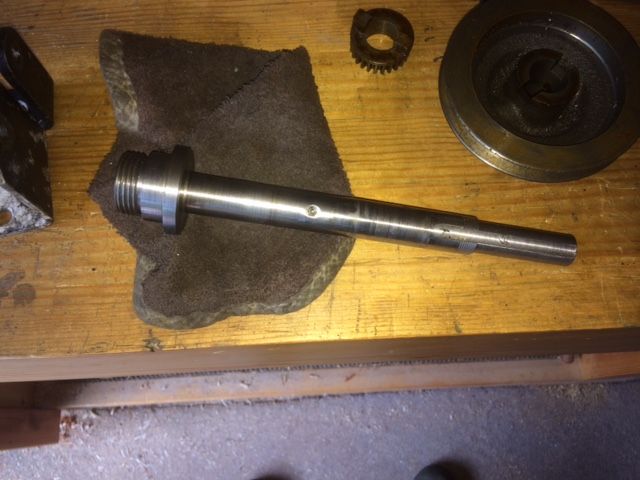

                            It is resting though because the spindle and headstock castings are worn to the extent you can see the chuck "jump" when applying a cut, and it reveals what if anything is the weak point of this otherwise fine little lathe – others might find this too.
                            The spindle runs directly in the castings; and they are not very thick-walled.
                            The "obvious" solution is to bore out the castings, turn the spindle down, and insert a thin-walled bush, split to match the original adjustment, Unfortunately there is very little metal available for removal from either without weakening the headstock or compromising the spindle's fine-pitch thread for its retaining/ adjusting nuts. I investigated commercially-made bearing-bushes, but found none thin-walled enough to use without creating serious problems.
                            I think all I can do is combine line-boring the headstocks with skimming the spindle, but removing only just enough for very thin-walled bushes turned from leaded gun-metal – that material as the spindle is not hardened. I would have to rebore and sleeve the heftier tailstock casting too, to ensure concentricity as much as to correct its own wear.
                            Thinking how to bore two castings with slots cut along them, I realised I would have to make cast-iron – or possibly aluminium – shims to fill the slots and give nearly-uninterrupted cuts.
                            The spindle's thrust-flange had also worn a recess in the headstock-face, but I made a thrust-washer with a tiny anti-rotation pin locating in the adjustment slot, to overcome that.
                            Chromed handles, as mentioned right back several pages ago? The handles on my example show no sign of ever having been plated, even allowing for years of wear. I don't deny they might have been at least on some of these lathes, though, and the 1940s-50s were a great time for finishing all sort of machines in black-crackle paint and chrome.
                            SMF
                            At least yours came with the original countershaft!
                            Pity someone thought fit to put that hole in the bed, and I wonder why whoever did it, wanted the vertical-slide in a fixed location anyway.
                            I did not know Stringer made a gap-bed version of this lathe.

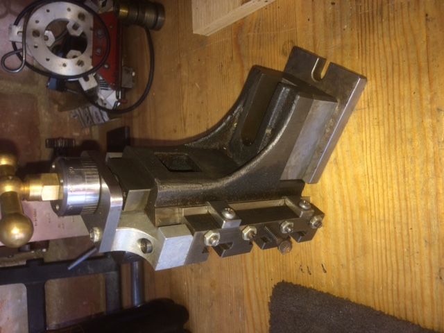

                                  SMF – that looks to be a very interesting EW, which has had a lot of modifications and changes made to it, although the slot in the bed is unfortunate. I normally use my EW with just the boring table fitted and therefore do not use the top-slide. Generally this is not a problem and helps improve rigidity. I have a small QCTP that I use occasionally but for most work I use very simple 'Rose' blocks – that hold 3/16th HSS tools at centre height. Like Nigel I often screw-cut fine (40tpi) threads and do so with a handle on the spindle.
                                  The T-slots are quite thin but a simple bolting plate helps with this and can be used to attach the vertical head for instance. This lifts the vertical head to give more movement and uses a larger bolt, which stops it twisting under load, which it will do with just a smaller bolt in a T-slot I certainly would not try using the vertical head mounted on the top-slide.

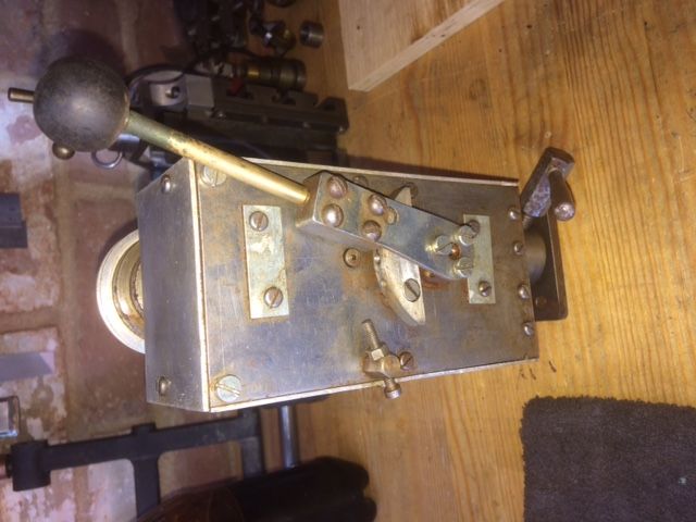

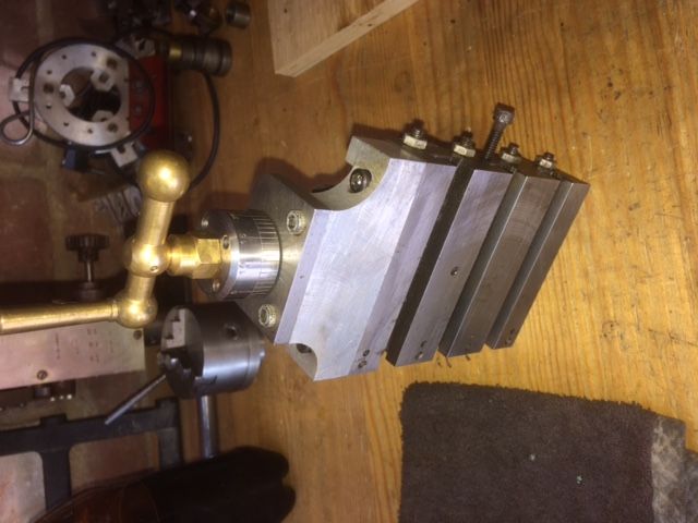

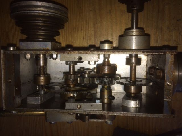

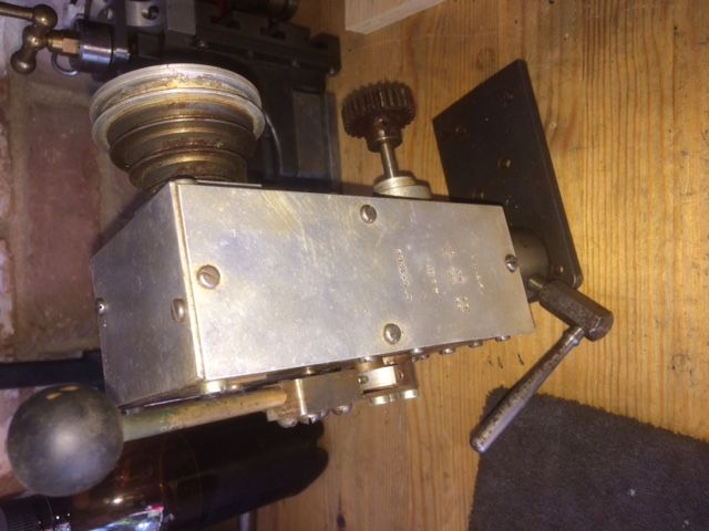

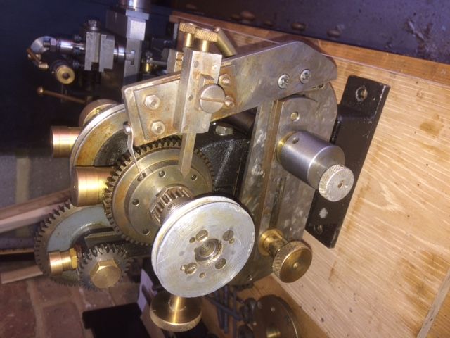

                                    All – Thanks for your replies. I'll post some more pictures, if anyone's interested, of some of the changes that have been made. I've been removing the rust on various of the accessories, and sorting bits out before I start a full strip down of the lathe itself. The slot in the bed is a bit irritating, mostly because no-one bothered to clean it up to ensure the sides were parallel, the drill/saw marks were removed, etc. Interestingly, the spindle has been replaced and the nose thread is now 1 1/8" 12tpi. I don't know if the headstock has been bored out or if this is what Martin Cleeve did with his. What I thought was a version of Martin Cleeve's fine feed gearbox, is a more complex, bespoke item made with clockwork gears offering both forward and reverse fine feed. I understand the original owner was a clock repairer. Unfortunately, the gears aren't engaging properly in one direction but restoring that is going to have to wait. I'll go and take some pictures.
                                    IanT – I'd be really grateful if you could send me the Martin Cleeve articles too please. I'll PM you.
                                    Stephen
                                    #485236
                                    smf
                                      @smf
                                      EW gear box innardsEW fine feed gear box sideEW fine feed gearboxEW vertical slide sideEW vertical slideEW cross slideEW screw cutting gearsHi – some photos:
                                      EW indexing attachment

                                          And here's the spindle – 0.751" in diameter. The headstock bearings seem to be fine.EW spindle

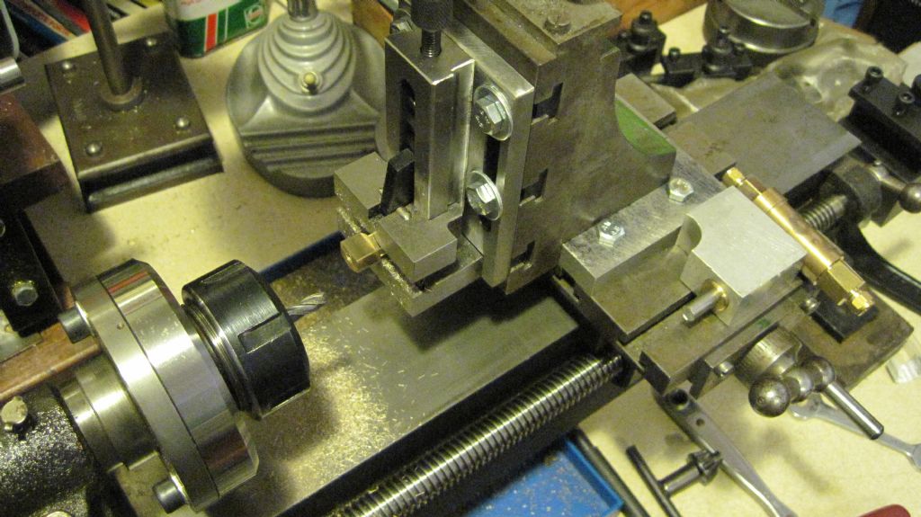

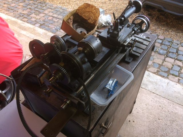

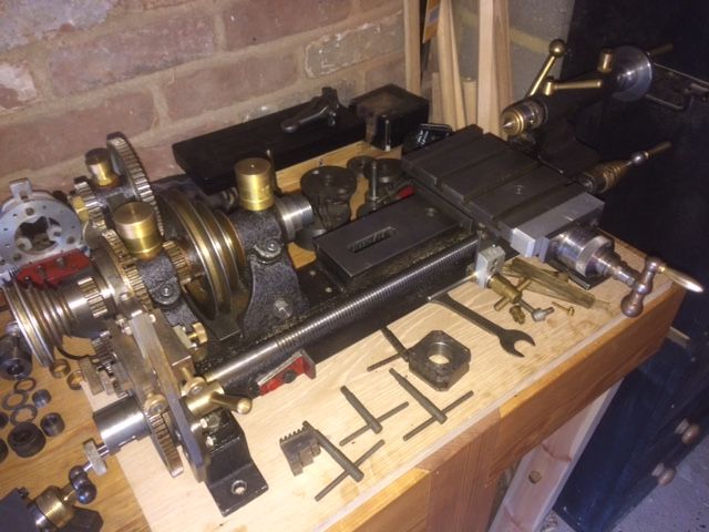

                                            As I was missing the original cross and top slide, I bought another EW lathe for spares… This one also came with the original countershaft, a full set of change gears, catch plate, change plate and boring table. Some of it doesn't look to have been used at all.
                                            EW lathe 2
                                            #491613
                                            smf
                                              @smf
                                              And my first EW lathe has been cleaned up and put to work – I'm really enjoying using it. It's so much more solid than my Simat 101. I've temporarily rigged up a 200w DC motor but plan on moving to a 3 phase motor (as I've a spare converter from my wood lathe) – any recommendations?
                                              EW lathe set up
                                              #491641
                                              Nigel Graham 2
                                                @nigelgraham2
                                                Fine work!
                                                They are good little lathes – mine needs some attention as its spindle and headstock are worn.
                                                You could try asking Newton-Tesla about a motor, but give them the specifications of the inverter you have. I have converted four of my machines to 3ph using their sets, though don't plan to do that to my EW, which has a modern 1ph motor.

                                                Andy Carlson
                                                  @andycarlson18141
                                                  Nice lathe. Always liked the look of the EW.
                                                  Your milling slide looks like my Tom Senior one, but with lots of extra bits bolted on. I have plans for some mods to mine but a lack of round tuits has held things up.
                                                  I'd be interested to know a bit more about what you've done to your milling slide.

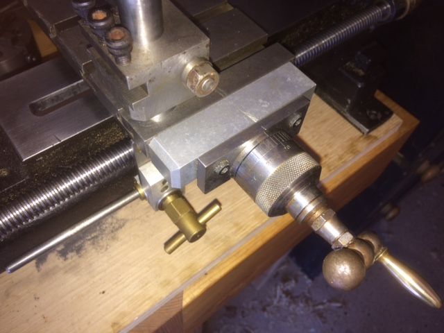

                                                    Thanks for the suggestion to contact Newton-Tesla.
                                                    The boring table and vertical slide have both had small extensions fitted and larger micrometer dials, but are otherwise standard. In the picture above, there's an adjustable height tool holder bolted to the boring table which a previous owner made. Or is there something else I'm missing?

                                                    IanT
                                                      @iant

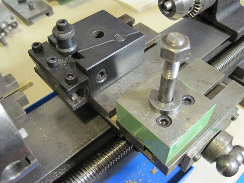

                                                      Hello SMF – an interesting EW you have there.
                                                      I looked more closely at the photo of your "adjustable height tool holder" mounted on the boring table and thought I should caution that using (what appears to be) a single through T-bolt directly into the table is not a great idea in my view.
                                                      My EW boring table is also just about permanently fitted to my EW (in preference to the cross/top slide combination) but I generally have the tool-post screwed into a separate block which is in turn attached to the table. If (when) you crank up the tool post, you cannot then damage or distort the T-slot. The block also supports the toolholder more securely at the front end (where it's needed).
                                                      The photo below shows the general idea – although I only use the QCTP for 'special' tooling these days. My normal set-up uses a similar (slightly larger) block but with simple 'Adams' toolholders for my day-to-day work (don't have a photo to hand). They hold 3/16th HSS tools and the set-up is very rigid.
                                                      Regards,
                                                      IanT
