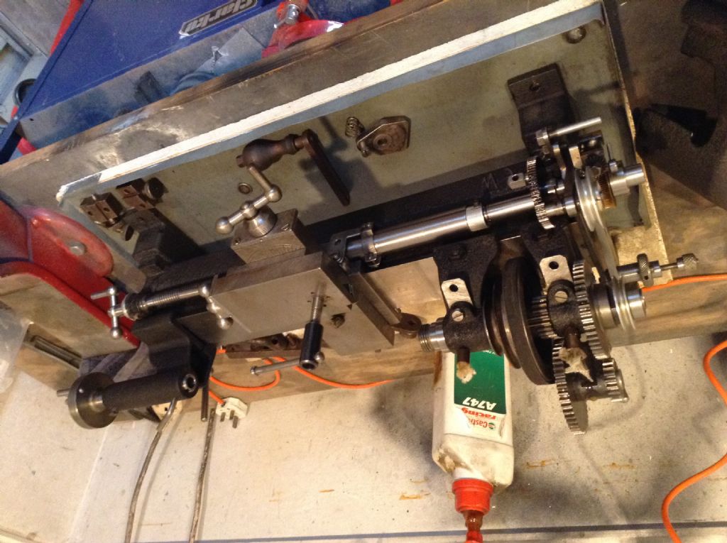

                      #295454
                      Justin Bennetts
                        @justinbennetts65988
                        Hello everybody!
                        I've just got hold of a EW lathe it's in fantastic condition the only problem is I can't find a chuck for it !
                        Any advice appreciated!
                        #295460
                        Justin Bennetts
                          #295502
                          IanT
                            @iant
                            Hallo Justin,
                            That's an interesting EW you have there – someone has made some changes to the lead screw it seems and possibly added a 'slow-drive' too….
                            Anyway – back to your question with regards to EW chucks.
                            A suitable chuck is quite easy to obtain, it's the back plate for it that's the problem in practice. I'm not near my EW at the moment and cannot remember the thread used on the EW headstock spindle off-hand but that's what you need to be able to machine or tap. So next question is did your EW lathe come with a faceplate (or any other spindle fitting – such as a drive-pin plate for between centres turning?).
                            Or maybe you have access to another lathe?
                            Regards,
                            IanT
                            P.S. Some close ups of the lead screw (perhaps in your photo album) would be appreciated…
                            Edited By IanT on 29/04/2017 16:54:02

                                  #295560
                                  Justin Bennetts
                                    IanT thank you for reply I have no idea why photos are upside down? Will pm you on Monday as I am out for the day on Sunday Regards Justin

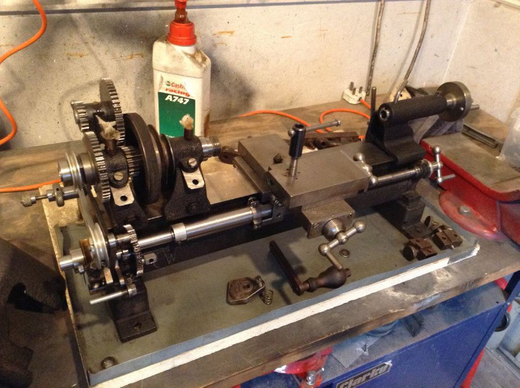

                                            #307689
                                            MichaelR
                                              @michaelr
                                              #307707
                                              Paul White 3
                                                @paulwhite3
                                                hello all.
                                                Can anybody give a purpose for the lugs an the headstock castings, front. of Justin's lathe, in 65 years of EW interest this is a first for me.
                                                Thanks.
                                                Paul
                                                #307745
                                                IanT
                                                  @iant
                                                  No, never seen this kind of headstock on an EW before Paul – and it has several other differences/modifications too. All very interesting and possibly a special model of some kind?
                                                  Regards,
                                                  IanT

                                                    #307918
                                                    Justin Bennetts
                                                      Hello Paul ' they are shims on the headstock I presume to stop you over tightening and breaking the casting
                                                      Although since taking the lathe apart for cleaning I do not seem to be able to tighten the screws up tight enough to hold them in place without the spindle locking or uncomfortably tight! I think there must be a order you tighten things up ?
                                                      Regards Justin
