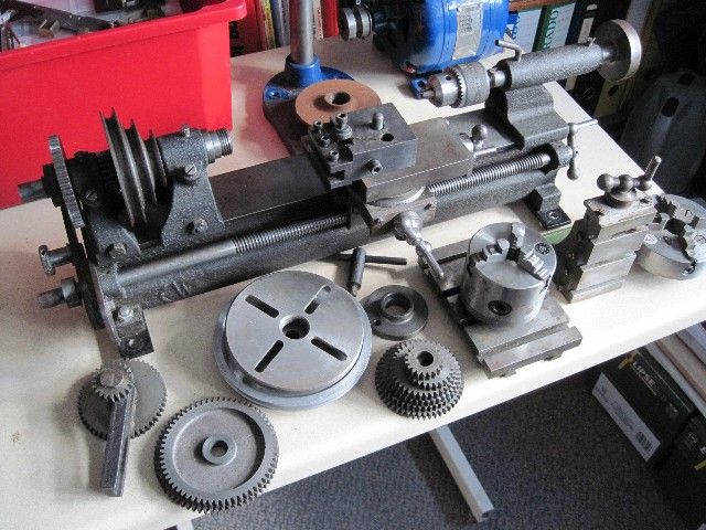

      Hi from warm sunny Dublin
      As mentioned elsewhere I’ve been turning wood since the world was still flat, but only about two years with metal – Myford Super 7 (stuck on a gearbox and taper turning attachment etc).
      Lately a buddy gave me a pressie of a Stringer EW lathe. Not actually bashed about, but lying in a workshop for millenia. Fine coating of rust and sawdust (he is also a woodturner).
      Most of the parts were in two plastic buckets!
      Since the snow has kept me from my workshop I (by prior arrangement with SWMBO) brought the poor little thing into the dining room and have started trying to bring it back to life.
      The only information I can find is on lathes.co.uk – http://www.lathes.co.uk/ew/index.html – thanks Tony!
      Have any of you good folks got one? – know anything about them – got photos ?
      Any assistance gratefully received, and progress pics can be provided if anyone is interested.

                      FWIW I’ve uploaded a few pics of mine  here
                      I’d be delighted to have a chat anytime as work progresses – I have so much to learn!!
                      A quick email to rstjmurphy@gmail.com & I can pass on my phone number – obviously not putting it up on the interwebtube
                      or we could arrange a time for a chat session on Messenger??
                      The last pic of it partly reassembled is only for my own pleasure – it still needs some work there, and also needs to be washed down and resprayed. Mulling over the idea of having the handles etc. rechromed – that will depend on cost.
                      One last thought – anyone want to buy a small island on the west coast of Europe. Cheap. One not very careful owner. Apply Dáil Éireann, Leinster House, Dublin. Tell them Ruaidhrí sent you.

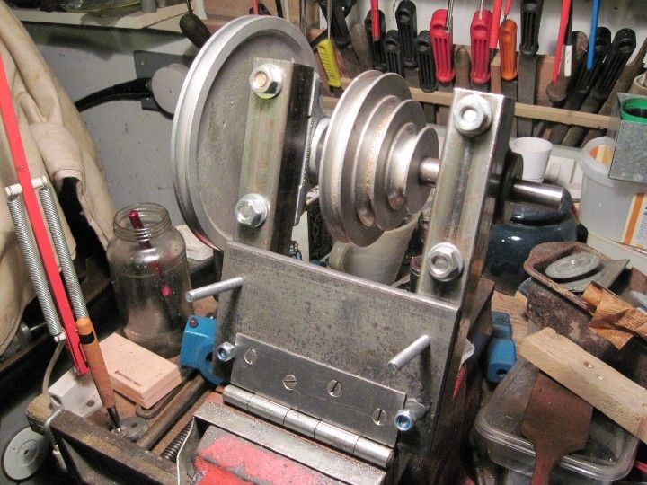

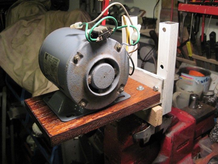

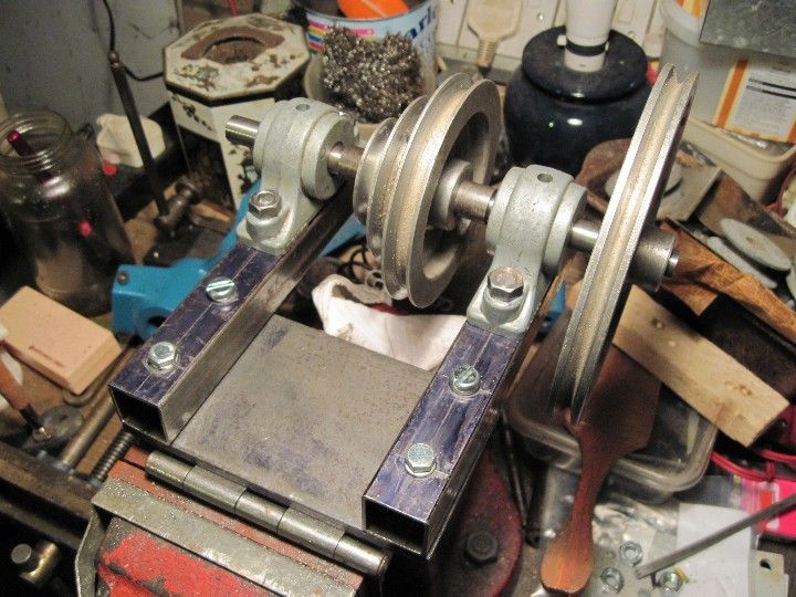

                          I’ve been working on the countershaft for my EW.
                          It came with two Picador bearings and the pulleys but nothing else. I decided to use these initially and see if they performed OK.
                          I’ve used two lengths of approx 20mm square tube as the uprights and joined them with a piece of 1/8″ plate from the scrap box. To this I’ve screwed an ordinary door hinge and above that a length of steel angle – about 40mm x 40mm. To this a pltwood ‘platform’ is bolted on to act as a motor platform.
                          The intention is that the weight of the hinged motor will tension the drive belt.
                          Going to try it later…
