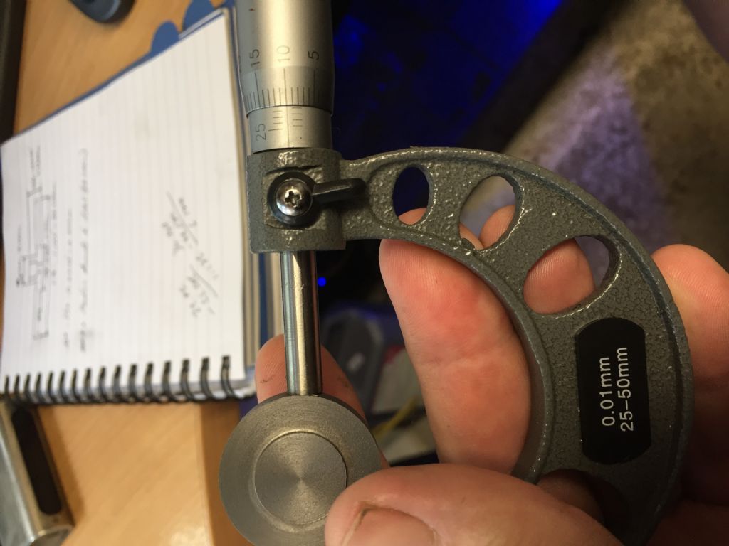

                      Thanks JasonB, good words of wisdom there, and I can see where you are coming from. I think a change of mind is actually needed. If the parts fit then its a 'Go' / 'No Go' situation.
                      I did spend some time machining last night I was working on the Cylinder covers for the Stuart S50, not a critical measurement but I wanted to see if what I seen on Stefan G's video I could put into practise.
                      I was aiming for 28.575mm (1 1/8) and I got 28.60mm I was so pleased with that.
                      (part moved slightly in picture when I took the photo so part not on centre after taking photo, measured it 10 times for consistancy just to see if i could replicate the feel of the micrometer).
                      Edited By Michael Edwards 1 on 27/05/2020 08:42:44

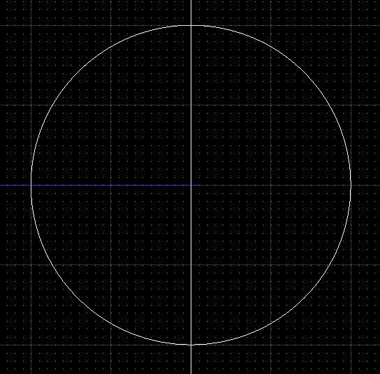

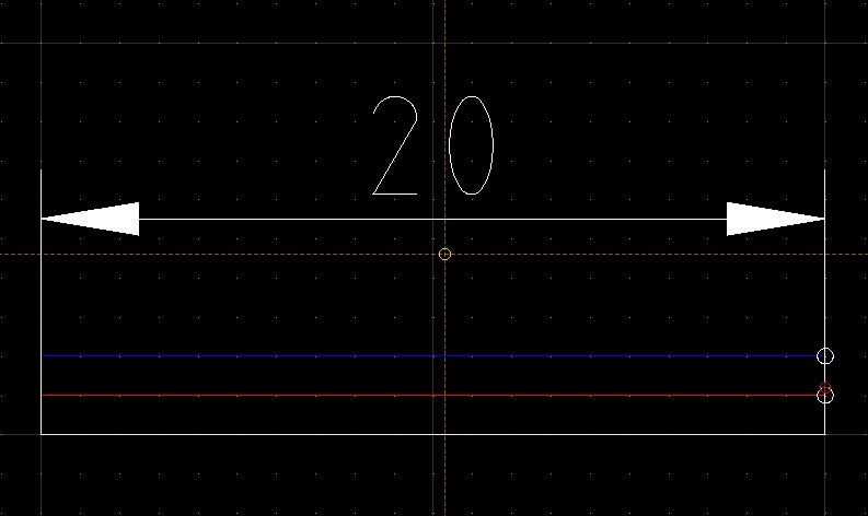

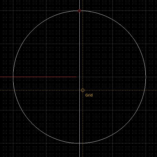

                                    Posted by Michael Edwards 1 on 27/05/2020 08:26:55:
                                    High accuracy and tolerances are needed to meet the demands of interchangeable manufacturing which is a different world from my workshop! Interchangeability has major advantages in manufacturing; spares can be exchanged without fuss, and – once set up – it's no longer necessary to employ large numbers of skilled Fitters.
                                    Making parts on the interchangeable system is difficult. It originally required specialist tool-makers working in tool-rooms equipped with high-end facilities making accurate gauges, jigs, and fixtures for use on the shop floor. The jigs, fixtures and machine settings provide most of the accuracy, not the production worker.
                                    Before the interchangeable system, a different approach was used. Typically, work was done to rather lower standards of accuracy, and parts then had to be 'fitted' together, in effect tool-room gauges are replaced by the job itself. With care, items finished this way will be every bit as good as their interchangeable equivalent. The down-side is it's uneconomic in mass production, and spare parts can't swapped without more fitting. However, 'fitting' remains the best way of making prototypes, small runs and repairs. And it can be done without high-end measuring equipment; ungraduated spring calipers can be used as comparators. For many purposes it's only necessary to establish 'Too Big', 'Too Small' and 'About Right'. In this context a micrometer becomes the slave not the master.
                                    Accurate measuring is difficult, and I suspect many claiming accuracy in home workshops are deluding themselves! It needs training, practice, controlled conditions, and careful technique. Just buying the most expensive Mitutoyo available doesn't guarantee accuracy because the operator needs to know how to use it properly.
                                    Keeping a sense of scale is difficult too. Here's a magnified 20mm line:
                                    Inside my CAD package, the line is represented as floating point coordinates with 15 to 17 digit precision. The 20mm line isn't exactly 20 units long, but it outperforms a mechanical micrometer by at least 13 digits.
                                    The blue line is 20.01mm, and the red line is 19.99 mm long. The two circles are 0.4mm diameter. Even at this magnification, about 8X on my screen, there's no obvious difference between the red, blue and white lines.
                                    Necessary to zoom in on the 0.4mm circles to see differences.
                                    The point is making parts to fit together at 0.01mm accuracy is really hard and usually unnecessary. For example, making a shaft to fit inside a 20mm bearing, the shaft only has to be small enough to fit freely in the hole, but not extravagantly loose. In practice, fits can be quite sloppy – for most purposes working to about a thou (0.0254mm) is more than good enough. There's even advantage in loose fits, chaps who make clocks often say high-accuracy working results in over-tight mechanisms – clocks and model steam engines both work better when made a bit loose.
                                    As always the validity of any forum advice depends on what you're making. I mostly make utilitarian stuff where good finish doesn't matter much and I only do high-precision when absolutely necessary. I don't make models that have to work and look good. I'm more likely to measure and compare with a DRO, Digital Caliper, spring calipers and other parts than a micrometer. My micrometer is only wonderful when it's really needed!
                                    Edited By SillyOldDuffer on 27/05/2020 10:55:54
