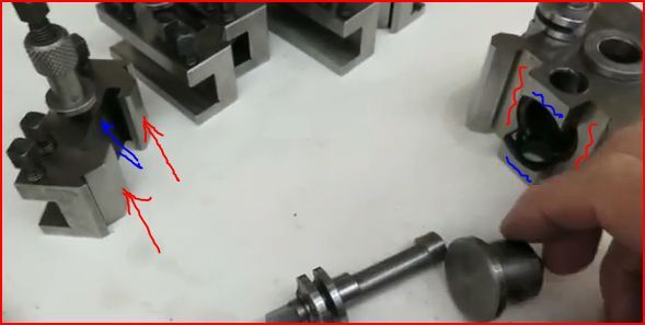

      Had a bit of a 'situation' with a part of my lathe causing me some disharmony.!
      A bit complicated to explain, so I made a video for your thoughts and opinions. Here :- **LINK**
      I made this video and this thread for no other reason than to perhaps create an interesting topic to others as my harmony is now again restored and I have ceased from my initial 'rude words'. angel
      Nick
      Edited By Nick_G on 14/07/2015 23:42:29

                  Looks like cast iron. The section above the thread looks pretty thin and must be in considerable tension when the screw is heaved tight, so a hairline crack is probably how you'd expect to see it begin to fail. It does seem rather thin there.
                  Instead of trying to weld or braze a repair which would be tricky in CI, perhaps you could bolt (multiple fasteners) a steel strip along the front with a new, deeper threaded bolt hole. You'd still be compressing the pin but with a reduced level of tension (stress) in the main body around the crack. Adding more bolts as you suggest must be a sensible route too.

                    Like Muzzer; I presume the plate material to be cast iron [and it looks to be of the appropriate quality, too] … Excellent stuff in compression, but poor in tension etc.
                    I think the most likely explanation is that the initial damage was caused either by running the top-slde into the tailstock, or [more likely] by some 'impact' event … This would initiate a crack at that weak point, although it may only have been microscopic. … The crack then gets extended by a process known as 'Stress Corrosion' [and your rattly toolpost is almost certainly the source of input energy for that].
                    Excellent news that Boxford still had a spare plate available !!
                    I wouldn't bother trying to repair the cracked plate … just use it in some configuration where it is only seeing compressive loads.

                      All of the torsion from the cutting forces is passed through to the two pins. The leverage must be enormous. If they are used for clamping the compound slide too then that will add to it. I'll bet it suffers from poor rigidity too.
                      I think the replacement plate will fail under heavy load. There is scope to improve the mechanism though.

                        Over enthusiastic tightening of the "pad" screw in the front of the plate (possibly with the aid of a hammer) would not have held the tapered spigot of the topslide with a much improved tension, it would however have easily pulled the mounting plate at that point outwards towards the front.
                        This I would suggest is the primary cause of the radial spllt in the plate to be exacerbated by the rotational forces of the cutting tool.
                        The QCTP post type previously used are fine if as Jason has pointed out, the parts are correctly made and tightened. The cam action of the cheaper copies is not always correctly set up due to sizing problems. ORIGINAL Dickson TPs did not suffer in that respect.

                            Vee screws produce a bursting effect on a threaded hole as they have a wedging effect against it so overtightening could cause this type of fracture which is one reason for vices to have a square or buttress thread. Colin

                                I would wonder if the crack was their when you bought the lathe. Putting the screw at the front like that seems to be a rather retrograde step as cutting forces will be acting directly on them. Maybe the plate can be swung round to prevent that.
                                The other reason it may crack could be down to well over tightening them. Don't know what is supplied with your lathe but mine has the hex key for them is on one end of the chuck key handle. They only need firmly nipping up as considerable force can be applied via the screw – put the 2 together, plate orientation the wrong way round and the compound slips – more tightening etc.. Crack.

                                    You guys may have raised a valid point on the over tightening front. This is I feel now possibly the cause of the fracture and the tool post was another issue all together. (although it will not have helped) The method I used was to tighten those grub screws as tight as I could. Then an extra tug just to make sure. Thinking about it once explained it was not the best thing to have been doing.
                                    Running back into the tailstock by a previous owner. I think I would probably have noticed the crack before now.
                                    I spoke to the spares guy at Boxford again today. Who in a previous conversation had told me he had been with them for 42 years. And had probably had a hand in making the machine I now own. I asked him if this plate cracking was a known issue and common. He informed me that he had been in the spares department for over 10 years and this was the first plate that he could recall selling. But he could not speak for others.

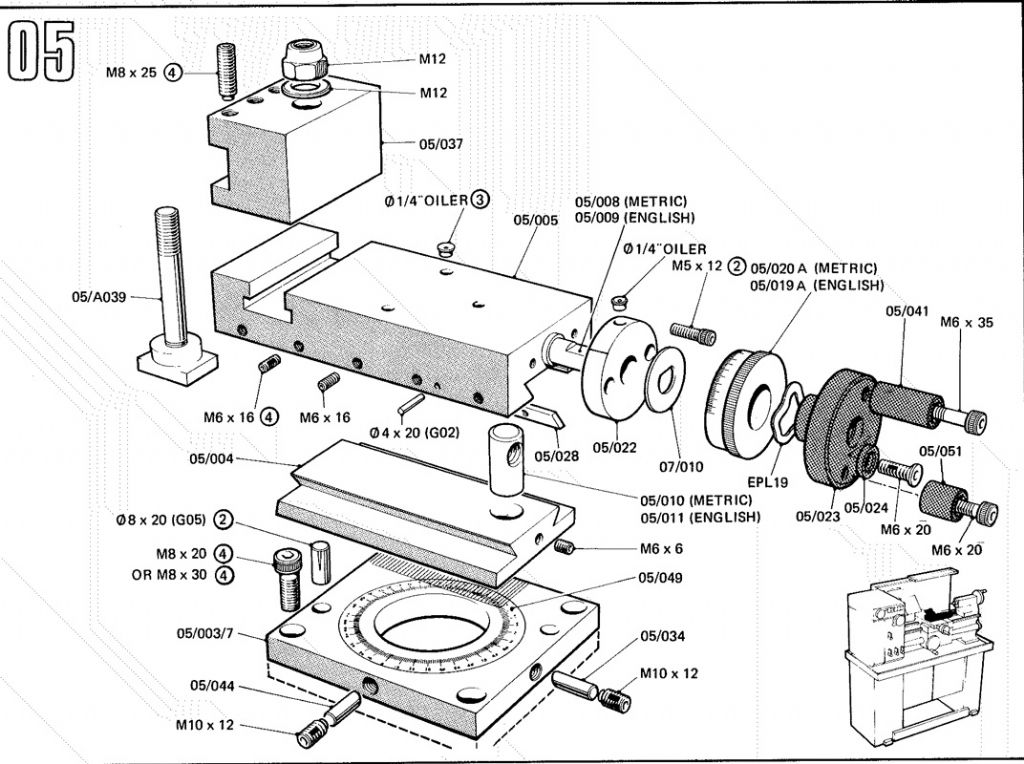

                                    For anyone that wants a view of the general construction. Here is a pic.
                                    Cheers all, Nick

                                        The failure has all the hallmarks of a fracture in cast iron, it will be present on the underside of the plate too. Good as you say your welding friend is, he will not be able to repair that satisfactorily for you, it is too thin. Others have suggested fitting a 'strongback' to clamp the crack closed.
                                        I fear that too is a futile solution as the wedging action in clamping the compound slide is very strong and it will still cause the crack to gape and eventually that action will distort the screws holding the strongback in place, leading to complete fracture on the side opposite the present crack.
                                        Now that you have a dependable spare I would be very tempted to make a faithful copy of the plate in decent steel and then use that for normal working. Your intact plate could then be moved as you suggest to the rear of the X slide for use when parting off.
                                        I am sorry to be so gloomy about the prospects for salvage, but I suspect the previous over run into the tailstock started the problem, to then be compounded by the trouble you have had in parting off with slop developing in the tool holding block. I think Jason has shown very well how that might be rectified and brought back from the scrap bin.
