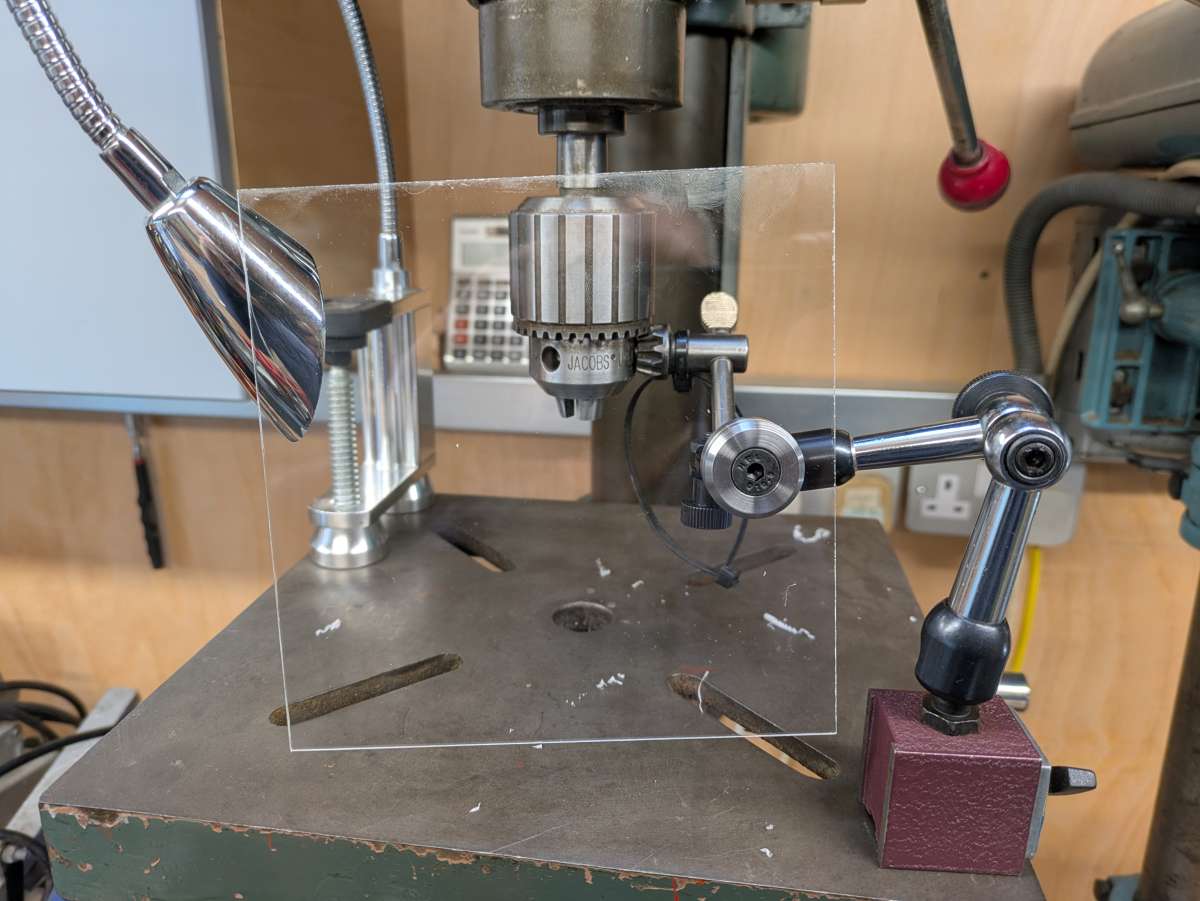

      Diogenes
        @diogenes
        A) try and cut so they get flicked towards the back
        B) even a fairly small perspex/acrylic screen on a mag-base & arm can help contain them.

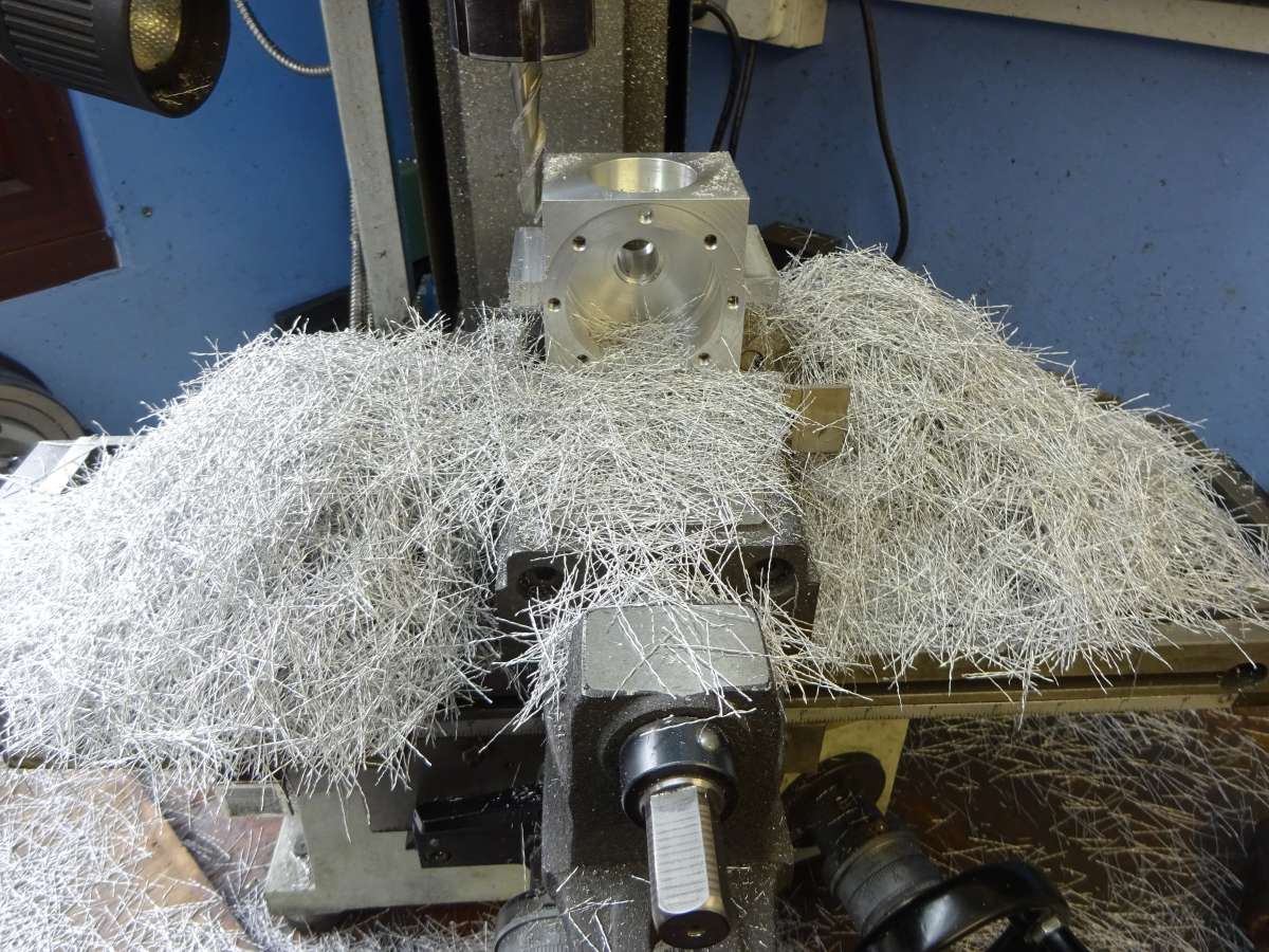

                #793993
                Emgee
                  @emgee
                  Even with full all round screens some still gets over the top as shown in the pics.
                  Emgee
                  DSCF0001DSCF0002

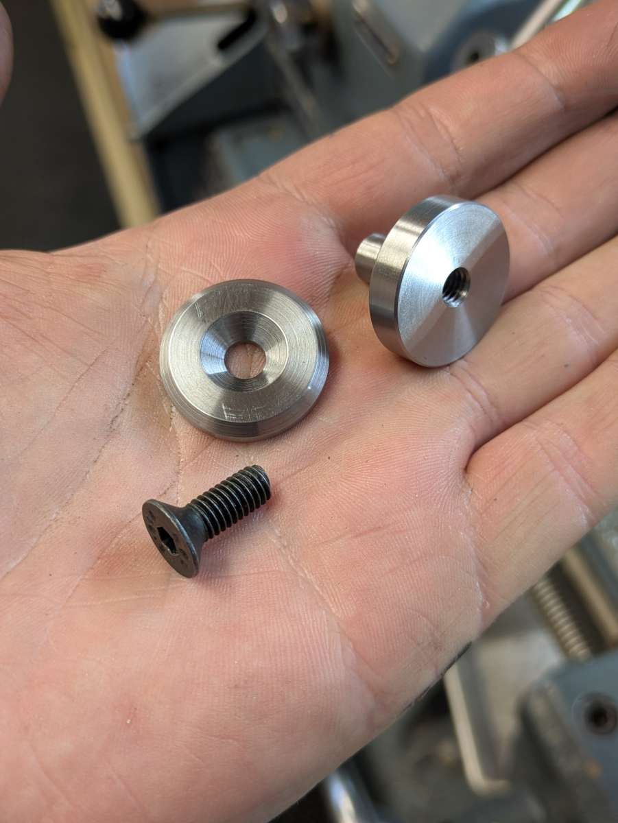

                          #794025
                          Hollowpoint
                            @hollowpoint
                            Made this the other day, for exactly the same reason.
                            PXL_20250328_150934536PXL_20250328_153233168

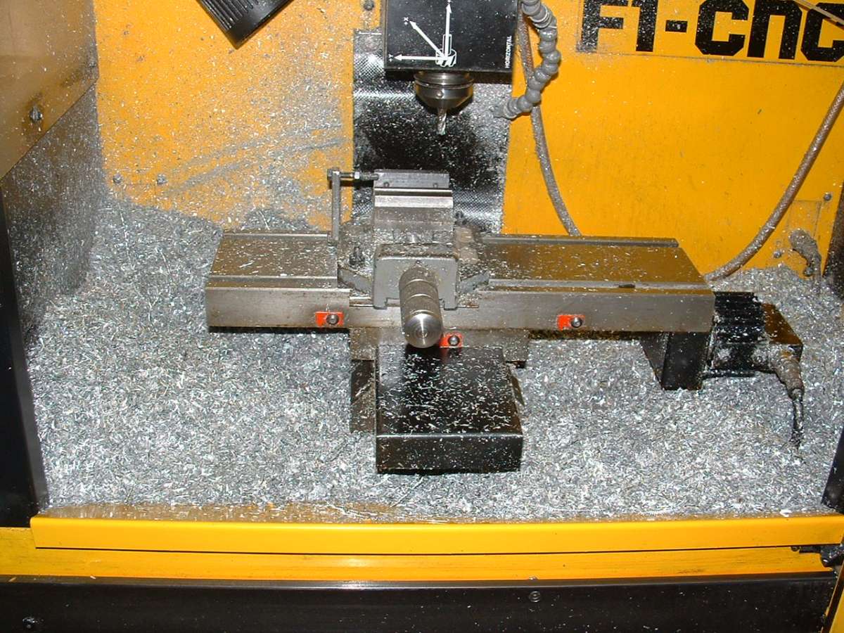

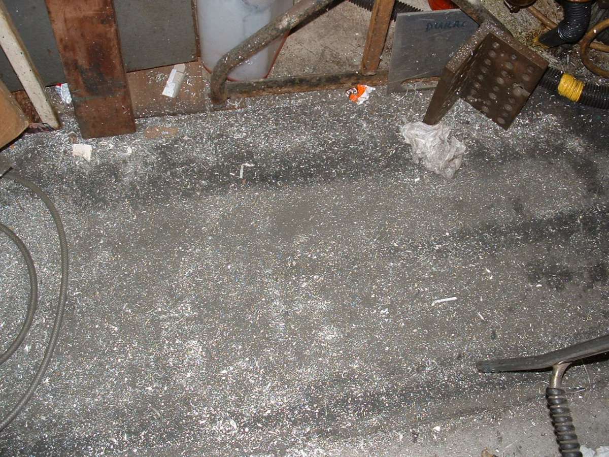

                              #794045
                                A lot depends on the type of cut, while a small vacuum nozzle, bit of perspex or even the trough that my CNC has around the table will catch what smaller cutters throw out as it does not go that far and is usually in one direction.
                                Once you start to use say a flycutter or face mill that is when you spread it further particularly if cutting in both directions where you would have to move the vac/perspex at the end of every cut. So unless you go for a full enclosure you will always be spreading it about the workshop as it will miss the vac or just bounce off the perspex.
                                Even taking a decent vertical depth of cut with the aluminium specific cutters can make a lot of swarf in a short space of time and the fact they can be run fast particularly if cabide will throw the shards around the workshop. Job like this scoop then straight up with a dustpan no need for a brush or broom when you have that amount an dtheir length can block a vac’s tube.
                                DSC01020
