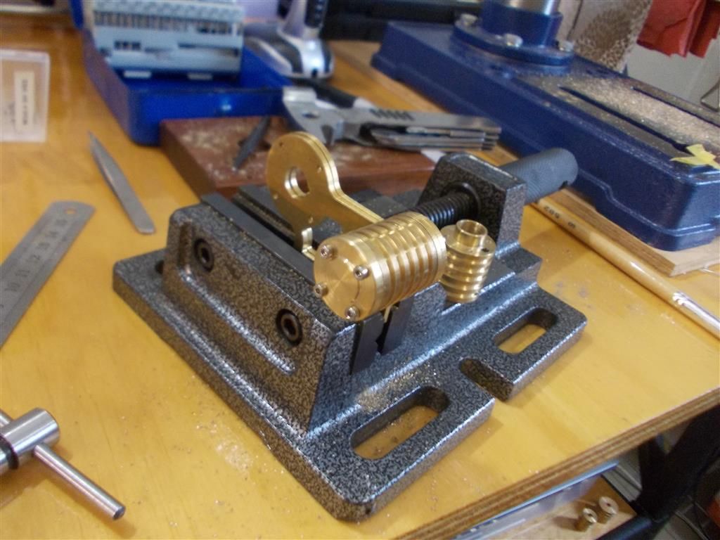

                    I have been making a few examples of part #15, the working piston which is made of gunmetal bronze. What sort of fit should I be aiming for here ? With a steam engine I would go for a tight fit that produces a popping sound when one end of the cylinder is plugged with my thumb and the piston withdrawn. But I think it may have to be a bit more of a loose fit for Stirling engines ? The pistons I have already made fall straight through the cylinder under gravity….just a small amount of resistance.
                    How essential is it to use gunmetal brass ? I think I will have to make a few more and I have no more gunmetal brass but I think ordinary brass will do.
                    At the moment I am reducing the diameter of the piston in the lathe then offering up the cylinder to get a good fit. But I think I may go back to my old method and make the piston slightly oversize in the lathe, then fit the piston rod (not made yet), put piston rod in an electric drill bit and apply 2000 grit sandpaper to the piston with one hand while the drill is held in the other hand. I know I can get a perfect fit this way and it gives me better control than using the lathe.

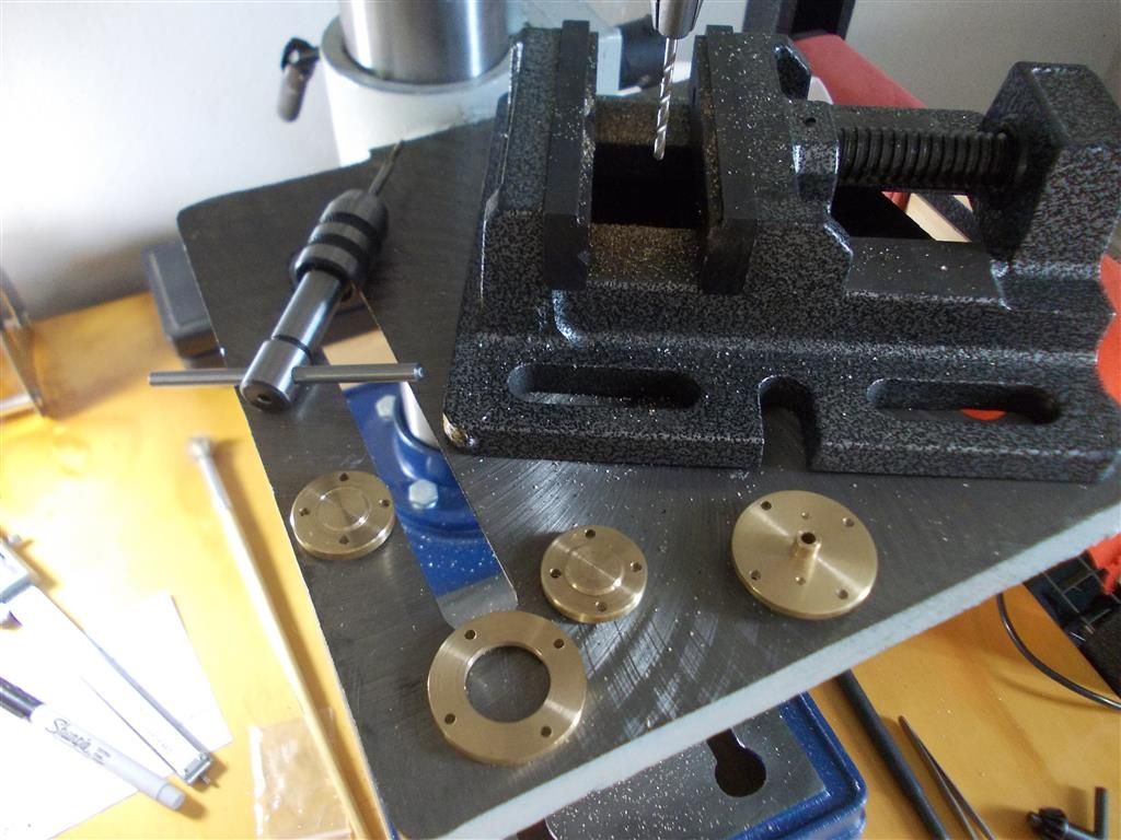

                                    Anyway, today I tried out the new drill press and my new tap wrench. The old tap wrench would not hold 2mm taps ; they kept slipping. Everything went very well as I drilled the cylinder covers and collar for the glass tube. The collar also required two M2 threads to be cut.
                                    I took the drill shield off the bench drill as I think they are a nuisance. After much thought I also removed the large safety switch cover. I had to keep lifting it up to turn the drill on and off all the time. I am in favour of large safety switches but it should be a separate item and not over the usual on/off switch. It made things more difficult to use without offering any real benefits that I could see……. comments are welcome !

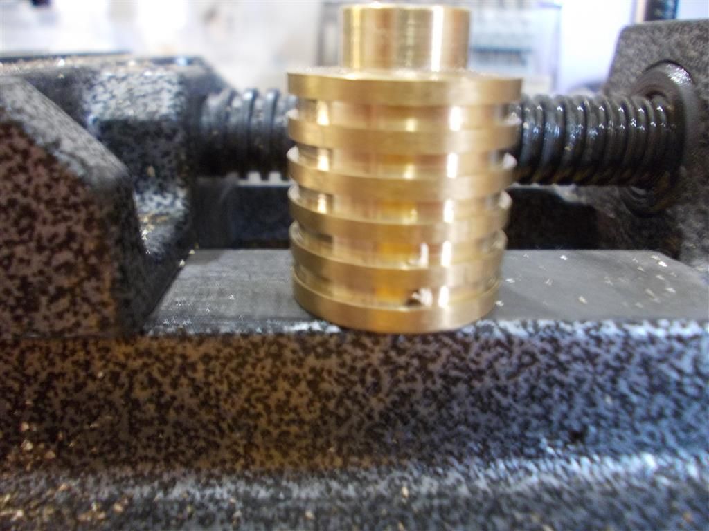

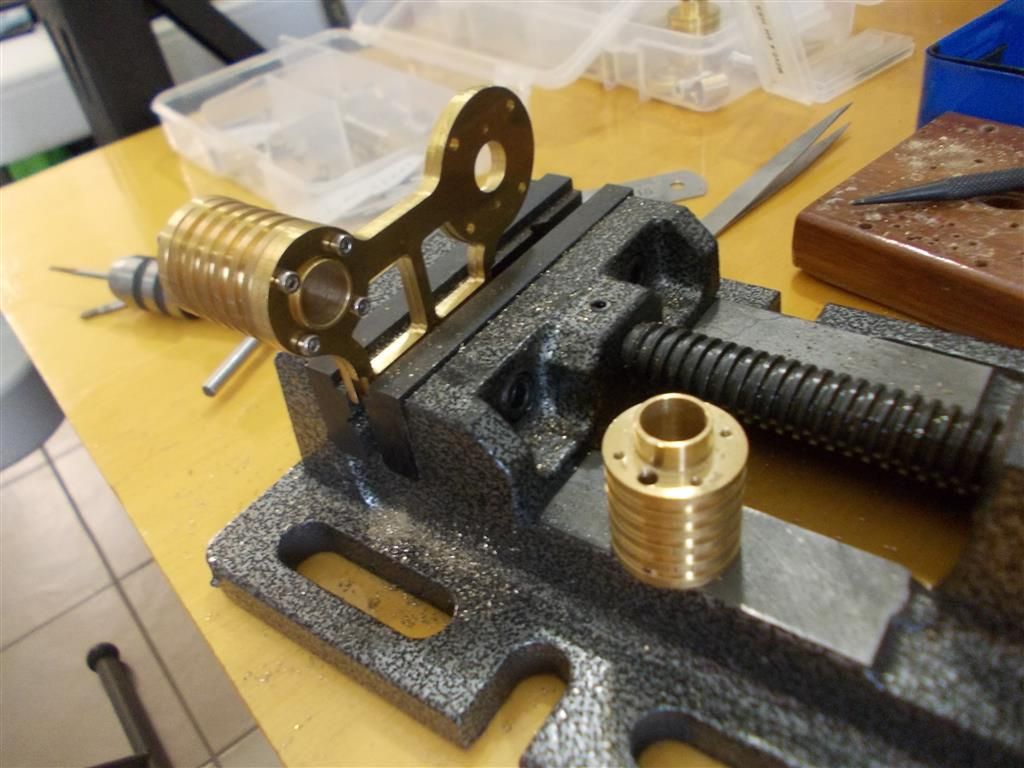

                                                I had a few problems with the drilling and tapping today. There is supposed to be a 3mm diameter hole that runs down the side of the work cylinder but due to a miscalculation I broke through the side of the cylinder. You can just see a small hole on the side at the bottom of the cylinder in photo 3. Ever the pessimist, I was prepared for a stuff up of this nature and I had another work cylinder ready to go for drilling and tapping. The completed cylinder can be seen held in the vice with the frame and cylinder cover now screwed in place.
                                                1. I am just curious if that small hole could be neatly repaired in some way or would you just ditch it ? The 3mm diameter hole is to allow heat/air to transfer between the work and displacement cylinders……….I think !
                                                2. The two frames in the vice are supposed to be sealed together prior to assembly. The instructions recommend bathroom silicon. Would gasket goo do the job ? What would you use ?
                                                3. There is no mention made of gaskets for the cylinder covers as would be required on a steam engine. Are they not necessary on a Stirling engine ?

                                                #218098
                                                Speedy Builder5
                                                  @speedybuilder5
                                                  Could you pop a bit of brass rod in the hole and use soft solder to hold it in place, or does it get too hot, otherwise use silver solder ?
                                                  #218102
                                                  pgk pgk
                                                    @pgkpgk17461
                                                    I'm guessing that if there is enough meat left round that hole you could either simply tap a shrt thread and loctite a piece of threaded brass in there or plug with an interference fit rod or if really worried about heat expansion loosening the plug then heat the cylinder before tapping in a tighter interefernce plug that has been frozen first? Or to be really lazy just mix some epoxy with brass filings as filler. I;ve used epoxy as emergency gasket goo on my rc heli exhausts and it works fine at those temps.
                                                    #218109
                                                    Kettrinboy
                                                      @kettrinboy
                                                      No need to scrap that cylinder you will be ok to either press in a small piece of brass or soft solder a piece in because if your heating the hot end with meths it wont get hot enough to melt the solder , and a brass plug will expand at the same rate as the cylinder so no worries there either , as far as gaskets go stuff like the cylinder covers as long as the machined surfaces are flat and have a good finish should be able to fit together with no gaskets and seal , on all the 6 engines i have made so far i have not needed any gaskets anywhere i have just relied on good machining to create airtight joints , for the frames a silicone gasket goo used on car/motorcycle engines might be better than bathroom sealant as they are meant to seal at higher temperatures maybe something like "Hermatite" used for sealing crankcases etc , or maybe even make a thin paper gasket.
                                                      Edited By Kettrinboy on 28/12/2015 10:02:21
